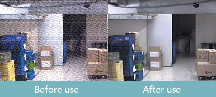

  14. It is overkill, it can cause problems like ground loops interference/noise when you hook up devices together like this and NR interfering with other NR.
    [Attachment 46118 - Click to enlarge]
    Check each one individually and avoid this excess of NR.
    Is the same if you play a Compact Cassette with NR on, then record the audio with another tape deck with NR on before feed the signal to a capture device.
    Keep it simple.
