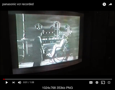

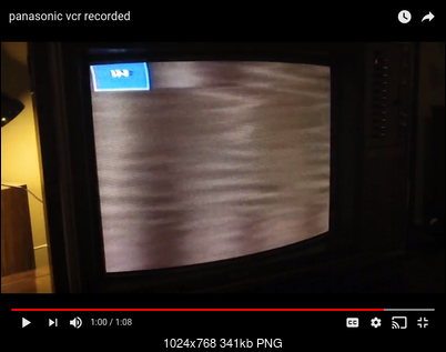

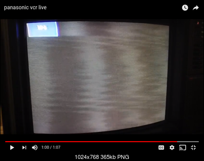

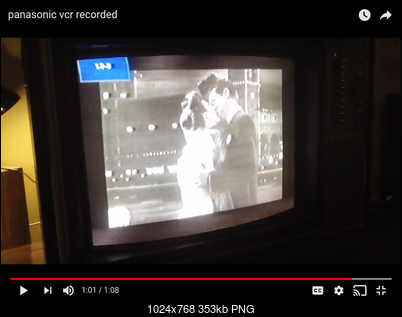

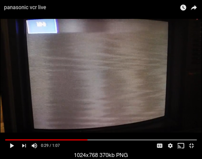

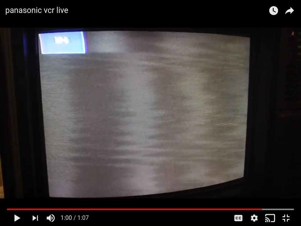

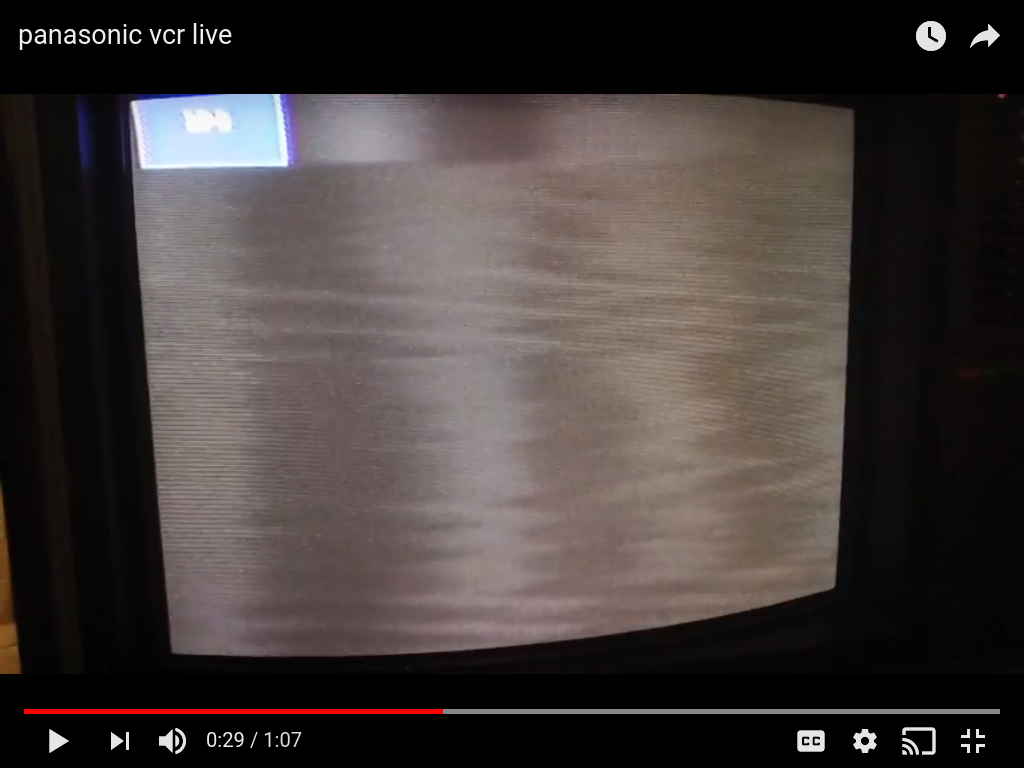

    Hi,
    I'm hoping you guys can help me out here.... I just bought an older Super VHS VCR Panasonic VCR from the late 90's... I have another one just like it (same model) but the one I got recently has some issues, was hoping you'd help identify. I have uploaded a couple of 1 minute videos, links below.. I have correctly cleaned the heads prior to use (as I do for my other VCR's), so I'm not a total newbie at this. I have hooked up the VCR with the issue identically to the other one (which works fine). The problem is as follows: (1) you'll note in the 1st video that all I'm doing is switching channels (tape is not inserted) and you'll see what looks like some kind of interference in the background (between channels). Again, I compared the same other model VCR, similarly connected and it's fine so I know it's only this one that has the problem. Every input / output causes the same problem. The 2nd video shows me playing a recorded tape (that I taped off cable) - see the same problem but seems to be more pronounced also on the black/white movie at the start, like waves of streaks.. (Again, the heads were manually cleaned very well using paper strips and 99% alcohol until no dark oxide was present...). This problem occurs when watching TV through the VCR and also when something is taped. So I see this as NOT a recording problem but something else but as you can see is significant. Pre-recorded cassettes seem to play fine though.
    Another problem is that whenever a tape is inserted and is otherwise playing or FF or REW, an onscreen prompt displays "no cassette - please insert a cassette" (even if cassette is playing etc..). It doesn't seem to affect the playback or anything but why is it showing up? Are those two things related to some kind of electronic problem?
    Here are the videos, thanks for viewing:
    https://youtu.be/kp-yNOjsDOo
    https://youtu.be/LHKSyBb2Yks
    Any idea of what this could be?
    Thanks again.

    No problem with tapes from other machines, so your heads and transport are not involved. The bug appears to be in the input circuitry. If you wiggle the input cable where it's connected, does the noise change or go away? Look at the circuit boards and check for loose connectors and loose/broken wires. Look for capacitors with open tops or discoloration on/around them. Ensure the screws holding circuit boards in place are snug (but don't overtighten them). Beyond these measures, you really need a service manual and test equipment to track down a failing part or incorrect voltage.
    Other issue is failure of the cassette-in detector. Something is not seating or switching or the electronic path from that part has a failure. Usually this is a mechanical problem.

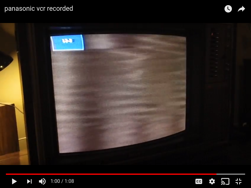

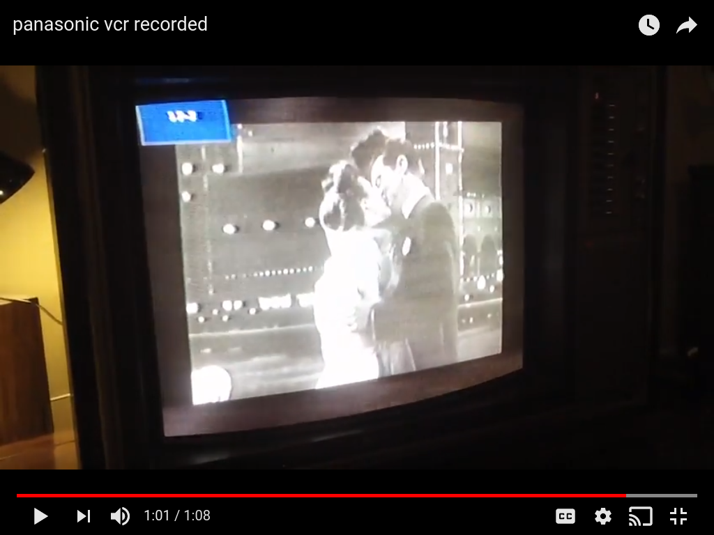

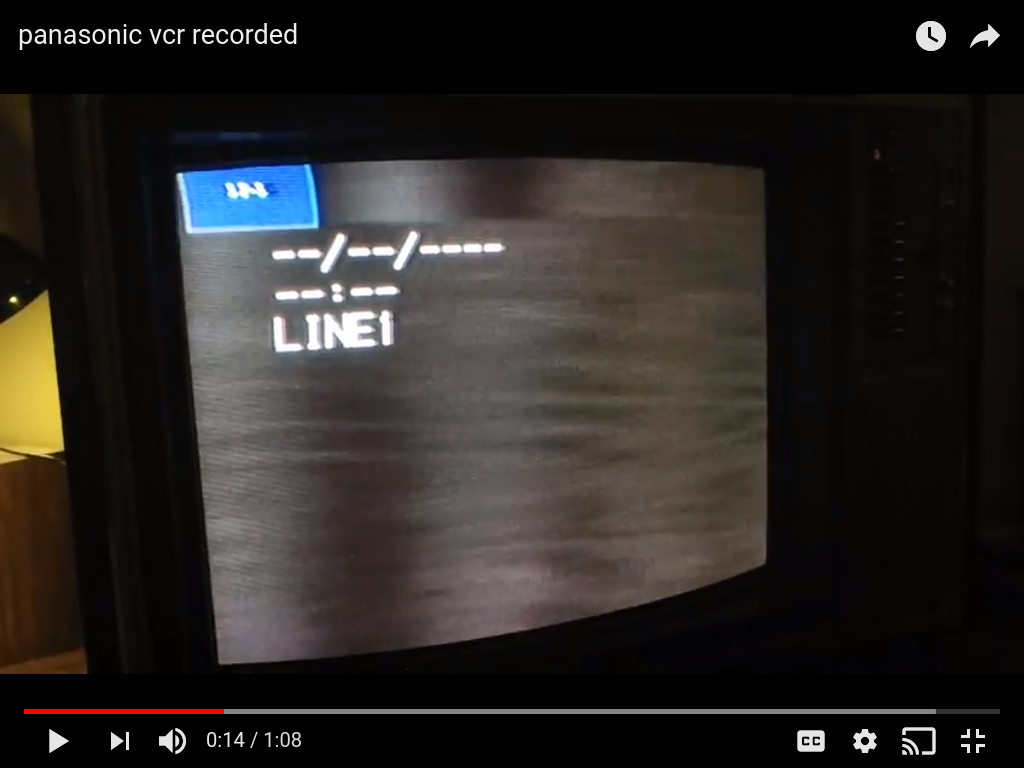

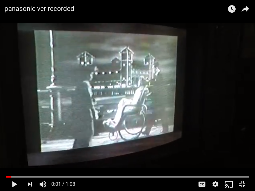

    So that there's no misunderstanding of the issue, here's some screen capture images of the problem.

  7. I don't know how this devices are hooked up, from where you're getting the signal from? RF? Composite? (Yellow RCA connector)
    In general, this is caused by a high frequency interference resonating at the video frequency.
    The interference has no chroma, so it's around the luma range around the 4.5 Mhz bandwidth. This is not a easy fix, you have to separate the device in different modules and check every single one of then. Like the power supply area, the RF area, the heads signal amplification area and the video out area. In between this, you have a heavy noise generator, the drum and capstan motor.
    To avoid the noise and interference to infect other areas the engineers use LC filters to shunt or block these out, you see a lot of LC filter in the RF area and a mix of them around the board, is very rare to see any issues with inductors but is pretty common to see electrolytic capacitors to dry out, this components have a life span around 10 years, after that is hard to tell how long it will last. For a device from the 90's, you need a full recap, that means to change all the electrolytic capacitors, decontaminate the board with a Isopropyl alcohol bath before installing new ones.
    Another important thing to care about and many doesn't, any equipment that has a switched-mode power supply (SMPS) requires low ESR electrolytic capacitors at the power supply it self and along the power lines, all the rest can be standard ones.
    Last but not least, ALL decoupling capacitor's around the integrated circuits has to be checked, if this capacitor is a electrolytic one it must be a low ESR type. This has to be done because a decoupling capacitor suppress high-frequency noise in power supply signals and we are dealing with a high-frequency interference. Another thing that less experience technicians don't know, ceramic capacitors around this area has to be tested because ceramic capacitors loose capacitance over time.[1]
    There's no need to change every single ceramic capacitors on the board, just the ones doing decoupling or around circuits related with the issue, if necessary.
    Again, this is not a easy fix but it's a pretty common issue with devices of this age.

  9. I don't think his analysis is the correct diagnosis for the visual disturbances you have posted. Decoupling capacitors are there to make sure that voltage spikes don't cause the logic in digital circuits to glitch. They are really, really tiny and are designed to filter out very tiny, very high frequency glitches. Their actual capacitance value is extraordinarily small. I don't see how failure of these bypass capacitors could cause the interference patterns you are seeing.
    I am not aware of any wholesale problem with these caps, unlike the famous debacle with the huge lot of bad electrolytic capacitors in the late 80s and early 90s that affected millions of consumer electronic products.
    As I said in my earlier post, I have the same interference patterns with my Panasonic PV-S4990 VCR (which I still have and it still works, sort of). I did re-cap the switchmode power supply (with low ESR caps), and it didn't help at all. As I also posted above, this didn't surprise me because when the caps in a switchmode power supply go bad, it won't start up at all, or the voltages coming out of it go out of regulation.
    I think there may be a simpler explanation, but the answer will have to come from someone who has actually been a service tech and who has worked on Panasonic equipment.
    The answer is out there somewhere ...

    Like I said, it's a problem in the input circuitry, perhaps an amplifier. Looks like a part has failed or a connection is broken. You need the service manual and a scope to track it down.

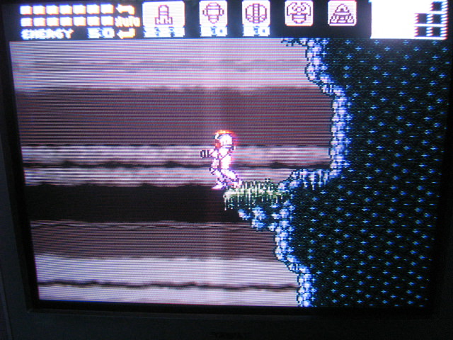

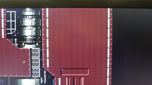

  12. As stated before, this is a well known issue, the thickness of this bars and interference is subjective, it dependes on many things but the issue is the same.
    And only a few of us knows how to deal with it, example:
    http://etim.net.au/av-driver/pcebars/
    Again, this is not a easy fix, the person that will deal with it need the knowledge, he/she need to know how to work around this with a oscilloscope and other tools. Without the knowledge, even with the right tools, the technician will never see or understand what is wrong and why it happens. It can be the Input, Output, pre-amplifier, the signal amplifiers, signal buffer, can't tell. Is impossible to pinpoint a place and tell "it's here", it can be anywhere, of course there are the "usual suspects" but the person that will deal with it, will have to track it down and figure it out where is the source that is causing this.
  13. If the posted example are not enough, have another one.
    This was caused by a bad decoupling ceramic capacitor.
    https://youtu.be/8TnScaNWo0M?t=35s
  14. The "jail bar" noise in that video looks completely different from the artifact posted by the OP.
    Interesting write-up, though.
  15. The root cause of that vertical interference is the same, it doesn't need to have the same look.
