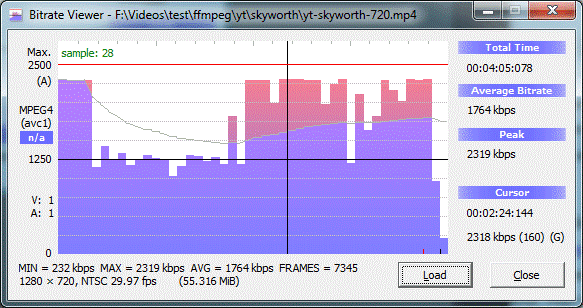

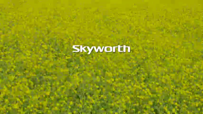

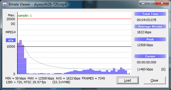

  13. Well.
    We did some research last year because we've built our own (small) tube system that can be found at https://www.team-andro.com/tube
    Video conversion has been my part. Of course I've looked deeper at what the big players are doing and at Youtube I've stumbled over some things. One of those has been the buffering.
    Have a look at following video and look a bit closer to the 17 seconds at the beginning:
    https://www.youtube.com/watch?v=5idr7K4Wwhg
    This is one frame of the 480p Youtube x264 version:
    [Attachment 45933 - Click to enlarge]
    If you encode the same video at 480p with x264 crf 26 you'll get nearly the same average bitrate. But that specific frame looks very different:
    [Attachment 45934 - Click to enlarge]
    Why does this happen? It's caused by the buffering! You can see what happens if you analyze the Youtube video with the help of the tool "Bitrate viewer". Here are the findings for the 720p version:
    [Attachment 45935 - Click to enlarge]
    The graphic is GOP based. I.e.: You see how much bitrate is spent within intervals of about 5 seconds each. Obviously there's a limit around 2400 kbit that cannot be exceeded within 5 seconds. But during the first 17 seconds some more bitrate would surely look better.
    Now let's have a look at bitrate distribution of the x264 crf 26 encode (it's GOP based with an interval of around 5 seconds, too):
    [Attachment 45936 - Click to enlarge]
    You can see that bitrate distribution is completely different here. You have a very high peak at the beginning reflecting the complexity of that first scene.
    And that's what I mean if I say that an "aggressive buffering" strategy can waste quality.
