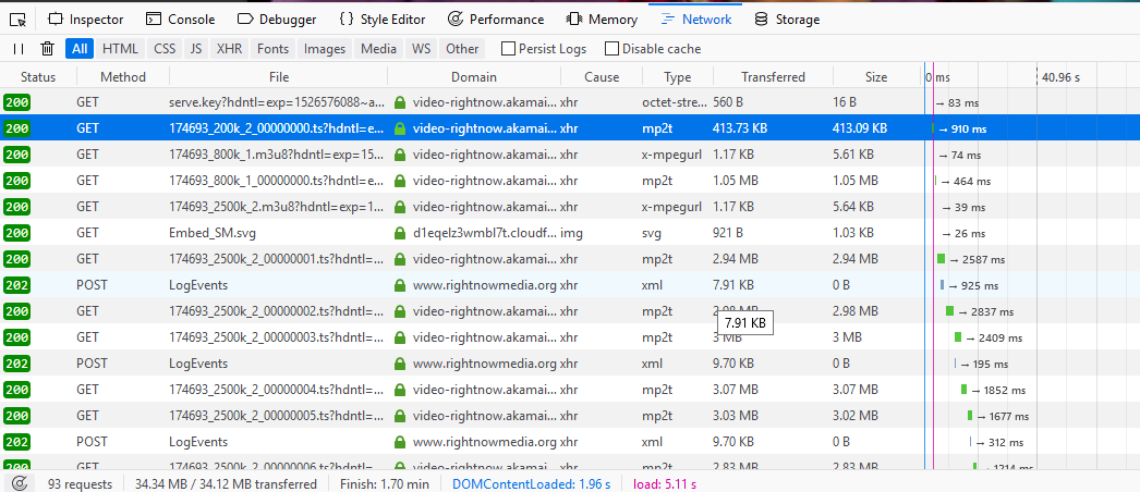

[Attachment 45657 - Click to enlarge]
So from which one of those should I grab the url? -
