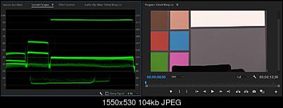

  8. Here is what I presume are ringing artifacts. They make little difference to the picture quality but all of the excursions above digital 246 would cause it to fail Q.C.
    This is straight out of the camcorder. The blacks would have to be pulled up to >= 16.
    Unsharp with a negative value tames those excursions but also sucks the detail out of the picture.
    http://www.chrisnology.info/videos/NormalScope.jpg

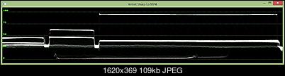

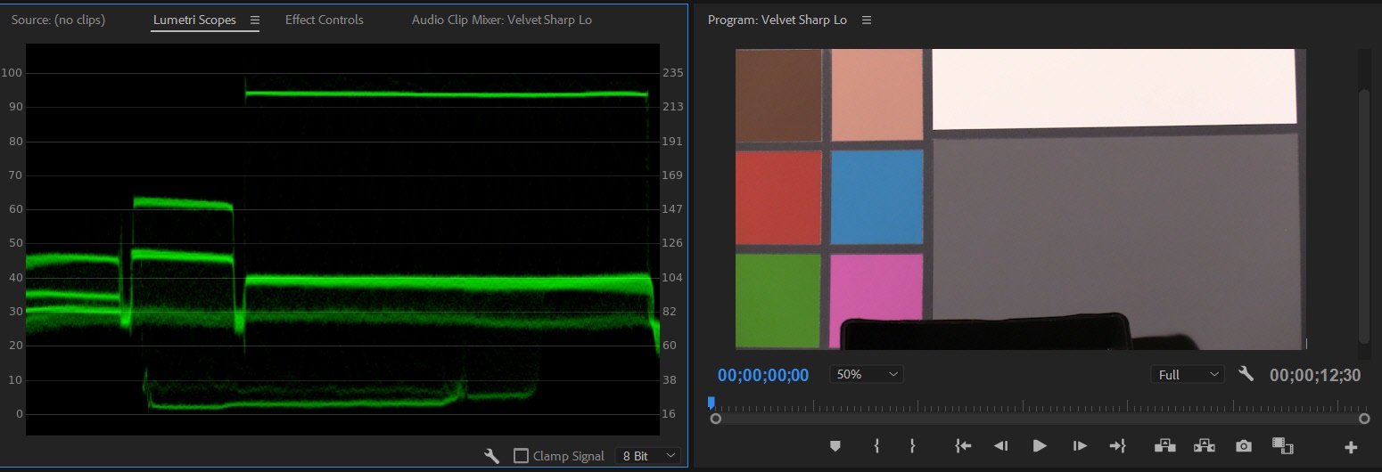

    I think there still is a problem with your scope reading, or maybe you didn't update it yet. That "white" patch is clearly below Y=235 (it's around Y=223 with a YUV picker), but is ~IRE100 in your screenshot
Name:	ffplay_Velvet Sharp Lo.jpg
Name:	premiere_Velvet Sharp Lo.jpg
    But in an analyzer, there are a few stray pixels with a max of 242 in some frames. So in the more general case - you have to decide what is important "signal" and what is "noise"

    The second screenshot is from Premiere Pro. I mentioned a broadcast NLE earlier. It's also labelled in the name. (BTW, BBC has transitioned to using this for their main editing tool) .
    Several other tools are Vegas pro, After Effects, VideoQC , I have access to several more tools too, including hardware scopes. Open source/free tools agree here too (vapoursynth, avisynth). But there is no reason to check after a few, because they all agree
    That's how I know. They all say the same thing. I've dealt with video for a long time. I've done this many times before. This isn't my first rodeo. So I'm 100% certain.

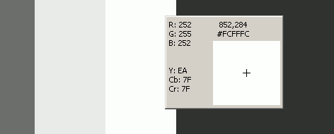

  27. There is this picker int vd2 showing both original YCbCr and converted RGB.
    Btw grayscale.mp4 has little chroma error
    [Attachment 45678 - Click to enlarge]

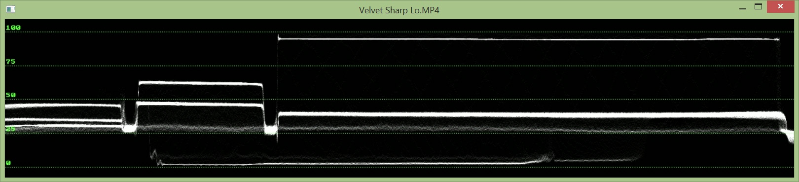

  28. Thanks to pdr pushing and pushing, I have rewritten my scope program to read the Y values directly out of the file, bypassing the OS graphics infrastructure. Now the scope tells a much different story. So the error was creeping in through the OS graphics infrastructure, i.e. the system that decodes YUV and delivers pixels to the screen.
  29. I don't know if this has been said, but I think it is worth mentioning. In terms of colorspaces and gamut, the RGB colorspace exists fully within the Y'CbCr colorspace which is to say there is no combination of RGB values that will produce illegal or out of gamut Y'CbCr values. This is not to say rounding problems don't exist but that is a separate issue from illegal values. However, the reverse cannot be said for Y'CbCr signals converted to RGB, and since OS's operate in RGB space, displaying out of gamut values is not possible. Additionally, while doing a simple matrix conversion of a single pixel is trivial, doing that for an entire image at 24+ fps is super hard. Therefore, OS's are notorious for being adequate but disastrous for exacting workflows. This is why broadcast signal chains exist. I haven't studied your C code, but I am almost certain your math is not correct only because I have never seen a post on VH with the correct conversion.
  30. As I said in the post before yours:
    So the issue of RGB <-> YUV is moot now.
    This is the case for mp4 files. The scope code was originally written for webcams and all I had to work with was a buffer full of RGB samples as the webcam driver wasn't converting to YUV.
