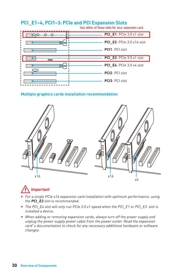

    Use this card: https://www.newegg.com/Product/Product.aspx?Item=N82E16816124045&cm_re=pci_sata-_-16-124-045-_-Product&nm_mc=AFC-C8Junction&cm_mmc=AFC-C8Junction-_-na-_-na-_-
    na&cm_sp=&AID=11552995&PID=5412144&SID=19619X76941 3Xdb65f44aecb6b3060bca2ba7abaede64
    And use one of the slots in the pic below
    [Attachment 45366 - Click to enlarge]
    This is from the manual for your motherboard - H170 Gaming-[M]3 (attached)
    Image Attached Thumbnails E7978v2.1.pdf
