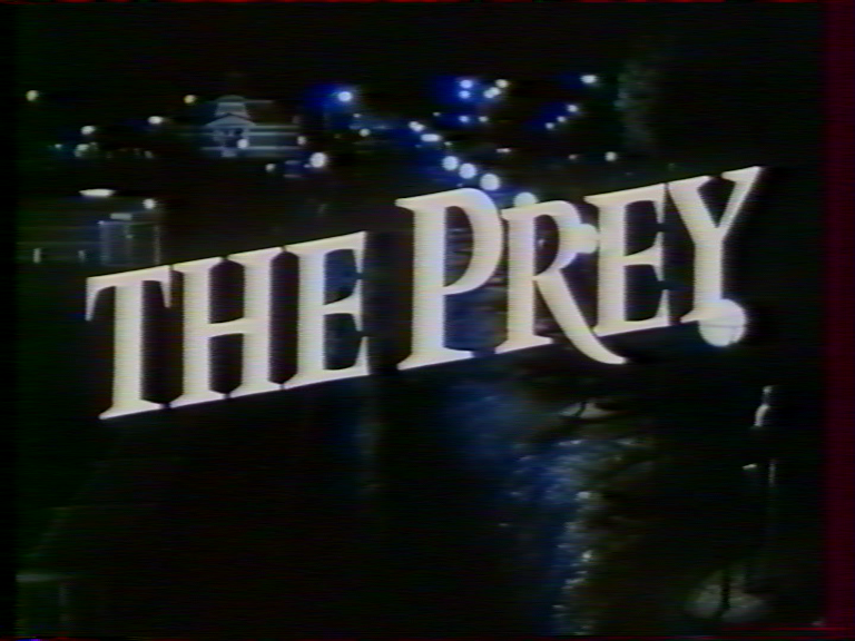

  17. Something I just discovered.
    After I apply the corrections, I lose on brightness, why ?
    [Attachment 46137 - Click to enlarge]
    [Attachment 46138 - Click to enlarge]
    If there is no explanation, what code can I use to recover the loss ?
    NOTE : This is after the trick used in this topic 'Erase red/purple mark (VHS capture)'
  18. Originally Posted by TONYFRANCE View Post
    What's the script/process?
