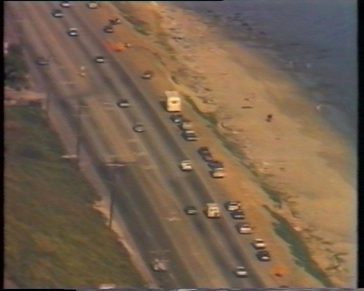

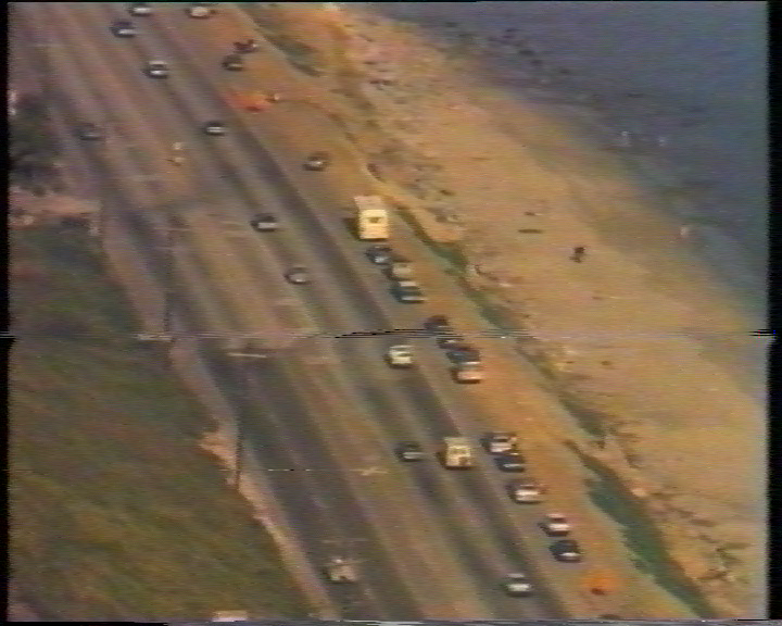

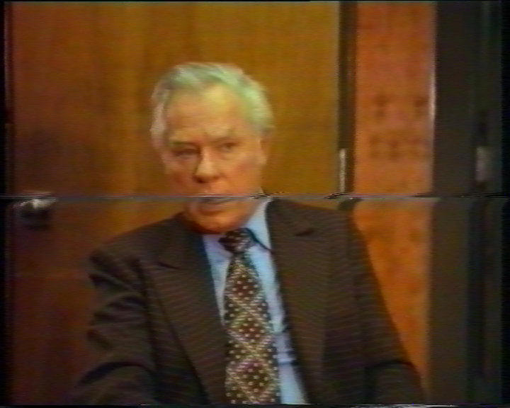

    Today I'd like to talk about Glitch or with my words, "bad lines".
    How can I remove them ?
    But first, I will show you 2 kind of glitch : black&white + colors
    It appears on 3/4 frames. But like a blink at normal speed.
    Thank you
  2. A video sample of each film
  3. You can interpolate over the "bad" frames using data from the adjacent "good" frames . e.g using avisynth/mvtools2. This method replaces the entire bad frames, but you can combine with more selective masks to repair parts of frames. Unfortunately, this approach means manual identification of frame numbers - so some work involved
    So in the 1st example, RX(13,3) means frames 13,14,15 are replaced
    AVISource("glitch1video.avi")
    RX(13,3)
    function RX(clip Source, int N, int X)
    # N is number of the 1st frame in Source that needs replacing.
    # X is total number of frames to replace
    #e.g. RX(101, 5) would replace 101,102,103,104,105 , by using 100 and 106 as reference points for mflowfps interpolation
    start=Source.trim(N-1,-1) #one good frame before, used for interpolation reference point
    end=Source.trim(N+X,-1) #one good frame after, used for interpolation reference point
    start+end
    AssumeFPS(1) #temporarily FPS=1 to use mflowfps
    super = MSuper()
    backward_vec = MAnalyse(super, isb = true)
    forward_vec = MAnalyse(super, isb = false)
    MFlowFps(super, backward_vec, forward_vec, blend=false, num=X+1, den=1) #num=X+1
    AssumeFPS(FrameRate(Source)) #return back to normal source framerate for joining
    Trim(1, framecount-1) #trim ends, leaving replacement frames
    Source.trim(0,-N) ++ last ++ Source.trim(N+X+1,0)
    2nd video
    AVISource("glitch2video.avi")
    RX(12,3)
    Other methods include a more precise repair in after effects / photoshop
    The problem here is selectivity - you want to repair the defect without damaging other parts

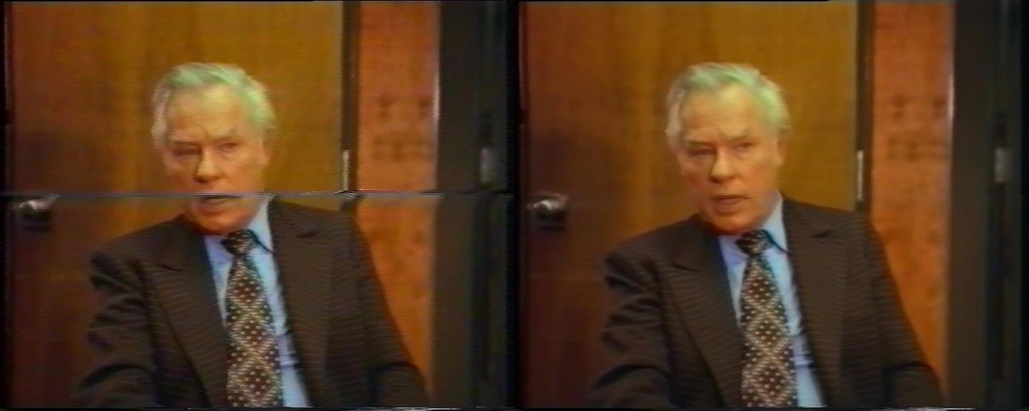

  9. You can sometimes use tricks to remove defects that appear for a few, but more than one, frame. For spots that appear over two consecutive frames:
    even = SelectEven().RemoveDirtMC(20)
    odd = SelectOdd().RemoveDirtMC(20)
    Interleave(even, odd)
    over four consecutive frames:
    even = SelectEven()
    ee = even.SelectEven().RemoveDirtMC(20)
    eo = even.SelectOdd().RemoveDirtMC(20)
    even = Interleave(ee, eo)
    odd = SelectOdd()
    oe = odd.SelectEven().RemoveDirtMC(20)
    oo = odd.SelectOdd().RemoveDirtMC(20)
    odd = Interleave(oe, oo)

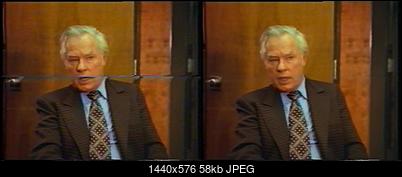

    This worked fairly well with the first of the two videos:
    AviSource("glitch1video.avi")
    SeparateFields()
    even = SelectEven()
    ee = even.SelectEven().RemoveDirtMC(30)
    eo = even.SelectOdd().RemoveDirtMC(30)
    odd = SelectOdd()
    oe = odd.SelectEven().RemoveDirtMC(30)
    oo = odd.SelectOdd().RemoveDirtMC(30)
    odd = INterleave(oe, oo)
    RemoveDirtMC(30)
    Weave()
    before/after:
    You have to be careful when using "dirt" removal filters like this. Sometimes real picture elements appear on single frames and they will disappear. Things like footballs in motion, panning star fields, etc.

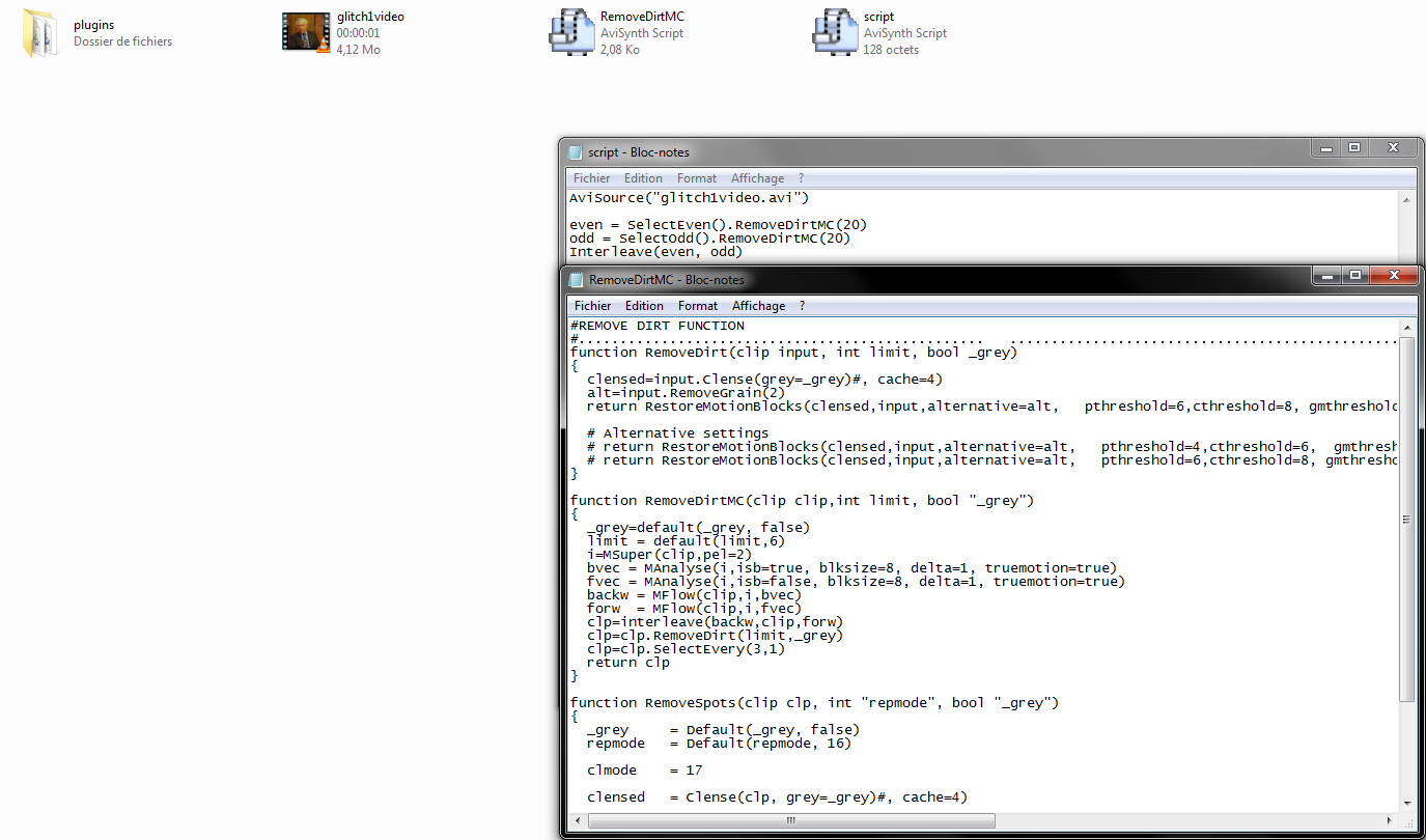

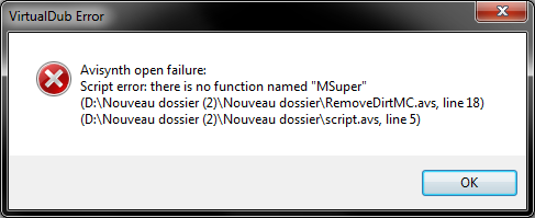

  10. Stupid question : I downloaded "Film_Restoring_vs_06_2012"
    But I don't know what to do to avoid the virtualdub message : There is no function named "RemoveDirtMC"
  11. Download RemoveDirtMC.avs and import it into your script.
    import("C:\Program Files (x86)\AviSynth\plugins\RemoveDirtMC.avs")
    Fix the path if it's somewhere else on your computer. You may also need some of the third party filters it depends on.
  12. Where can I find this filter ?
    Here ? https://pastebin.com/PgkQc9X4
    Then, I need to cut/paste into an .avs file ?

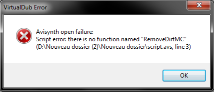

  14. I want to know if I'm stupid
  15. You can put the import line anywhere, but I like to import stuff at the start of the script:
    import("C:\Program Files (x86)\AviSynth\plugins\RemoveDirtMC.avs")  # change path if necessary
    Or you can include all the text of RemoveDirtMC within your script rather than importing it. You can use that script to verify you have RemoveDirtMC working but your video is interlaced and that script will screw it up. And the lines in your video last more than two frames so they will not be removed. Use the third script I posted once you have RemoveDirtMC working.
  16. Same problem, different message.
  17. MSuper is part of mvtools2 . So either put mvtools2.dll in the plugins folder to autoload; or load it manually with LoadPlugin("PATH\mvtools2.dll") in the script

  27. The filter works good but as said before, if I need to do it scene by scene, it's too much work.

  28. Comparison before/after
