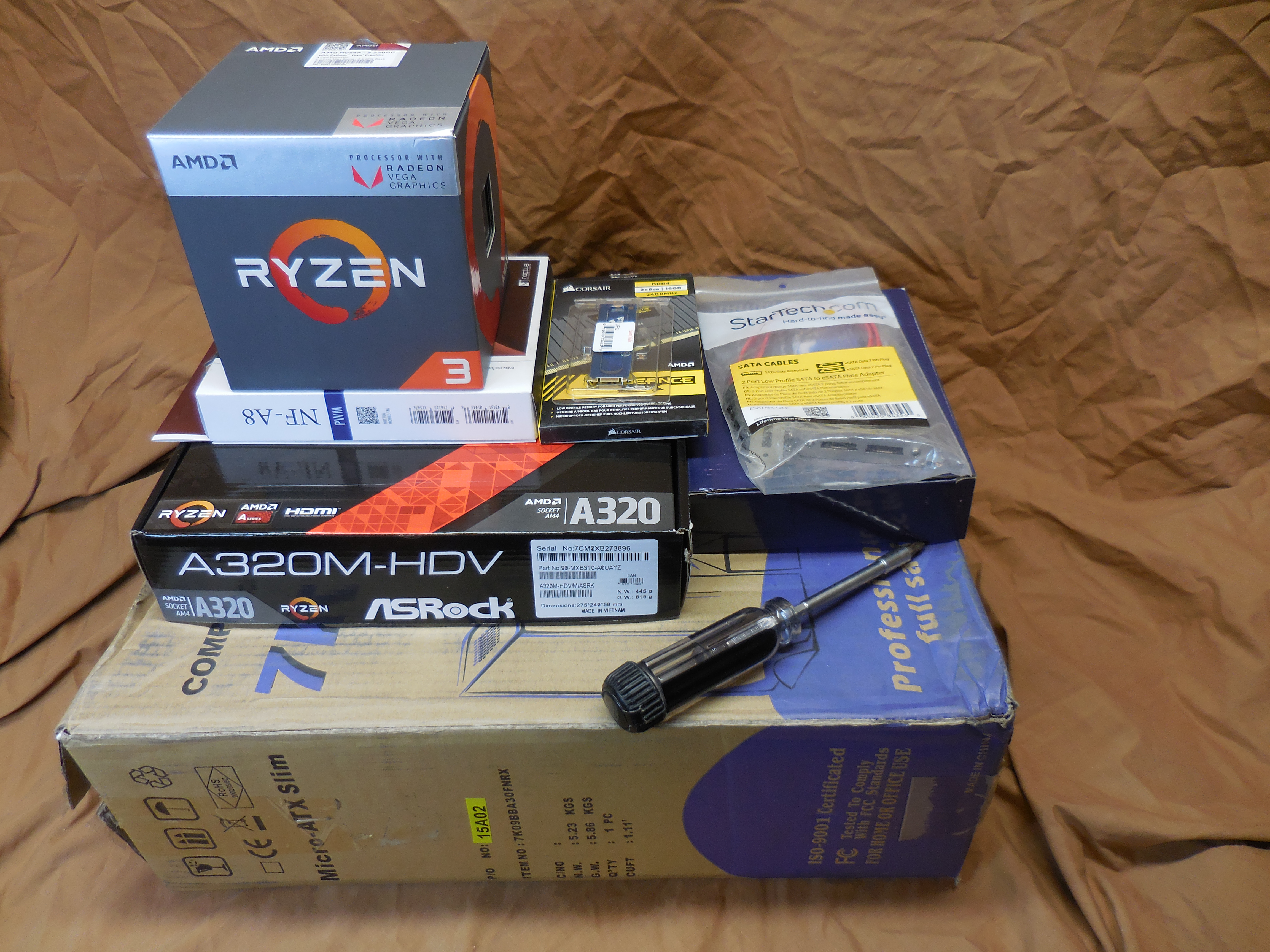

It's difficult to paste multiple photos with text on our forum, so I decided to convert the file to a PDF format. It's about 3.2MB
and consists of text and 26 photos. If you need a PDF viewer, I would recommend the freeware PDF reader Foxit.
It's about 1/3 the size of Adobe reader.
Foxit: https://www.foxitsoftware.com/pdf-reader/
CLICK ON THE URL BELOW TO DOWNLOAD THE PDF FILE
https://files.videohelp.com/u/26161/AMD%20Ryzen%203%202200G%20Quad%20buildm.pdf
Example photo:

	That may take a bit of research. I'm not that familiar with hardware encoding. And this PC is using a fairly inexpensive MB with a A320 chipset.
 The A350 chipset would be better for encodes. That said, it is an interesting CPU/APU combination for a economy PC. I think the CPU/APU Vega
 setup is more aimed at someone building a economy gaming PC, though I see it is being used for streaming video using hardware encoding.
	This is a video site. Why not post a video of your build? Or are VH's members only capable of ripping/capping others content?
	Download the pdf and you will see the build,nice setup and pdf to read by redwudz. I think,therefore i am a hamster.
