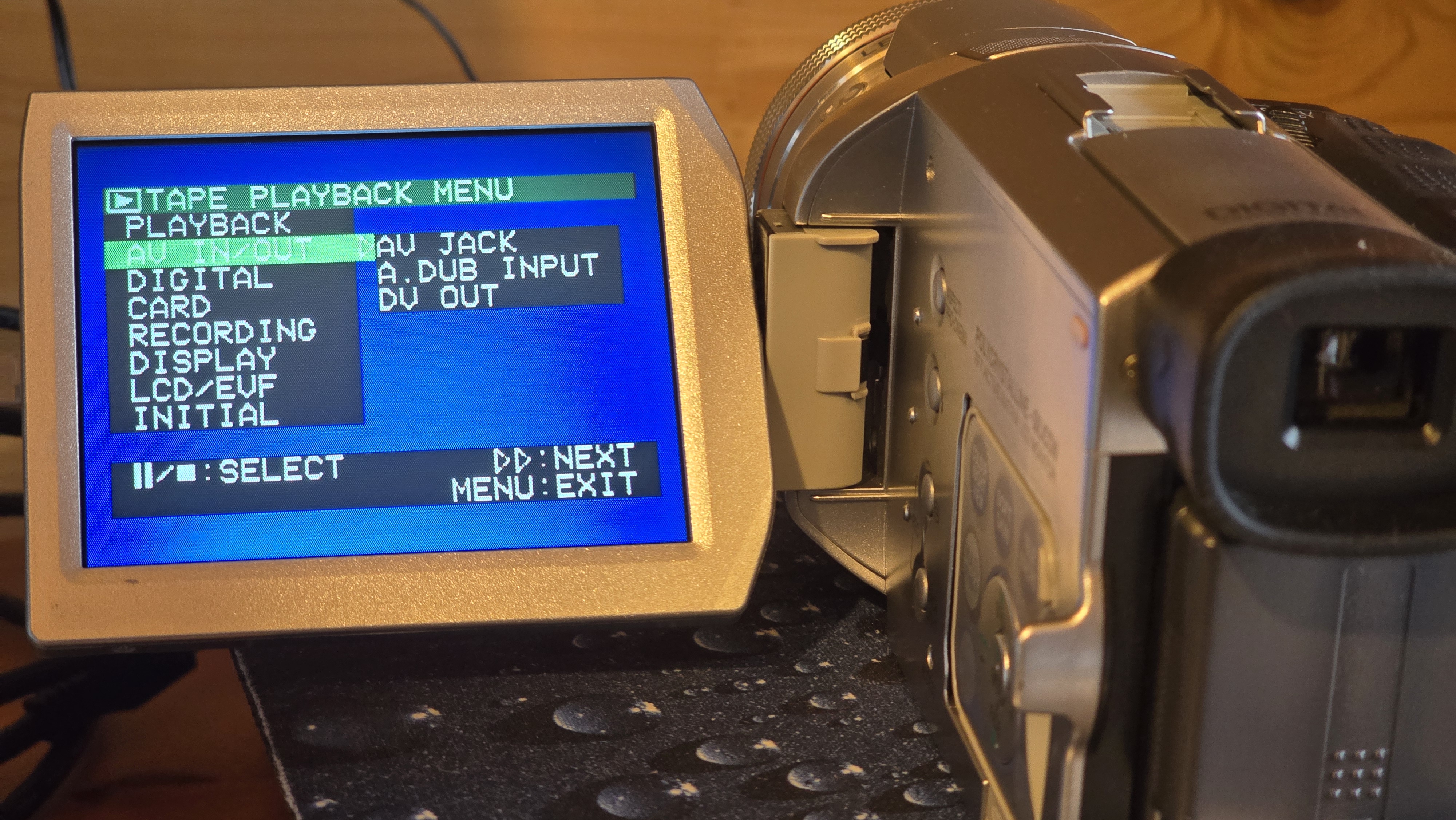

    [Attachment 82487 - Click to enlarge]
    Works aok. Used VHS tape, output RCA/Phono connectors VHS --> GS400 --> PC via firewire. Didn't test S-Video instead of phono but I'm sure it would also work.
    Set GS400 to playback without DV tape.
