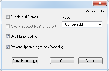

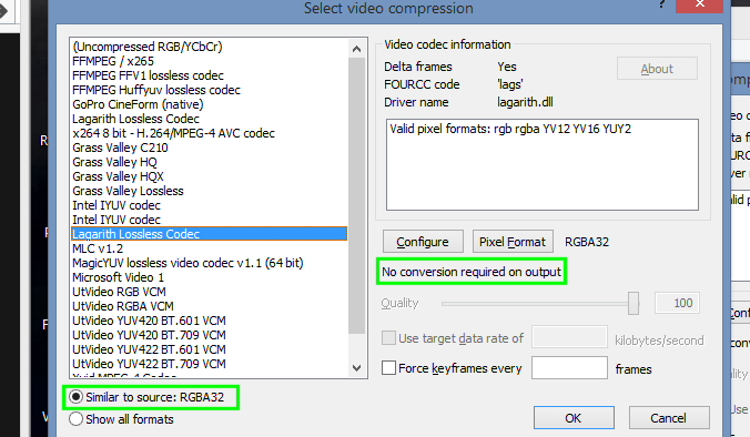

    Then you did something wrong. Lossless compression is exactly what it says -- lossless. In all likelihood you performed a colorspace conversion. Since you are capturing the screen you are capturing RGB, set Lagarith (and whatever software you're using) to RGB or RGBA mode, whichever is suitable.

    Lossless doesn't mean 90 percent. It literally means lossless. The picture that comes out of the Lagarith decompressor is the exactly same as the picture that went into the encoder. If you see a difference it is not Lagarith's fault but something else in your processing.

    My apologies, yes I was thinking of game capture. For capturing a tutorial, you might try Virtualdub Filtermod, with an RGB codec of course -- I did a quick test and it seems to work:
    (compression dialog )

    You didn't use RGB mode in lagarith, or you converted before encoding with Lagarith.

    Lagarith with Camstudio. As poisondeathray and jagabo have suggested, the video player I was using, did not display the capture video using Lagarith in the most honest light. After using the settings that jagabo had shown, I got a practically perfect picture. At one point, I couldn't tell difference between the recorded video I was looking at and my desktop in real time! when I uploaded it to YT it was fantastic. and this is what I wanted the whole time. But of course there is a problem...
