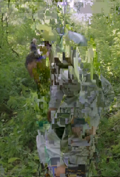

    Have many Humax TV recordings which are 1920x1080 PAL, Interlaced, H.264 *.ts files, with variable bitrates around 12 Mbit/s, which I want to convert with Handbrake to smaller *.mp4 files without loosing too much quality.
    Did an initial Handbrake test, with a 49min video, which went well, but did notice 3 destortians in the mp4 output file. These distortians only last a second or so, but are very noticeable, lots of blocks are on the screen (e.g. see uploaded image). Did check these specific timeslots in the source file, frame by frame, but they all look ok.
    Have extracted these particular small parts from the source file to another *.ts file, and did numerous Handbrake test against it, with all kind of settings and filters, but I am not able to get rid of the distorations. Even tried RF=0, Preset=Placebo, but didn't help. Since the input file is Interlaced, tried some Filter settings like Decomb Bob/Default, but the distortians stay.
    Please advise, since I am not an expert, and am using Handbrake for the first time. Thanks!

    [Attachment 44397 - Click to enlarge]
  2. 1. try HandBrake nightly
    2. try QuickSync decoding (If available on your system. Sometimes error concealment is better on hardware decoders.)
    3. remux to mkv using mkvtoolnix and try again
    4. report to HandBrake team https://github.com/HandBrake/HandBrake/issues
    If you want anyone here to comment further upload the file.

    Attached my source file which contains only the three problem scenes. When converting with handbrake, the following three distorations appear in the target *.mp4 file
    1. Part of the Waterfall scene
    2. Red roof combing effects (was also in the source file, but would like to eliminate it).
    3. Person walking away from the bear.
  4. 1./3. Seems to be a known problem:
    https://forum.videohelp.com/threads/383215-Why-in-Handbrake-Not-in-Any-video-Converter
    https://github.com/HandBrake/HandBrake/issues/674
    It should work in Handbrake nightly.
    Maybe someone else can recommend a filter for 2.

    Just installed Handbrake Nightly (HandBrake-20180114-96909e4_x86_64-Win_GUI.exe), as recommended, and indeed the distortians have dissapeared. Thanks for the solution!
    Would like to understand what kind of fix is in the Nightly build since, although I am not an expert, always thought that Handbrake is just a frontend to the x264 encoder, which it invokes with certain parameters, based on what is defined on the input screens. Does the nightly build invoke another version of x264 or are different parameters passed to it? Or perhaps something else?
    Only issue left is the distortian in de Red roof scene. Are these Moire patterns? And, how can I elinimate them?
  6. The issue is not on the encoding side (x264) but on the decoding of the source. Decoding is not done by x264.
