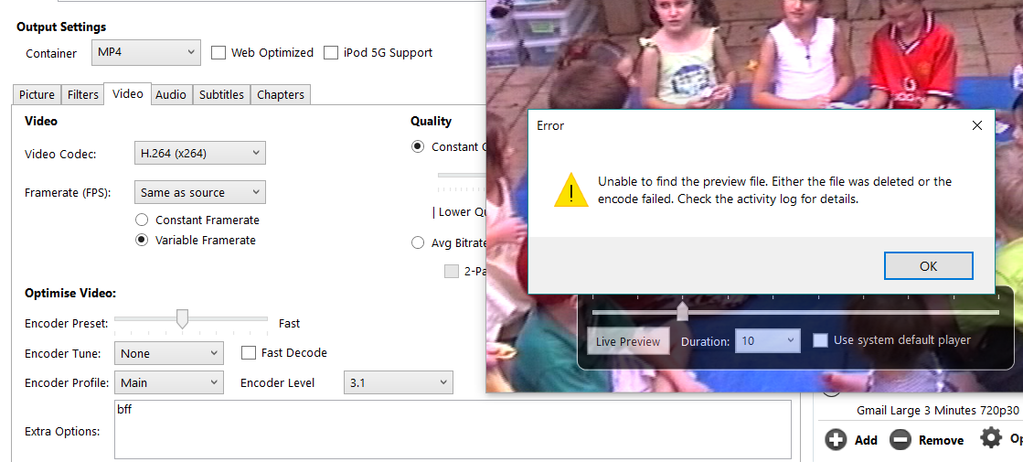

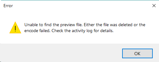

  14. Hi Guys,
    I entered bff and also tried bff=1 but in both cases I only get the following error Image
    [Attachment 43862 - Click to enlarge]
    If the extra options box is empty, I have no problem encoding. I must be doing something wrong. Any suggestions?
  15. You're using the "H.264 (x264)" encoder? I don't know if it works for any of the other encoders.
  16. Try selecting Constant Frame Rate, Same As Source.
  17. Nope, same issue
    I'm running version 1.0.7 (2017040900)
  18. I have the same version, 64-bit. I can't reproduce your problem. Try closing the preview window?
  19. Mine is 64 bit as well. I think it is the source AVI file I'm using for testing. I tried another source file with bff and the encoding started to work. I went back to the original source file to rerun it but again it failed indicating that there were two errors or cancellations. There shouldn't be any material difference between the two source files since I basically used the same capture methodology. Looking at the error log I found "ERROR: ECMA 167 Volume Recognition failed" Not sure what that means and if it is the cause of the problem. But what I'll do is rerun the tests using a different source file and return with my observations.
    Thanks for all your help and especially your patience.
  20. Could it be avi file type1 vs. type2 problem? What software did you use in your computer to capture it, is there type1 vs. type2 selection? Type1 might not compatible with VFW. Not sure what Handbrake uses to read that avi file.
    Edit: ok, you say some of your files worked, so this is not it
  21. Thanks for the suggestion Al
    They are all type1 but I can easily convert the file into type2 to see if that fixes the error for that particular clip. Who knows, it might work.
  22. Ok,
    I further looked into this problem. Converting the AVI type to 2 didn't help as suspected by Al. But I have found what the problem is. For whatever reason my NTSC files work but my PAL files do not. I'm not sure if anyone can shed light on this issue and it may be a bug within Handbrake.
    Regardless, Jagabo indicated that Handbrake had issues generating interlaced files anyway so I'm looking at MeGui to see if it can generate the appropriate interlaced MP4 file.
  23. PAL DV may be ok in Handbrake. PAL DV is interlaced YUV 4:2:0 whereas NTSC DV is interlaced YUV 4:1:1. Handbrake's conversion 4:1:1 to 4:2:0 for h.264 compression is where the problem happens. If Handbrake's DV decoder outputs 4:2:0 and sends that directly to x264 there will be no mixing of the chroma channels.
  24. So Jagabo clarified that PAL DV doesn't require a YUV conversion so the chroma channels should be ok. That's great but forcing Handbrake to interlace PAL DV with the bff parameter DV doesn't seem to work although jagabo tried but couldn't recreate my problem (thanks for trying). I suspect jagabo was using a NTSC DV file.
    I further investigated this weekend. The problem was either my computer, Handbrake or the actual PAL DV file I was using (actually all my PAL DV files). So I loaded a fresh version of Handbrake on another computer (my laptop) and I sourced a completely different PAL DV from another thread.https://forum.videohelp.com/threads/385717-Some-Noob-queries-regarding-AviSynth
    jagabo actually helped the op in this thread regarding his issue. House_Sample.avi. Anyway, using this DV PAL sample, I recreated the error message. So I have concluded that Handbrake doesn't encode PAL DV using the bff parameter.
  25. I was able to convert a few PAL DV AVI files with Handbrake using x264 with the bff flag. I also verified that it doesn't screw up the chroma channels (I disabled all filtering).
  26. Hi jagabo, I just read your post
    Thanks for the further testing. Strange I even went back and installed an older version 1.0.2 32 bit version and I get the same error! Would you be so kind as to post your activity log so I can go through it and identify where there are differences?
