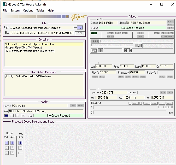

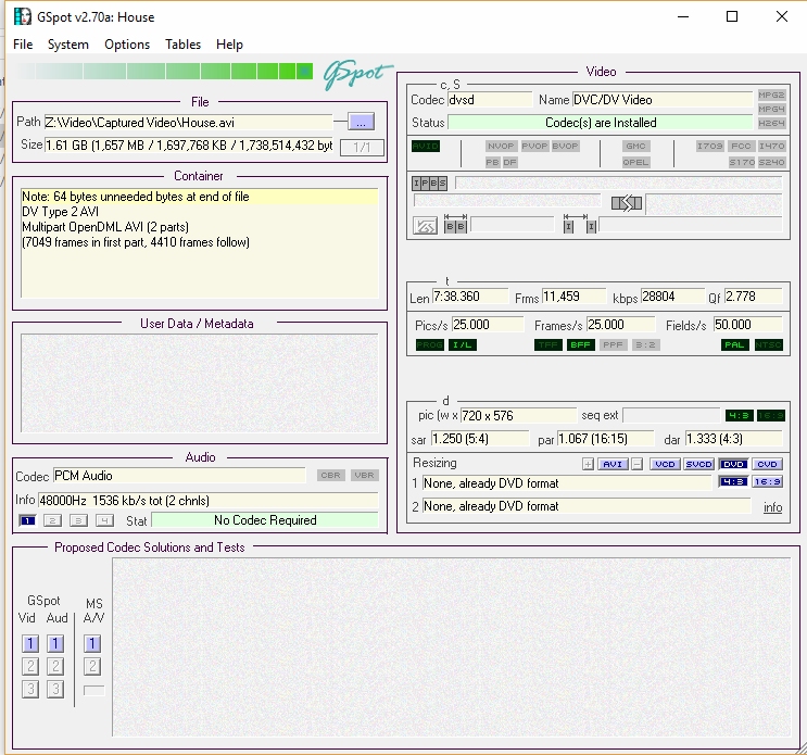

    DV File
    [Attachment 43640 - Click to enlarge]

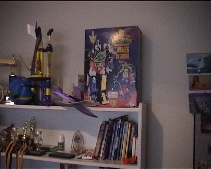

    Result of Script 2
    [Attachment 43641 - Click to enlarge]
    The file created is nearly 10x size the original DV file, GSpot says 7.4GB is unneeded and is differing aspect ratio.
    Any comments on making improvements?

    AviSynth always decodes to uncompressed RGB or YUV video (and PCM audio if present). DV is a compressed video format already.
    The original purpose of this frameserver was providing access to different video source formats for applications which could only read AVI via VfW. But the scriptable filtering and plugin support increased its versatility.
    GSpot is quite outdated in these days; MediaInfo is more flexible and supports more different media formats. But for AVI and quite usual content formats, it's still good enough.
