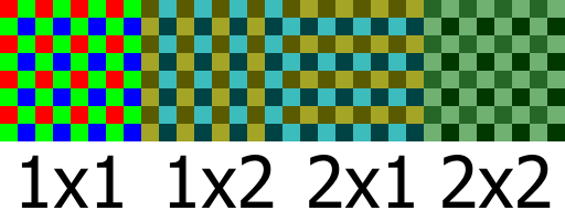

    Test of bayer filter pattern. Of course square = pixel. Saves as jpeg, bellow is subsampling using jpeg. 1x1 = 444 2x2 = 420. Most photo camera is using 2x1 probably 411. And of course I know this is the worst possible case. Funny thing is that 444 in this case is smallest filesize but it is also irrelevant.

  4. Note that exactly what you get with chroma subsampling will depend on the algorithm used to downscale and upscale the chroma.
    And since cameras use bayer pattern sensors they are inherently something 4:2:0 at their best resolution.

  6. I wasn't talking about your upscaled images. But the algorithm that is used to convert from RGB or YUV 4:4:4 to YUV 4:2:0 and then to convert that YUV 4:2:0 to RGB 4:4:4 for display. Different programs/players use different scaling methods (point, bilinear, bicubuc, something else; MPEG placement, DV placement, etc.). So you'll get slightly different colors from different programs/players.

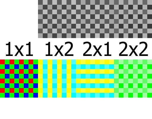

    I'm using krita for this, probably gimp should be better, but it has similar functionality. There is also interesting filter, that converts channels of picture to layers. In this example is used channels to layers (HSV). RGB and CMY(k) colorspaces gave predictable result RGB 3 layers CMY(k) four layers, HSV is really interesting. It seems to me it separate color from its bases. When I apply it on picture that I posted earlier, I got this layers (I manually create new image with both in one layer (instead of 2)). Just don't understand, why in bayer pattern (1st on left) almost white space but 2 colors from which one (green) is most probably pure white, i don't understand it well.
    [Attachment 43841 - Click to enlarge]
    But it works great as I mentioned earlier, for separate chroma, if I understand the thing I get by this operation. Maybe fully saturated colors are displayed as no "luma"
    But in bayer pattern there, is in rgb form Red (254,0,0) Green (0,255,1) and Blue (0,0,254) and it was generated by Bayer pattern generator.
    If you have some picture, with known subsampling, send it to me (if you want) and I can try "separate color". It is very easy to see in usual photography or real life pictures.

  10. The images look exactly like what one would expect. https://en.wikipedia.org/wiki/HSL_and_HSV
    Keep in mind that HLS and HSV is different from video YUV where R, G, and B are weighted differently in terms of intensity. For example, with rec.601 the intensity (Y) is calculated as:
    Y = 0.299 * red + 0.576 * green + 0.114 * blue
    So, for example, a full intensity pure blue becomes a fairly dark shade of grey.
    https://en.wikipedia.org/wiki/Color_matrix#ITU-R_BT.601_conversion
    In AviSynth you can visualize Y, U, and V channels with
    Y = ColorYUV(cont_u=-256, cont_v=-256) # or Tweak(sat=0)
    U = UtoY()
    V = VtoY()
