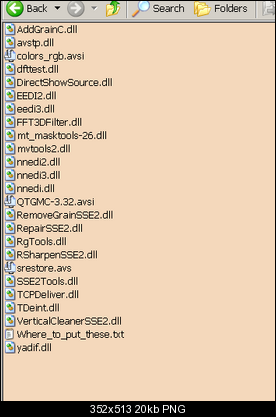

    In the AVISynth plugins folder I have:
    masktools2.dll
    mvtools2.dll
    nnedi3.dlll
    RemoveGrainSSE2.dll
    RepairSSE2.dll
    RSharpenSSE2.dll
    SSE2Tools.dll
    QTGMC-3.32.avsi
    srestore.avs
    avstp.dll
    colors_rgb.avsi
    DirectShowSource.dll
    TCPDeliver.dll

    attached ZIP has folders for System fftw3 dll's, 32-bit QTGMC plugins, VisualC 2010 runtime installer. Don't unzip this ZIP into the Avisynth plugins folder. Download the ZIP to its own folder, unzip it, and use the plugins and utils in the zipped folders. Copy the different dll's to their respective locations separately. If you have problems with QTGMC-3.33.avsi (some people do), replace it with QTGMC-3.32.avsi.
    If you have "masktools2" or "mt-masktools2" or "mt-masktools-25", remove them. Save them in a separate folder if you want, but you should have only mt-masktools-26 in the plugins folder.

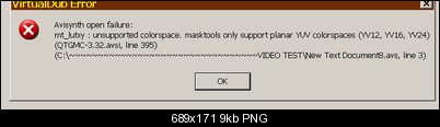

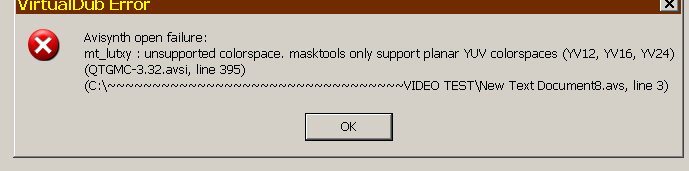

    I don't understand the YUV or YUY2 colors thing - is that something I'm supposed to install?
    No, but certain filters work only in certain colorspaces. If you're in something other than YV12, for example, many important filters work only in YV12 so you'll have to convert to it with a 'ConvertToYV12()' added to the script (for a progressive video). To find out your colorspace add 'Info()' to the script at the end and have a look in VDub. If one of your filters isn't working, comment it out first.

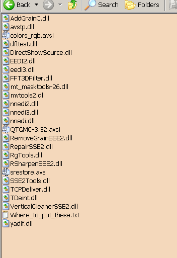

    This is my plugins folder now. Maybe the YUV / YUY2 needs to replace colors_rgb.avsi -?

    MSVCP110.dll does not belong to Visual Studio 2010, but to Visual Studio 2012. Therefore I wrote: "from Visual Studio 2010 on" ... up to 2015. All existing versions. You'll never know when a plugin author may switch from an older Visual Studio compiler to a newer one, and suddenly the plugin needs another runtime version.
    Don't just download single DLLs from suspicious websites. Always install directly from the original creator (Microsoft, in this case). Some applications may need more than just MSVCP???.dll, there are more related DLLs in the runtime packages. And furthermore, when installed, Microsoft Update will take care of keeping each runtime package up to date.
    Microsoft Visual C++ 2010 SP1 Redistributable Package (x86)
    Visual C++ Redistributable for Visual Studio 2012 Update 4
    Visual C++ Redistributable Packages for Visual Studio 2013
    Visual C++ Redistributable for Visual Studio 2015
    And don't panic about YUV. Instead, read about such video basics, starting in the Wikipedia. In general, YUV is a "color space" similar to RGB (just with a differential representation: Y is the luminance ~ brightness, U and V are differences from grey away towards blue/yellow or red/green), and YUY2 is a FourCC (4 character code as identifier) for AVIs (or related video streams) storing YUV in 4:2:2 chroma subsampling (each 2 pixels with separate luminance Y, but shared chrominance difference values U and V), "packed" in units of 4 bytes: [Y U Y2 V] ... in brief: You don't need to install anything to have it supported, it is basic.

    Here's the YUV error:

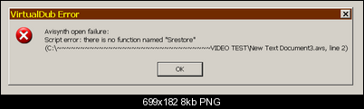

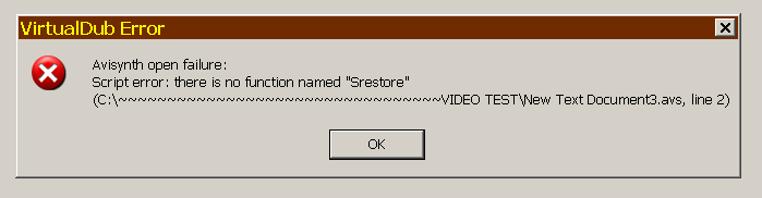

    I removed line 2 (QTGMC) and this is the error now. Maybe using the 'Import' line will help ?

    Change your script:
    Import("drive:\path\to\Avisynth\plugins\sRestore.avs")  #<- change this path to match your system.
    AVISource("SHORT TEST.avi")
    ConvertToYV12(interlaced=true)
    QTGMC(Preset="faster")
    Srestore(Frate=19.98)
    AssumeFPS(17.982)
    Crop(8,0,-8,0)
    LanczosResize(640,480)
    - My sister Ann's brother
  27. Originally Posted by bvdd View Post
    Maybe. Did you try? It takes all of about 15 seconds (or less) to write out the import line.
    Import("C:\Path\To\Srestore.avs")### or AVSI or whatever the extension is.
    Once you get working scripts, especially if you'll be using them or similar ones again, save them. I have about 10 scripts I use all the time and another 50 or so I use less often for which I have to change only minor things for whatever it is I'm working on.

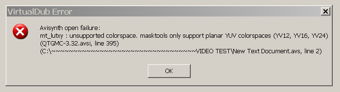

    caused this error:
Name:	VDub Error 3.png
    So I switched lines 3 & 4 and the errors are gone, but now the video clip plays VERY slowly and jerky.
    Yes, that seemed to work. If I can recreate what you originally did with my clip, I'll be thrilled.
    I'm close now, just need to solve the 'slow and jerky' result.
