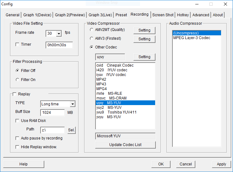

  1. I am using a Diamond VC500 with AmarecTV 2.31 When pressing the record button, AmarecTV generates an ICOpen error. I don't really know what other software to use. I have audio sync issues when using VirtualDub.
    Mar 2008
    According to various bits and pieces on the internet, this indicates some error/incompatibility wit the chosen codec.
    If you haven't tried it give HuffyUV a go.
  3. I was just using the option below before. Also, I installed HuffYUV, but it's not showing up.
    [Attachment 43541 - Click to enlarge]
    Aug 2010
    San Francisco, California
    YUY2 may be a happier choice. Did you install HuffYUV properly, especially if you are running a 64-bit OS?

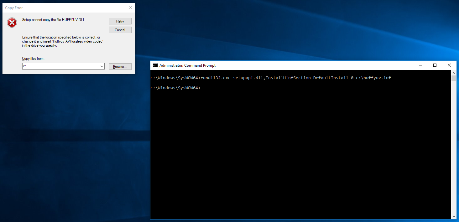

  5. I tried installing by right-clicking on the file and selecting Install. Yes, I tried the 64-bit one with a 64-bit OS. Then I tried the 32-bit one and it still wouldn't work. YUY2 doesn't work either. What's wrong with UYVY? That's what Premiere exports as.
  6. Originally Posted by Hypersonic1 View Post
    The original Huffyuv was never updated to work on 64 bit Windows. To install it on 64 bit Windows requires a special procedure where you have to register the codec yourself. JVRaines gave a link to a page that describes how to do this.
    32 bit programs require 32 bit codecs, 64 bit programs required 64 bit codecs. The two environments can't "see" each others' components.
  7. Yes, both huffyuv.inf and huffyuv.dll are in the root of C:\.
