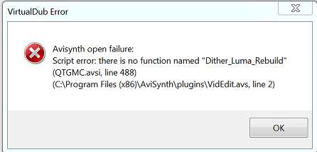

    I believe QTGMC and dependencies are installed correctly, but get VirtualDub Error/ Avisynth open failure:
    Script Error: There is no function named "Dither_Luma_Rebuid".
    Does this offer any suggestion to what the problem might be?

  23. http://avisynth.nl/index.php/QTGMC
    # v3.33s (mod) 2016 12 06
    # - Add TR2=4 and TR2=5
    # - add TV_range bool and dither_luma_rebuild (from SMDegrain) Str and Amp
    # - for avsplus now QTGMC_Bob is ready for any 420, not only yv12
    So dither_luma_rebuild is part of SMDegrain, and the wiki lists the correct version: v3.1.2.93s. Better update all requirements mentioned on that page.
    I took the easy way out and asked, after following hundreds of dead and outdated links to build plugin collection, it was doing my head in.
    Found a link to SMDegrain+v.3.1.2d here if anyone needs: http://www.mediafire.com/file/9kd7d6ba2l0m6qd/SMDegrain+v.3.1.2d.zip
    Here is the Avisynth Basic Tool Kit, should be enough to experiment with.
    Going to leave it for now, feel free to contribute suggestions if you have a favorite.
    Thanks for every-bodies input.
    Added: Deblock_QED_MT2Mod.avsi
