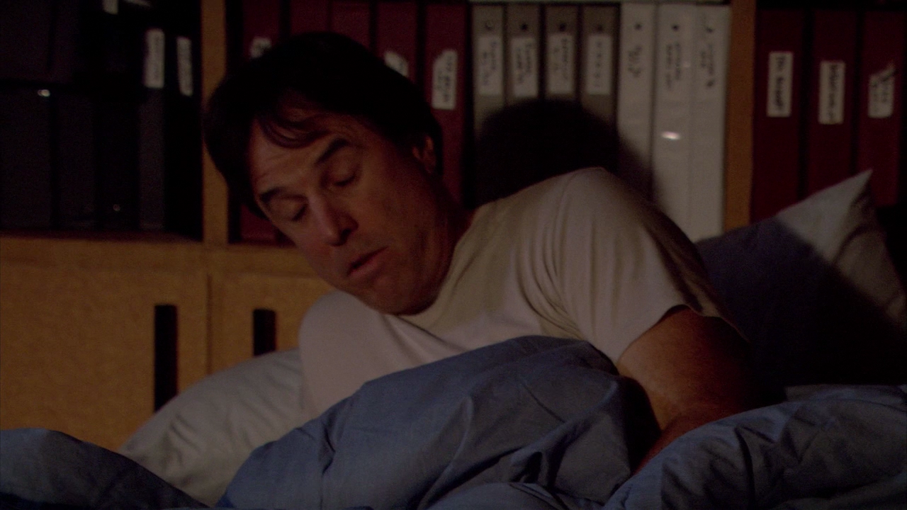

  1. This isn't anywhere near being a definitive comparison and it was only done use the default settings for each denoiser. I have no doubt some of the denoisers could do a better job if I fiddled with their settings but I'm far from being an expert there so I just used the defaults.
    The main purpose for doing the test encodes was to compare other denoise filters to the filter I've been using for denoising despite the fact it's not officially a denoiser (QTGMC in progressive mode). I was going to post screenshots of each test encode but they really don't tell the full story so I uploaded small samples instead.
    In my opinion, QTGMC does a better job (or at least more pleasing to my eye) than the denoisers even though it's not officially a noise removal filter as such. It didn't necessarily remove the most noise, but it does "stabilise" what it doesn't remove so it no longer seems as "noisy" and therefore it doesn't blur the picture as some noise filters do. In fact QTGMC can have a slight sharpening effect instead. The two script based denoisers I tested did a pretty good job removing a large amount of noise without too much blurring, but for me, QTGMC's output is still more pleasant to look at.
    I've included the original video with the samples. If anyone would care to try denoising it with clever filter parameters or a different filter please feel free. Being fairly lazy myself though, I'd prefer to use a "one size fits all" denoiser which I know will do a pretty good job without my needing to spend time making adjustments every time I use it.
    Here's my take (alphabetical order). Feel free to tell me if you disagree.
    degrainmedian: Seems like a decent compromise between noise removal and blurring, as long as you're prepared to overlook the first frame which it appears not to denoise.
    dfttest: Removed a fair percentage of noise while at the same time blurring too much for my taste.
    FastDegrain script: Subjectively, I liked the result. It removed a great deal of noise and while it did blur a little, for some reason I didn't find it too objectionable.
    fft3dfilter: Caused as much blurring as a couple of other filters without removing as much noise.
    FluxSmooth: Seems pretty similar to degrainmedian. Why don't they denoise the first frame?
    RemoveGrain: Doesn't seem to do a great deal of noise removal using default settings.
    TemporalDegrain script: Removes a large amount of grain/noise using default settings. Considering how effective it is the amount of blurring is acceptable, although it probably blurs a little too much for my taste.
    TTempSmooth: Default settings don't seem to do a great deal of noise removal.
    VagueDenoiser: Probably belongs in the "lightweight denoiser" category using it's default settings.
    VerticalCleaner: Probably belongs in the "lightweight denoiser" category using it's default settings.
    Denoisers which don't denoise the first frame would be an issue for me. Now and then I use a denoiser in combination with Trim() to denoise just the sections which need it rather than denoise the entire video.
    So far the denoisers I prefer are the two script based ones. FastDegrain and TemporalDegrain. Even though FastDegrain doesn't remove quite as much noise as TemporalDegrain I prefer it's denoising because it doesn't blur quite as much.
    QTGMC doesn't actually remove as much noise as the previous scripts, however to me, "noise stabilisation" is generally a more pleasing result than "noise removal" because it blurs the video less. It mightn't be to everyone's taste, but I prefer it so far. QTGMC encodes included in the attached zip file:
    QTGMC (default settings): Very slow in single threaded mode.
    QTGMC (medium speed preset): Acceptable speed in single threaded mode at 720p.
    QTGMC (fast speed preset): On a par with many of the other filters speed-wise.
    The faster the QTGMC preset, the less noise removal/stabilisation it does, but I kind of like that, especially when the source video only contains "light noise'. I've deliberately used a faster preset on occasion because I've thought it produced a more "natural" looking result (to me). I guess it's similar to the traditional noise removal/blurring compromise.
    Last of all QTGMC with it's "internal" noise filtering enabled (I used it's EZDenoise function). By default, QTGMC's noise removal is disabled.
    QTGMC(InputType=1, Preset="fast", EZDenoise=2.0)
    Anyway, if anyone would care to look at the samples and offer an alternative opinion I'd be interested. Likewise if anyone would care to re-encode the original sample using their favourite denoise filter/settings and think it does a much better job I'd be keen to have a look.
    Keep in mind all of the above is simply my opinion and as a general rule I'm fairly confident I have no idea what I'm talking about.
    Edit 02 June 2014:
    Well I came back to this thread by accident nearly a year after creating it, and discovered my samples are still being downloaded occasionally. Not too many other posters offering an option though.....
    A year later and I'm still using QTGMC for noise removal regularly. Initially I preferred to stabilise the noise rather then remove it but my taste has changed a bit and now I prefer to remove as much noise as possible without noticeable blurring (or very little blurring) and then stabilise any noise remaining. As a result I find myself using QTGMC in a progressive mode like this quite a bit:
    QTGMC(InputType=1, Preset="slow", EZDenoise=2.0)
    I tend to adjust the speed preset according to the resolution (a faster preset for HD so encoding doesn't take forever). For very light noise I won't add the EzDenoise option. For more noise I add it and increase it as required.
    Anyone else tried QTGMC for noise removal?

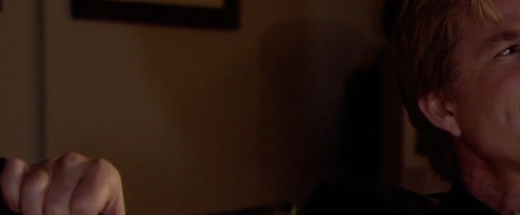

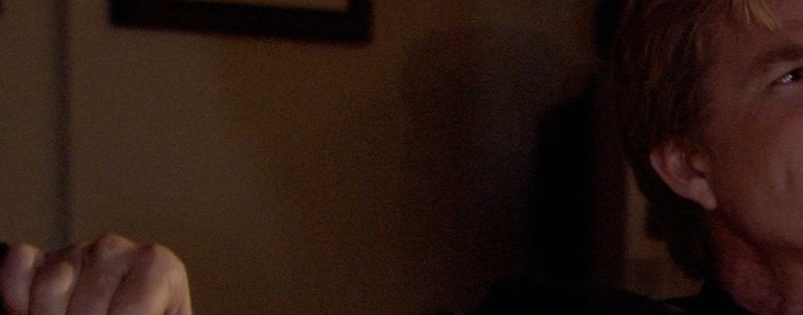

  17. Originally Posted by StrobeLightEpileptic View Post
    Just a little "noise" from me ;o) The problem with the video samples you post is that the video is pretty clean to begin with. I watched all the samples and could find no difference in any of them.
    Something there seems not quite right to me. The "original" sample is fairly noisy. I can see differences between them even when viewing them on my CRT PC monitor. Using my TV, there's a fair difference. How are you viewing the samples? There's nothing in your playback chain which could be removing noise? My TV has a reasonably effective noise filter and deblocker of it's own (both of which I disable as they also blur a bit).
    These are screenshots from the samples in the first post. Can you see the difference between them when they're pics rather than video? "Original" vs "QTGMC, Preset fast, EzDenoise 2".
Name:	QTGMC fast with EZDenoise.png
    Plus the file size of the samples (same CRF value and encoder settings each time) range from 2MB to 7.2MB, which is a fair indication they don't have the same amount of noise.
    I wish you would post some really problematic video and show your results from that.
    Did you look at the torture test samples attached to post #5?

    A comparison of original and the result of my filter configuration:
    [Attachment 28924 - Click to enlarge]
    [Attachment 28925 - Click to enlarge]
