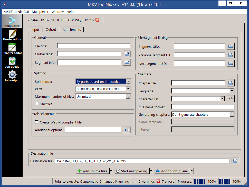

  7. And I also need to edit out the ad-breaks!!!
    If you know the time codes for the parts you want to keep you can do that in MKVToolnix as well by using split by parts based on timecodes. Preceeds the parts with "+" to join them.
    See also
    https://forum.videohelp.com/threads/359121-How-to-extract-cut-parts-from-a-mkv-includi...ubtitle-tracks

    Edit:Hi, Videobruger. It is not a frame accurate cutting? is it? Because I often find, that there are not I frames when commercial ends (x-th part of tv show begin).
    Bernix

  11. It is not a frame accurate cutting? is it?
    No.
