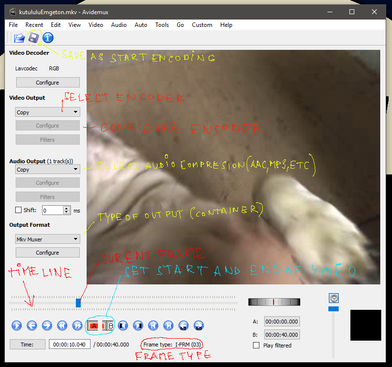

    Here I made image, but sorry I must laugh to myself...
    [Attachment 43411 - Click to enlarge]
    There under the timeline is A and B in somewhat blueish weird color Pressing A mark start point on timeline. Move where you want end and press B (is next to A icon also in weird color)
    When your starting point of selection A mark is on I frame like in video (but there is exception i will not explained it now) B Mark frame position isn't important. So you can use copy video, copy audio and save as and result will be perfect.
    But when A isnt on I (for short i suppose it is keyframe) frame then you have to re-encoded video. So you have to choose where is copy under video to x264 or x265 or what you want. Then when you click save as, then it will last longer. Because whole selected part must be re-encoded. Then in mkvtoolnix you can merge different parts of video with same resolution, and audio. Best is when the video parts are encoded in same encoder and fps and resolution.
    So I do first part of video this way, re-encoding and then paste rest of video which i get copy video copy audio, because I know I started the second part started on Keyframe.
    I am not good in explaining, so if you have any question, ask and I will try to explain.
    Bernix
  5. Originally Posted by Bernix View Post
    Hi,
    no, you dont need pre processing video. Actually Avidemux indexed video when not mp4 and maybe ts. Load of mkv or mpg last some time.
    Bernix
    I succeeded in cuting a file, so thank you so much!
