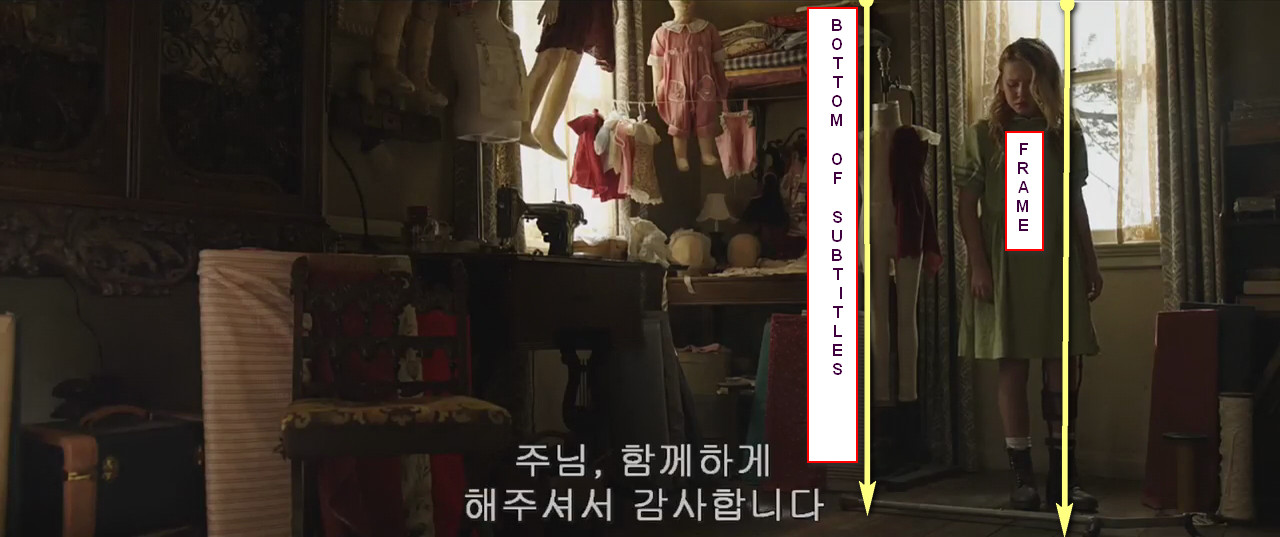

  1. Your height h of 104 is wrong.
    It should be from the bottom of the subtitles not the bottom of the frame
    Also the sum of your y (437) and h (104) is 541.
    However the height of your frame is only 536.
    Stream #0:0: Video: h264 (Main), yuv420p(tv, bt709, progressive), 1280x536
  2. Originally Posted by videobruger View Post
    it is from bottom of subtitles the height I'm a bit lost when you say frame
    you mean exact bottom of screen
    so how do I make correct measurements
    where you finding height of frame is 536
    I just changed height to 88 so 437 + 88 = 525 which is under 541 so why do I still get this error

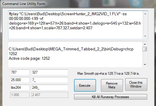

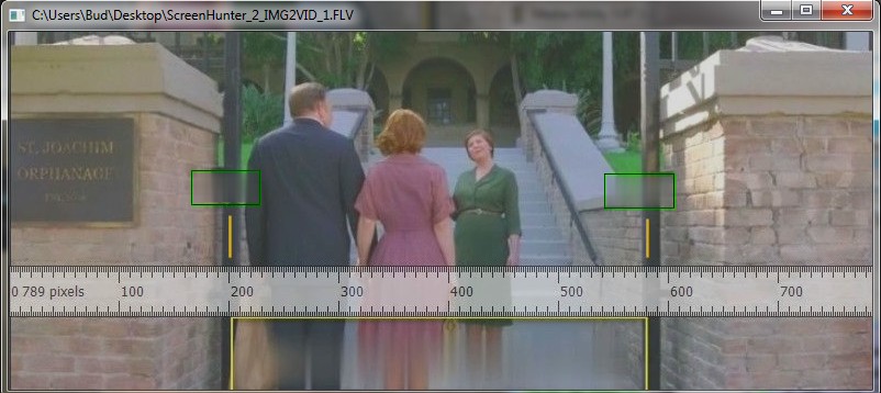

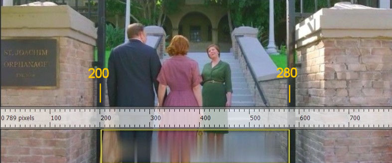

  5. Member Budman1's Avatar
    Jul 2012
    NORTHWEST ILLINOIS, USA
    @natty...

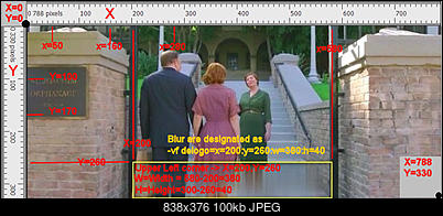

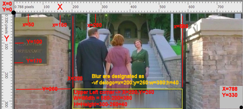

    Hi thank you so much for your help. in that 1st picture I see you have 4 rulers on picture, so basicly I would have to measure 1: left side of screen to left side of subtitle
    2: top of subtitle to top of screen. 3: width of ST , and 4: height
    so is that x y w h so batch file would say in accordance to your picture
    Yes x= number of pixels across and y = number of pixels down. So for a 720x480 video (upper left being 0) would have x=0 to 719 across and 0 to 479 down. W = the width of the box you wish to blur and H = the height of the box you wish to blur:
    You can measure with just one ruler and do the math as shown below. 200 is the X point where you wish to start the blur upper left and it extend for 380 pixels to 580. Then just rotate the ruler and do the same for Y measurement. so X would = 200, W would = 380 and then Y and H would be from vertical measurement.
    ATTN Number 280 should be 580, duh!
    I dont quite understand about that ffplay, would i have to make another bat file for that
    this is a bit confusing for me as like i said earlier I am useless at all this but willing to learn
    btw I did notice when I played my converted movie back where i blurred subtitles. it was just a single line blurred, as it showed a ST above where i blurred so it seems you have to look for the biggest ST like maybe 3 lines
    I download ffmpeg from https://ffmpeg.zeranoe.com/builds/ and in the bin folder there are ffmpeg, ffplay and ffprobe. FFplay allows testing your ffmpeg script without using output filters or filename. That is why
    "c:\Program Files\ffmpeg-3.3.3-win64-static\bin\ffmpeg" -i "%1" -vf delogo=x=425:y=415:w=449:h=120 -c:a aac -b:a 192k "%~dpn1.delogo.mkv"
    becomes
    "ffplay" -i %1 -vf delogo=x=340:y=400:w=230:h=30:show=1
    to view the test blur.
    You would not have to make another bat file but it would making testing easier by just dropping the video on the 'display.bat'
    Regarding the ST... you will have to make your blur box big enough to cover all of the subtitle, including possible multiple lines, or make separate areas in your ffmpeg script:

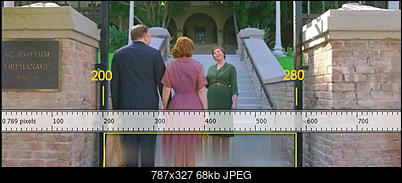

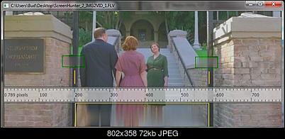

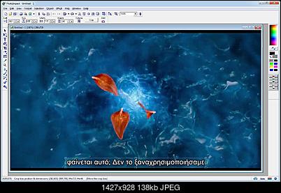

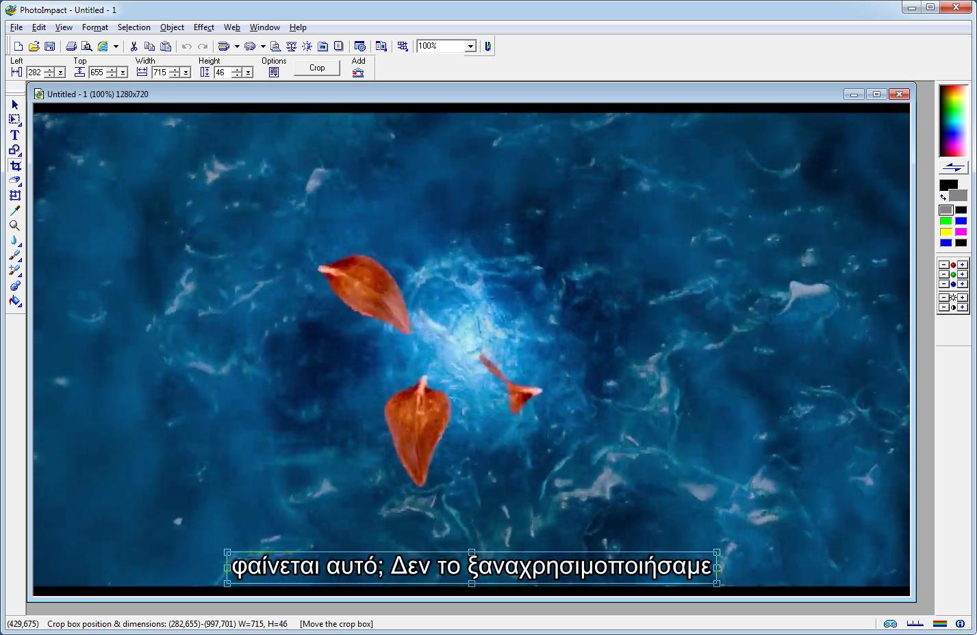

  7. I export a frame of the video to an image editor (an old version of PhotoImpact) that has the ability to mark a rectangle show show the coordinates:
    Note the status bar at the bottom of the image shows the x and y coordinates of the top left and bottom right of the box, and the width/height of the box.

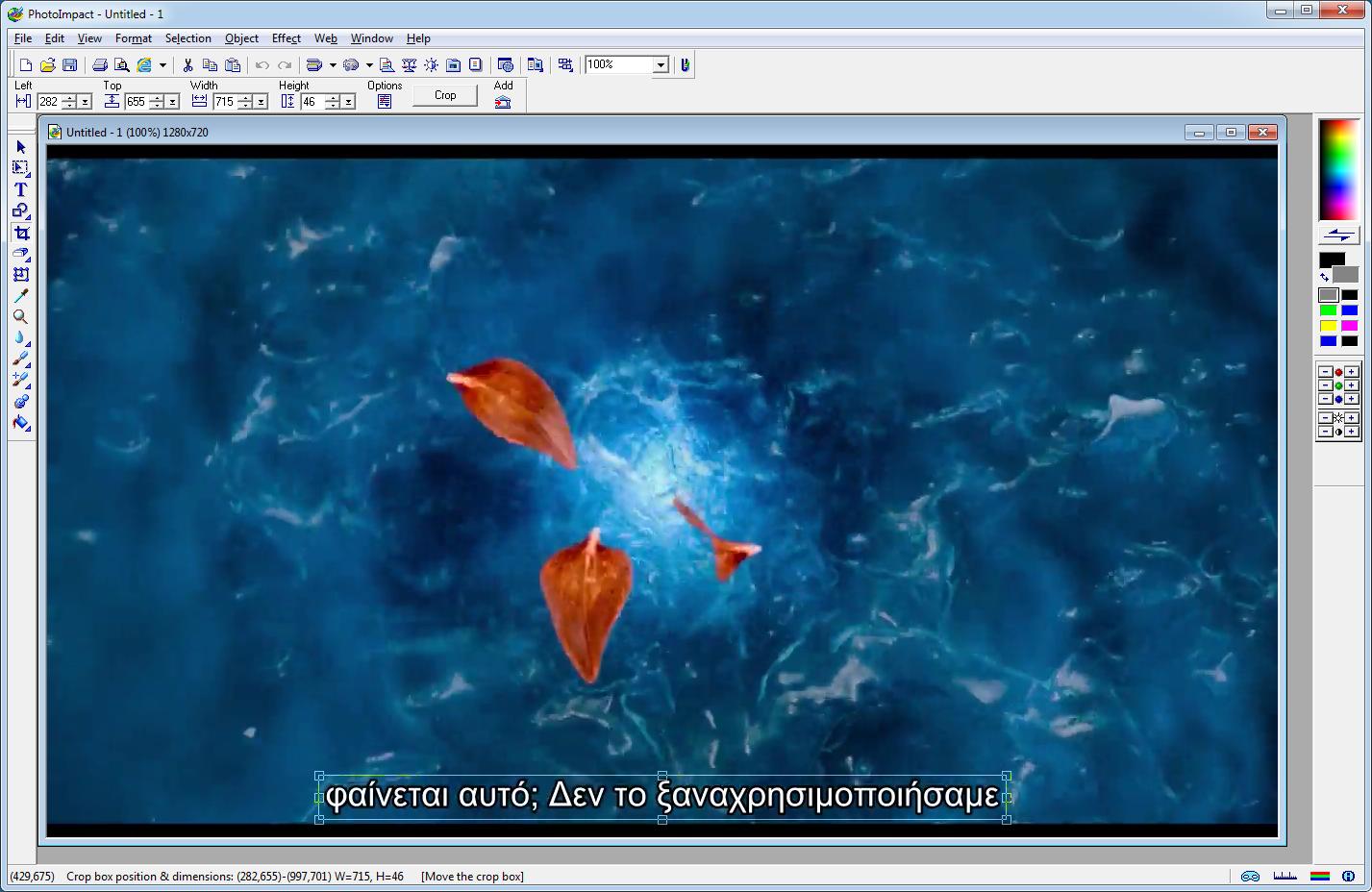

  8. Originally Posted by jagabo View Post
    [Attachment 43400 - Click to enlarge]
    I have actually done this with irfanview put x y w h coordinates in bat file but still get errors so am lost to where I am going wrong. Will try again.

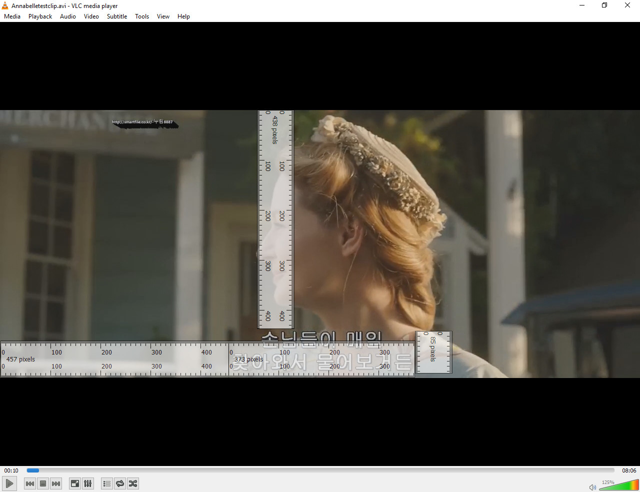

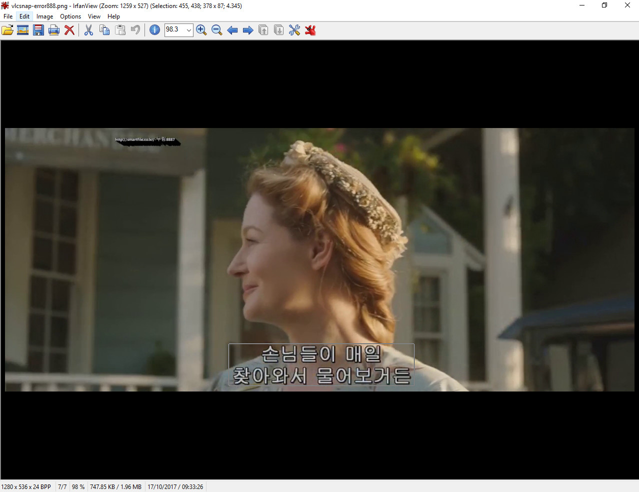

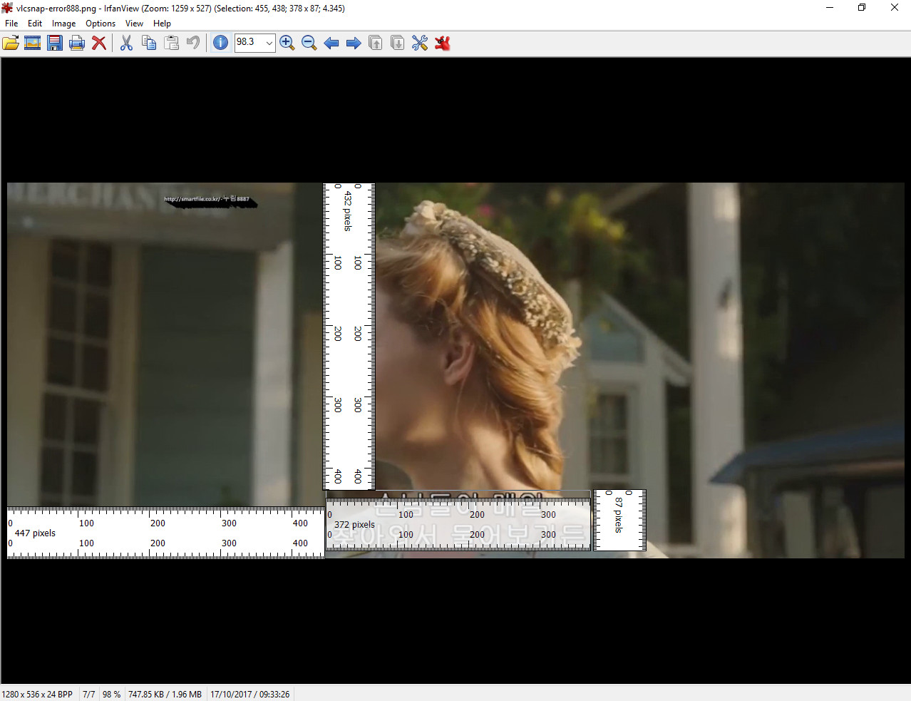

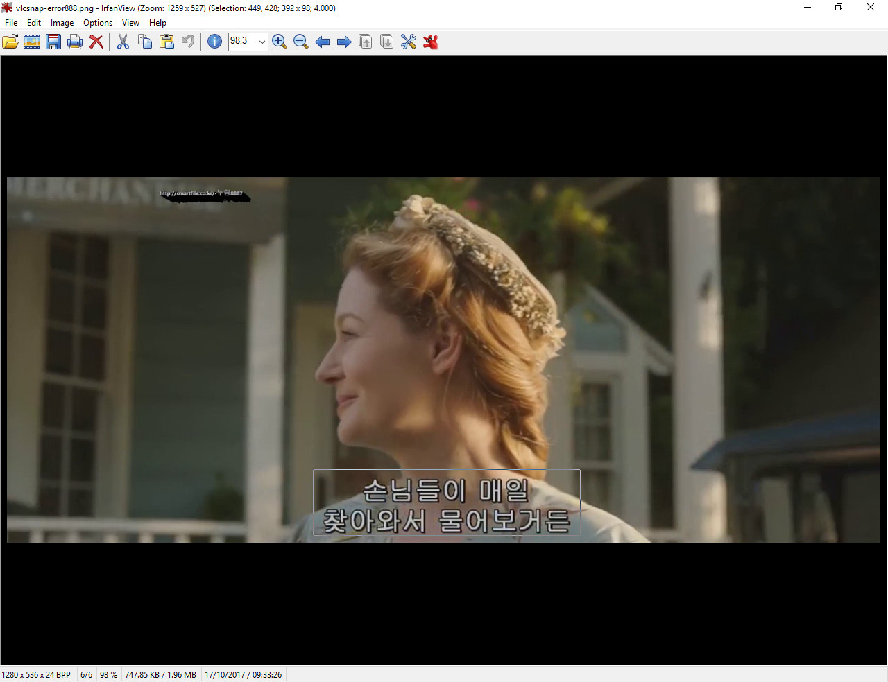

    Hi thanks for this but I still get errors. its doing my head in now. I have made a short clip, which is still uploading to drop box, but taking ages to upload, mind you it is 371MB so probably thats why, so once its uploaded I will place link here. I paused the video using VLC player at 00:10 I used the rulers 4 in all. also used Irfanview to draw a oblong box around subtitle. but as you can see the measurements are completely different to the Rulers, so am baffled by all that. in this snapshot below in the yellow oblong box which is x and y numbers, as i assume its 1st number is x 2nd number is y then w and h
    this is what i did with rulers and also as you can see I made a box around subtitles with Irfanview, but both methods different
    this is box i made around subtitle with Irfanview
    VLC player measurements
    this is the bat file I used
    "c:\Program Files\ffmpeg-3.3.3-win64-static\bin\ffmpeg" -y -i %1 -vf ^
    "delogo=enable='between(n,24,71)'=460:y=434:w=382:h=87, ^
    delogo=enable='between(n,96,143)'=460:y=434:w=382:h=87, ^
    delogo=enable='between(n,168,215)'=460:y=434:w=382:h=87, ^
    " -c:a copy "%~dpn1.delogo.mkv"how1

    here is measurements
    this is bat file
    "delogo=enable='between(n,24,71)':x=449:y=428:w=392:h=98, ^
    delogo=enable='between(n,96,143)':x=449:y=428:w=392:h=98, ^
    delogo=enable='between(n,168,215)':x=449:y=428:w=392:h=98, ^
    " -c:a copy "%~dpn1.delogo.mkv":show1
    pause
