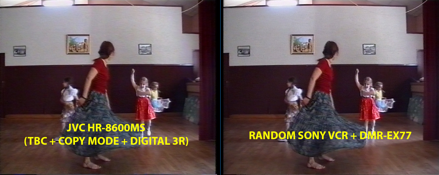

  25. You buy a recent 6 head VHS VCR (Sony, Philips, Samsung, made in 2008, 2009, etc, not before), you plug it to a PANASONIC DMR-Exxx (es10 , es15 , ex-77, ex-87) as a passthrough, and you get the same image quality as a JVC HR-S8600 (or HR-9600). And finally you capture with a standard USB VHS capture card (AverMedia, Elgato) through the analog or S-Video input.
    Here is what you get :
    [Attachment 46887 - Click to enlarge]
    Of course, you need to adjust brightness, contrast, colors, etc...
