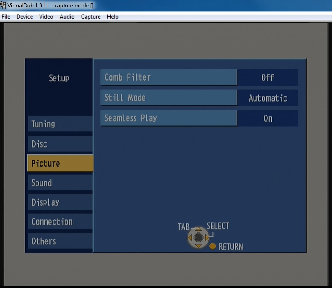

    I feel like the latest "TBC/NR Off" capture is still noise-reduced compared to the DV capture.
    Did you turn off the "AV-in NR" of the DMR-EH65? Pg 37 of the manual. To get the relevant menu, you need to first switch the input to whichever one your VCR is using.
    My Panasonic didn’t came with a physical manual but I download both the user and the service manual. In my manual that information is on page 43. However after selecting AV2 ( I´m using scart plug in svideo as apparently has a more stable signal ?..then the svideo plug ) in the picture menu I have only a comb filter I suppose is the one referred but with only on/off and I have always set it to off .

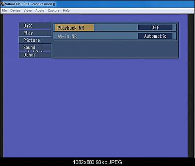

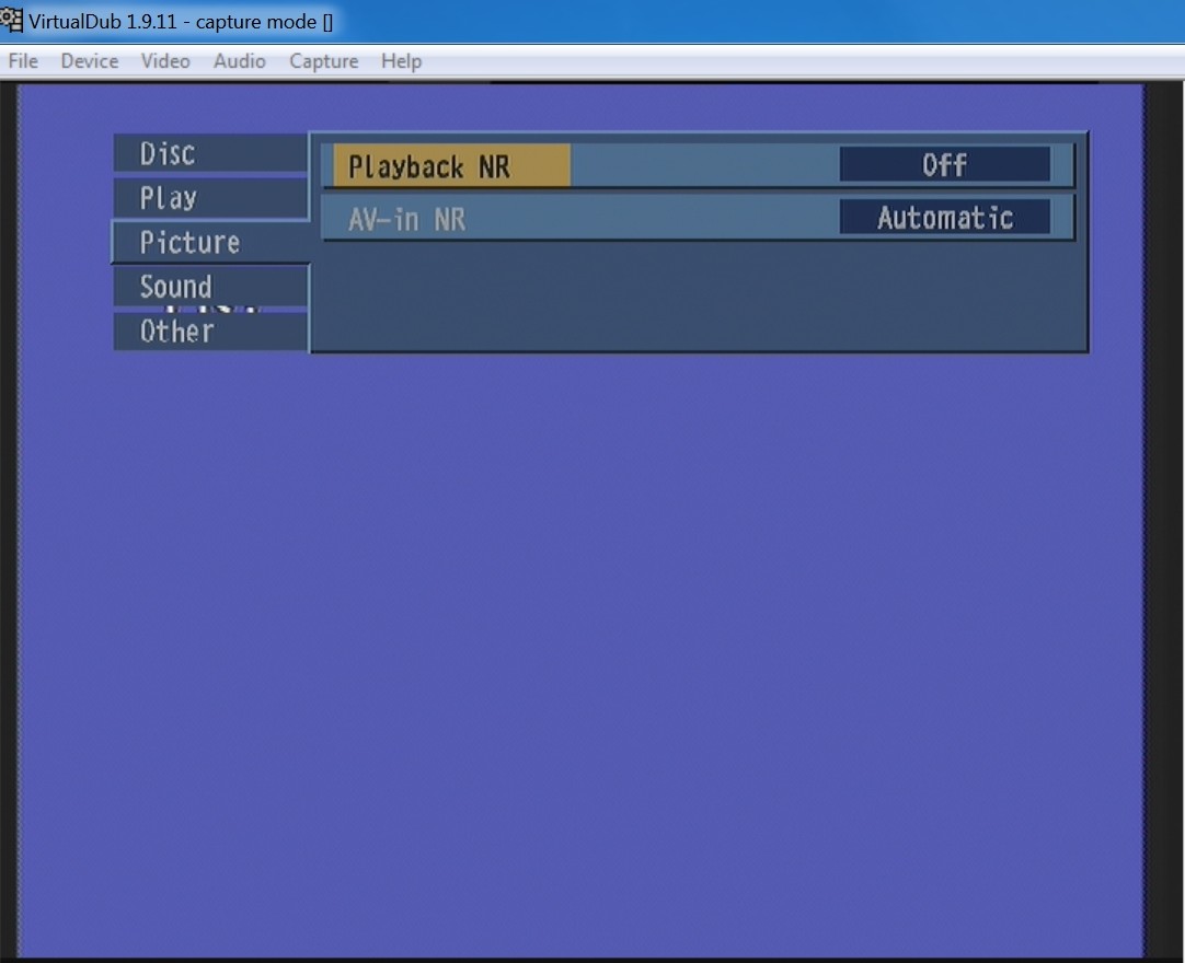

    well, I found the av-in NR it was not available from the main menu and it was in automatic, working in picture input from a video tape . I put it off now but the captures have been made with it in automaticClick image for larger version

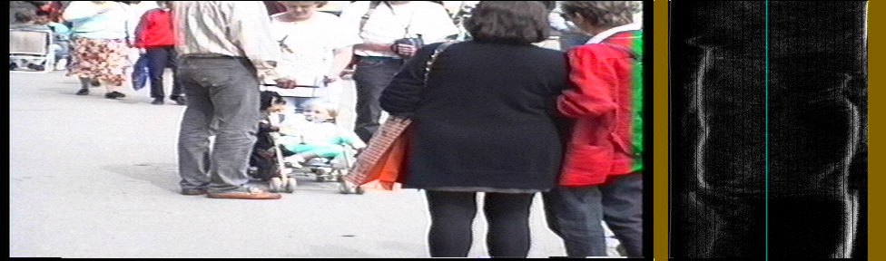

    Here there are the final versions if anyone wants to compare. The workflow we have been discussing and the usual ones .Many thanks to vaporeon 800 and skiller that provided the necessary support and tips in order to fine tune the workflow.
    WF1- D8 -> svideo-> panasonic DMR-EH65->Hdmi->startech usb3HDcap -> virtualdub-> Huufyuv
    digital8 camcorder (TBC on / DNR off)
    Panasonic DvD recorder (AV-IN NR off and Comb filter -off )
    Startech hdmi proc. amp - default values
    WF2 ->D8 -> Svideo -> osprey ->VirtualDub ->Huufyuv

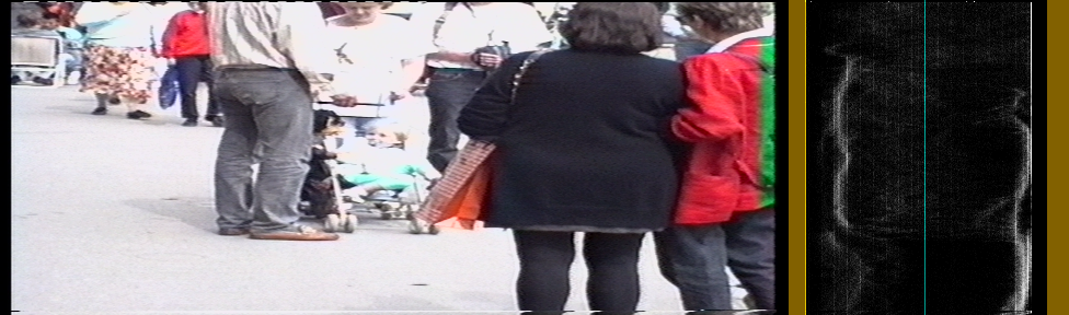

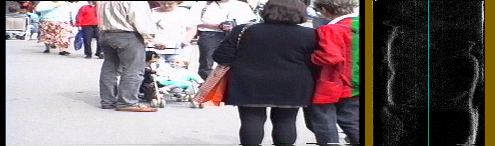

    Comparing WF1 with WF5 it becomes obvious that the Panasonic is superior. Here is why: The LG clips the luma at 240 and there is detail missing because of this. The Panasonic does not seem to be clipping any of the highlights in this capture; the maximum is at about 251, so everything seems covered.
    The histograms of both are smooth and without spikes or holes – nice.
    Looking at the right black border the Panasonic is removing jitter/wiggle well (no surprise) while the LG does not seem to do much in this regard (if anything).
    However it's surprising that there is a difference because afterall the TBC of the D8 was on for both, so the lines should already be straight and "uncorrectable" for anything which follows after. That's weird. Can't explain that. It's as if the D8's TBC wasn't even on.
    Looking at WF4 the lines even seem to be slightly more stable than in WF1, so I'd say if the D8 TBC does do something, it's actually making things ever so slightly worse.
    Conclusion: The LG is totally outperformed by the Panasonic. D8 TBC should be off.

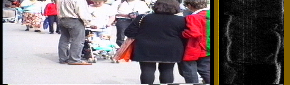

  21. Formerly 'vaporeon800' Brad's Avatar
    Apr 2001
    Vancouver, Canada
    On WF4, the image is shifted slightly to the right internally in the D8, such that its right-border black masking covers the original analog transition from image to horizontal blanking.
    (On WF1 and WF5, you can see that the head switch skew extends into the blanking just slightly, before it's also cut off by the masking. On WF4, it's just cut off hard at the same point as the rest of the image. It doesn't extend into the border area at all. This is most obvious compared to the DV -- as with the left-border black mask that you noted.)
    For these screenshots I attempted to compensate for shifts, and also did basic ColorYUV tweaks.

    Because of this, the right black border can't be used to compare TBC effectiveness, at least not for samples where the D8 TBC is Off. Consequently, I politely disagree with your conclusion that was formed from this basis:
    Conclusion: [...] D8 TBC should be off.
    I'm also unsure whether the LG is truly worse than the Panasonic in regard to jitter, with these specific samples.
    Each of FLP347's files was made from a different playback of the tape, so it could be that the D8 TBC simply performed worse in the particular playback you're comparing, or noise is confounding the issue.
    The main difference I see comparing WF1 (On) to WF4 (Off) is in levels uniformity, or whatever the real term would be. The top of the image seems accidentally brightened to a small degree in WF1. I found the same thing in my NTSC comparison.
    To be honest, I prefer the DV here...
    Pros:
    + No added D/A/D step = no masking or added noise.
    + The edges appear less ragged and noisy than the S-Video captures -- due to the compression softening things?
    Cons:
    - The odd fields are vertically displaced downward by one scanline, due to Sony's apparent bug. If captured again, the bug may not appear.
    - Mild macroblocking visible when single-stepping through fields at 200%. Not going to pretend I can see this during 50Hz playback.
