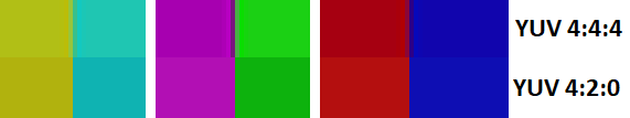

    So, I tried to apply upsampling from YUV 4:2:0 to 4:4:4 and RGB to a CCTV footage using FFmpeg. I also applied the same thing to belle-nuit test chart.
    Originally Posted by sneaker View Post
    You will not increase quality at all.
    You're right. I couldn't see any change in the CCTV footage, while from belle-nuit test chart I got something like this:
Name:	ori-u444-colour shift.png
    Name:  ori-u444-loss detail.png
    I don't understand. Why did that happen to the CCTV result?
  15. Pretty much all digital distribution methods use YUV 4:2:0. So your CCTV video (h.264?) is likely already 4:2:0. The damage has already been done. Upscaling to 4:4:4 just resizes the U and V planes (typically with a bilinear or bicubic filter).
    Jul 2017
    Yes, it's h.264. So, the conversion between 4:4:4 to 4:2:0 is irreversible? Is it because the chroma planes don't have enough information to produce the original color?
  17. Converting 4:4:4 to 4:2:0 is a lossy process. You throw away 3/4 of all color information. It's not reversable. How 4:2:0 to 4:4:4 will look depends on the scaling algo (just like upscaling SD to HD .. well, which it basically is). Don't expect any miracles from ffmpeg. Even from the better algos. The reason 4:2:0 is often used is we humans have a hard time noticing it anyways.
