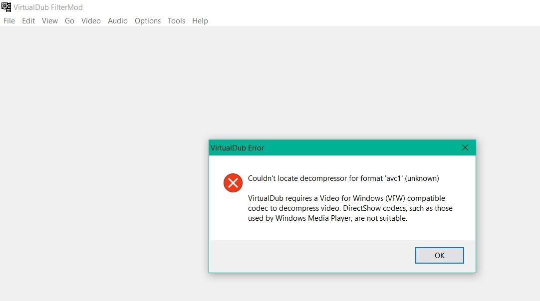

  3. Thank you I'm using Win 10 64 bit. In fact I've tried it on several occasions over the past week or so using MP4, gif, avi, jpg etc. and got the video working but there was no picture. I also tried a home video of surfing but still nothing so was looking around hoping to find something else....
    I guess I must be doing something wrong somewhere ?
  4. Video working but no picture, wtf? Can you show a screenshot?
    Try this: tools->create test video->rgb color cube
    If no picture, go options->preferences->display, try changing options there until you have something.
  5. Thanks, this is as far as I get....

  8. If you try to open jpeg image and you get the same message "bla bla avc1" it means something is way too wrong.
    Sorry I do not understand what you do.
  9. x264vfw

    You cannot get the "same" result. JPEG is not an AVI with 'avc1' video. The error message must be different.
    Furthermore, using the ffmpeg input driver, VDFilterMod should be able to open an MP4 clip containing AVC video without repacking it into AVI, so there is really no need for VfW codecs in this case.

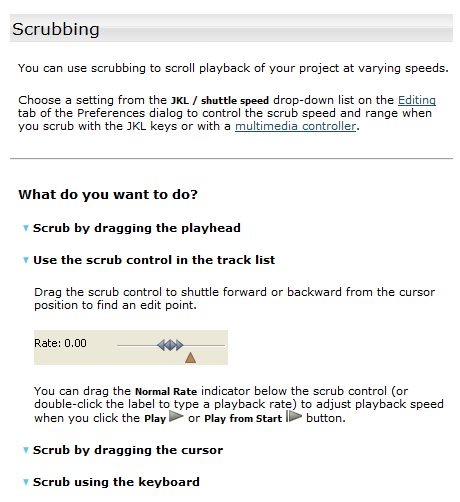

  20. What you're talking about is called "timeline scrubbing." Different editors support it to varying degrees.
    VirtualDub lets you drag the timeline cursor around, but not with audio.
    Vegas Movie Studio is pretty good. You can scrub forward or backward at a steady 33% or whatever.
    [Attachment 42436 - Click to enlarge]

  22. I don't know why VirtualDub FilterMod isn't working properly on your computer. I've run it (both the 32 bit and 64 bit versions) on several Win10 systems with no problems. Did you extract everything in the portable archive? Including the plugins32 and plugins64 folders? Those two folder are critical because they contain the source filters, codecs, etc.
