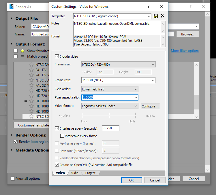

    Also heres a picture of my setting I believe was messed up.
    As you can see Im using "NTSC DV" resolution, 720x480, but only because Im importing video in amarec TV as 720x480. It probably doesnt matter, but NTSC standard is 720x486. Should I be importing in that resolution because Im not using DV for anything? Or would that just make 6 more lines I dont need?
    And should I upload even video8 films (which only have 240 lines) in that same resolution as well? Thanks a lot.

  4. I just realized I turn off the re-sampling setting in Vegas for those clips. Ill upload another set of samples with non-sampling and correct pixel ratio in a few hours.
    The active picture in an analog NTSC signal is 485 lines -- half a line at the top, half a line at the bottom and 484 full scan lines in between. Computers like to in rectangular arrays so the two half lines become full lines, a total of 486. But almost all devices capture only the middle 480 lines now. That's what you want to use.
    The sample in post #3 now has two distinct fields.
    All your samples have been RGB. You should be capturing, saving, ahd uploading YUV 4:2:2 -- usually YUY2 or UYVY or whatever variation your capture device/drivers allow. That is closest to the analog signal and has a little headroom and footroom to help keep brights from blowing out and darks from getting crushed. The clouds in your caps are pegged at RGB=255 so there is probably some detail there that YUV would allow you to recover.

    What do you mean by my video has 2 distinct fields? I assume thats a good thing, but what fields are they? (are they the horizontal lines being interlaced in every other frame?)
    Edit: I just realized when I was rendering my videos that I hadnt configured the coloring to be YUY2 instead of RGB in the advanced options. As I thought, my incompetence with Vegas was the problem. I believe this video sample is properly colored at 4:2:2 now, (with 1.0 pixels and re-sampling disabled too) is that right? Thanks a lot. https://mega.nz/#!ZLIj2ACS!DBW4qF2hq5k83QO0gun6xllPsXeaDMI7FZH8rt9IssY
