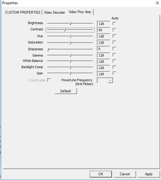

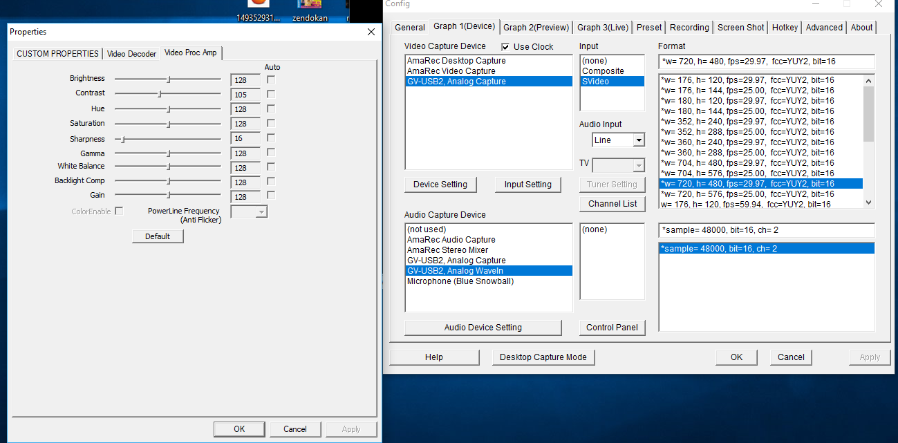

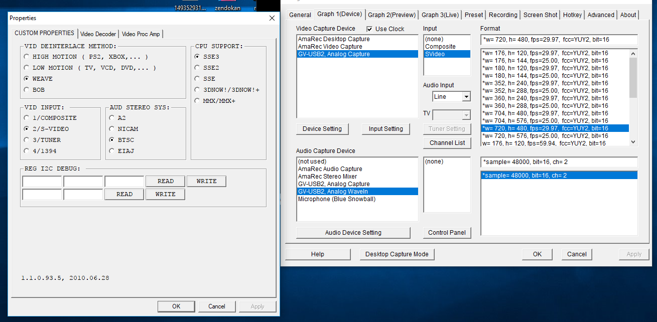

  1. Being a noob whos having some difficulty knowing what settings are best, could the community take a look at the settings Im using? I seem to be capturing video well with my workflow (ccd-trv85 to iodata gv-usb2 to amarec TV) but just wanted to make sure these are optimal for what Im capturing (almost all video8 but a few hi8 casettes as well).
    Should I really use this resolution? 720 x 480? (even though video8 only has 240 lines and hi8 has 400?)
    Should I edit any of my "proc amp" settings in the device settings window?
    Does anything look wrong?
    The sidebar in the first two pictures is my GV-usb2 device settings. Im exporting to Lagarinth codec.
    Thank you!

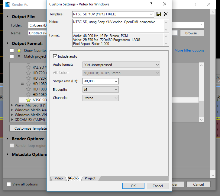

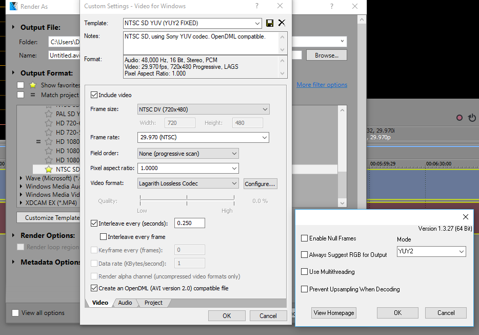

  2. Less importantly, heres my settings for when rendering video in Vegas, with the goal of keeping the video lossless. Im converting mostly video8 and a few hi8 tapes.
    Next to the first image is the video format (Lagarinth) configure window.
    Does this look good? Anything I should change? I know to disable re-sampling, and use YUY2 now. But thats about it lol. Im using 720x480 because thats how many pixels I'm importing it as into Amarectv. Thanks
  3. In your Sony Vegas settings it looks like you have set Vegas to de-interlace as the field settings are set to `progressive/none`
    (assuming the initial Vegas project settings and field setting is set to blend or none progressive etc)
    Do want Vegas to de-interlace your lossless export?

  8. Originally Posted by restore-chappy View Post
    No, I definitely do not want to de-interlace! I know enough to know that that's losing valuable frames. Maybe I'll play with that later but I want lossless now.
    Should it be set to upper field first, or lower field first, if I want to turn off de-interlacing? Thanks

  11. In Vegas you press ALT+ENTER to get the project properties up,There you set the initial settings etc,
    The Par setting is the pixel aspect and yours is set to 1.0000 (Square) in Vegas but should be 0.9091 (NTSC DV)
    I would set upper field first and set the same in the Vegas export window, One thing to bear in mind is
    There is no interlace flag in Lagerith so when playing with a media player you might want to turn on de-interlacing
    for a better playback.

    To answer question #3, PAR = Pixel Aspect Ratio and in your Vegas screenshot the PAR says 1.0000 which means square pixels. This is completely wrong for NTSC video which has anamorphic pixels i.e. not square. They have a PAR of 10/11 or 0.9091 which means they are taller than they are wide. NTSC video has a Sample Aspect Ratio (SAR) of 720x480 but that includes overscan. Technically, the picture is supposed to reside within 704x480, and on old analog TV sets that was all you would see (modern digital TVs typically show the overscan or the full 720x480 SAR). SAR x PAR = DAR, Display Aspect Ratio. Thus, 704/480 x 10/11 = 4:3. Square pixels in a 4:3 DAR correspond to a SAR of 640x480. I have no idea why Vegas is defaulting to square pixels which is why I said Vegas may be interpreting your video incorrectly. I am not a Vegas user.
    I also notice that Vegas does not say what colorspace. This is one of the reasons I like UtVideo because at least in Premiere Pro, I can choose between BT.601 and BT.709. As you can probably see, video is highly technical and someone who doesn't know what they are doing can easily introduce errors in their workflow. This is why I suggested using scopes if Vegas has them. They will help you catch errors much easier than you could possibly do so with your eyes.

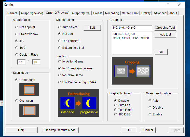

  15. So you guys think my AmaRecTV settings are good? Im saying screw Vegas until I learn how to use it. The importing part is the important stuff.
  16. the AmaRecTV settings seem okay,Why dont you post a short sample of the capture so we can see if everything look okay?

    While youre here, do you know why my GV USB2 device's proc amp settings sharpness is set so low (as seen in original post)? Is that because Im using Standard definition, so it automatically adjusts for my low video quality? These settings were identical in VirtualDub and AmaRecTV (as they should be since its the hardwares settings not the softwares). Should I turn up the sharpness?
    Usually best to have it as low as possible, in the proc amp settings. As it adds sharpness and going higher might add haloing artifacts. You can sharpen later if needed in software. If your source is naturally sharp and clean, then setting sharpness to low won't remove sharpness.

    Ah ok. I had to take a few days off from video editing since my computer got a virus (over 1300 of them to be exact. dont download .exe's off websites you find even off google) and I did a fresh install.
    Im hesitant to change the proc amp settings on my device since it seems to work so well out of the box. I did two captures in AmaRecTV, one with procamp sharpness set to default (16), and one at 0. would you mind looking at them and seeing which you think is better? Thank you
    Procamp sharpness at 16:
    https://mega.nz/#!te4yDbiJ!NxQZdVzsR2lEmUDtsPaRko0i_brpTzwkbhk3C14yhTw
    Procamp sharpness set to 0:
    https://mega.nz/#!sehFEJCK!O20lkZodVk70aup09lILay2Zd7_ls-M6l-T1I793h6I
    I cant tell the difference myself.

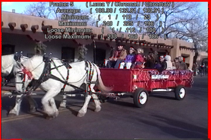

    Think so? Your samples have illegal luma levels. Looks "cool" to typical clooless YooToobers, but anyone else can tell from the blown out brights and clipped hot spots that it's a noob capture by someone who doesn't know how to read or control signal levels.
    It's a subtle difference between the default 16 setting and 0, but the zero shot has less edge noise. At 16 it looks like edge noise is being sharpened. If you sharpen analog tape input during capture, you also sharpen analog tape noise. Sharpeners don't discriminate. But the effect can easily vary by source differences. In time you'll learn to recognize a variety of noisy effects. Some you can avoid, some you have to try to tackle in post. There's no magic formula. What does your capture card's documentation say about the default sharpen value? It is neutral? Or is zero neutral?

    I took a variety of samples messing with the procamp settings. Here is the settings of the best capture I got so far. I turned down contrast by 10 points, and turned off sharpness from default value 16.

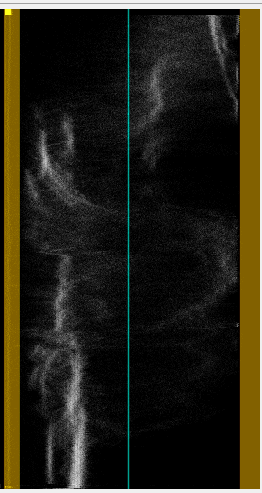

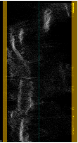

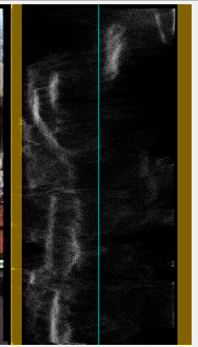

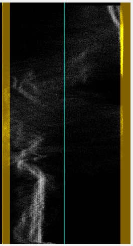

    AVSPmod says there is no more brightness being clipped, however there is some clipping of the low levels. Histogram picture:
    Compared to other samples I just did of messing with the procamp, if I turn down brightness 14 points (while keeping contrast at 105 default), then my lows get clipped significantly more, while I still have clipped high ends (though not as much).
    Putting my contrast at 100 and brightness at default 128 gives me clipped high ends too, as well as lows.
    How should I go about getting the low ends to not be clipped? Should I maybe turn up the brightness while keeping the contrast lower? Or is there another value I should mess with? I want to get this correct so I can start capturing tapes. Thanks a lot.

    Oh, I didnt know that actually. But that makes sense. Is the goal when editing the proc amp to get the values as close to 0-255 without going over at all? Or is a small bit of crushing ok?
    Heres a sample of Brightness at 133, contrast at 94. I think this is the best one yet.
    https://mega.nz/#!gapXTa6a!7lr-iQ3DRb0l07tj5O3Rp0jFclnv5Sfha27S5OM3CcI
    As you can see in the histogram, theres no crushing of brights, and only a tiny line of blacks being crushed. I dont know what that line is, maybe its the extra space on the edges from the conversion of standard resolution to DVD resolution. It shows up on all the samples so I think its insignificant.
    This is kind of unnecessary, but heres a sample of the same scene, but with contrast down 2 points.
    https://mega.nz/#!lXJAFaLL!T38YQiMuhaXzMBmHqu_nmnf6L50_-C61tMyWx4usRRI
    Here you can see that when the contrast is turned down 2 points, the graph moves further from 255.
  30. Better, but I think I'd lower the contrast more. Some of this is somewhat subjective, I think. It might depend on what other scenes look like as in this one you have a bright sky and a white horse. The picture below shows another way to aid in setting up the proc amp. Red shows black levels below 16 and I don't really see where the green is showing white levels above 235. The black bars will either be cropped away or replaced with 'fresh black", I assume, as well as the head switching noise along the bottom.
    It also depends on how the end result is to be viewed as what looks 'normal' on a computer screen might look way too 'bright' on a television. Here's the script used:
    AviSource("amarec(20170802-2135) b133 c94.avi")
    ColorYUV(Analyze=True).Limiter(Show="Luma")
Name:	amarec(20170802-2135) b133 c94.avi.jpg
