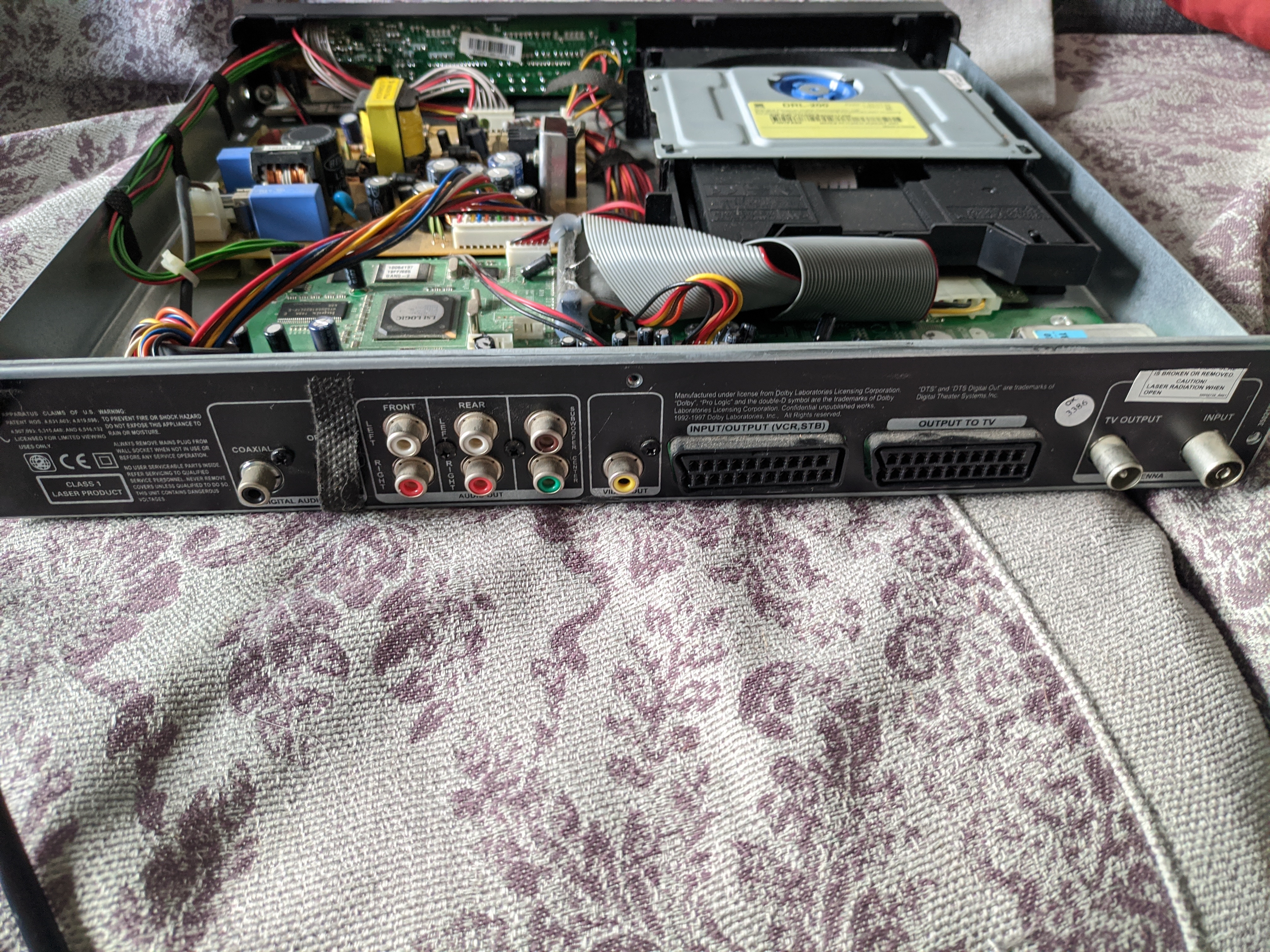

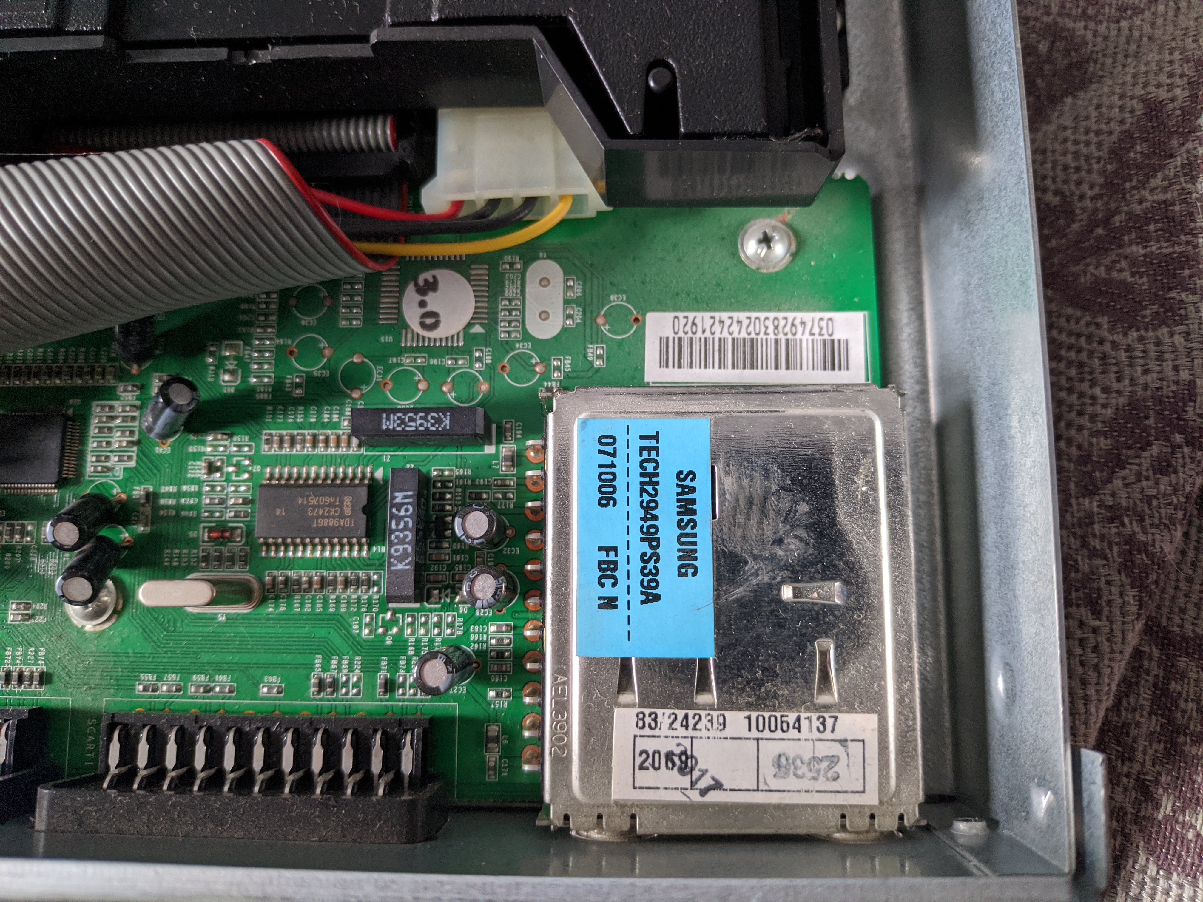

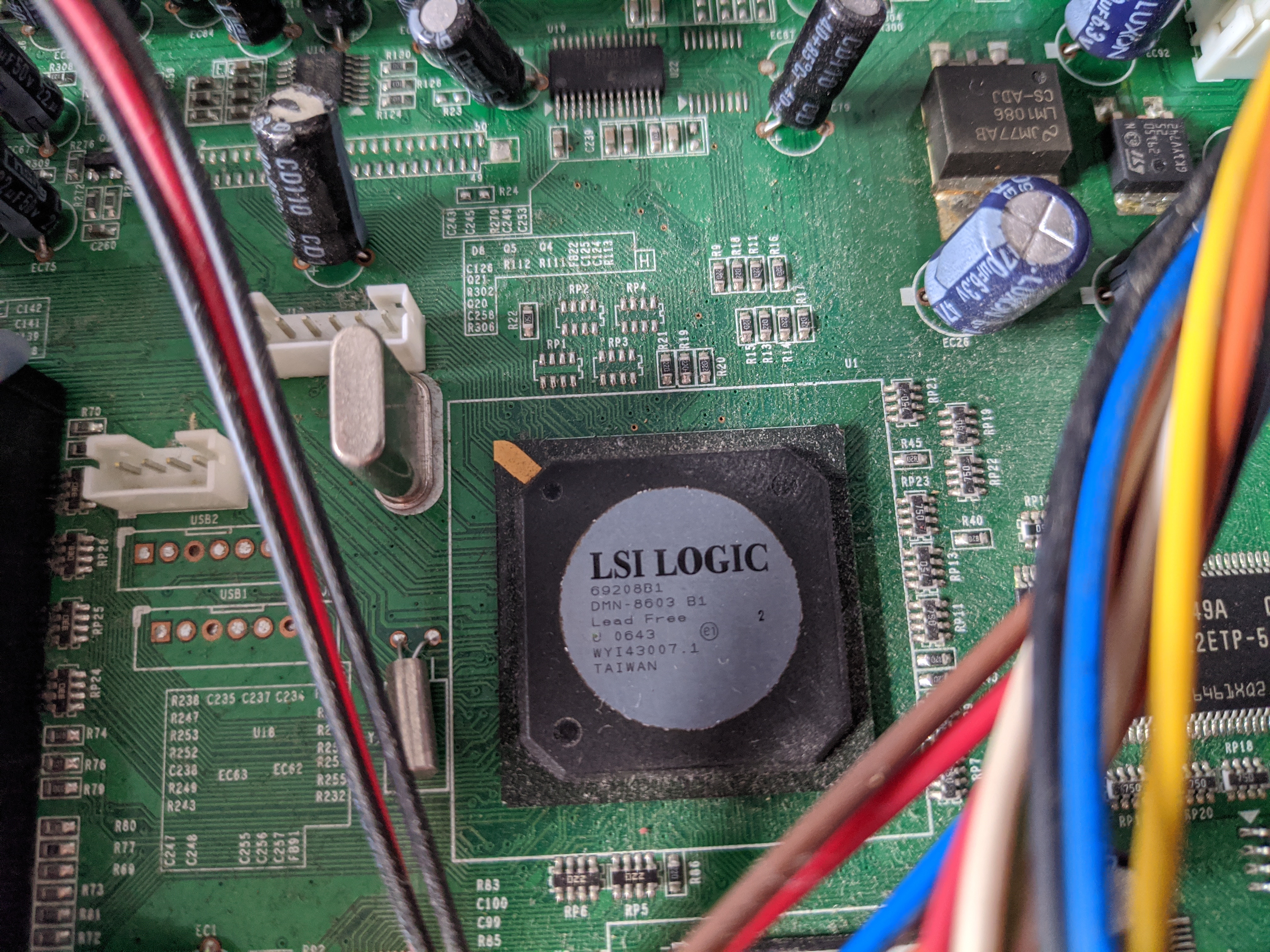

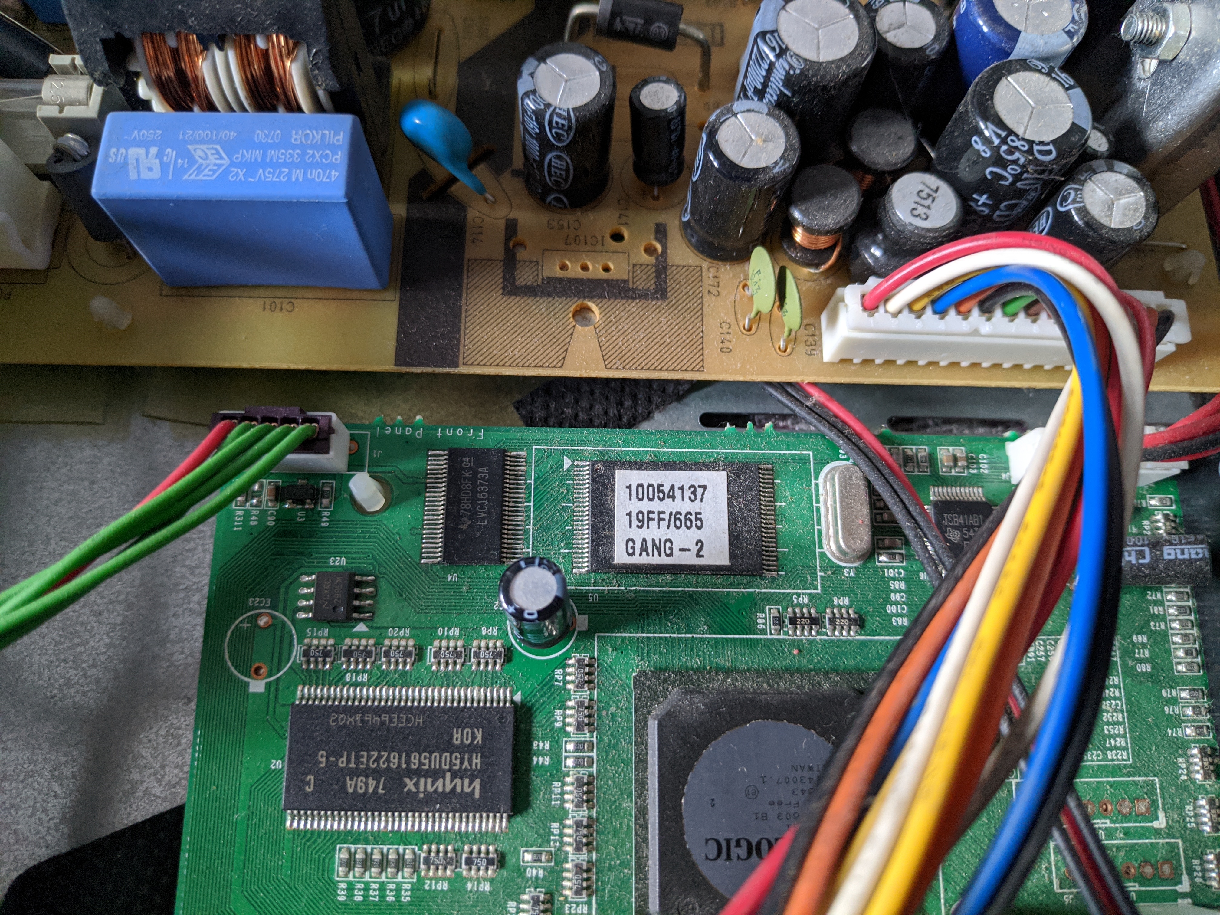

    I also have a working DVD recorder "United DVR7081". This is 100% rebranded . It is in working condition. I opened the metal case and found inside LSI LOGIC IC DMN-8603
    datasheet:
    https://datasheetspdf.com/pdf-file/514544/LSILogic/DMN-8603/1
    I remember reading somewhere that those ICs fixed a lot of VHS signal issues but I never found confirmation that they have line TBC.
    Could someone tell me if this DVD recorder has line TBC?
    no mention of TBC on the datasheet
  9. The LSI Logic DoMiNo chips like the one in that machine doesn't do anything with signal issues - that's up to whatever video decoder chip it's paired with. What they do have is some pretty decent noise reduction as part of the mpeg2 encoding process but that's only relevant if you are recording to dvds (and it seems mainly do stuff at lower bit rates too.) I had a similar generic brand dvd-recorder (though a model with HDD as well that's probably 2-3 years older) using similar ICs and setup and that one seemed prone to loosing image sync and didn't stabilize jitter much so don't think it will help all that much. I have another one sitting around but haven't tested that one. Both had blown capacitors as well (on the first model it was the large 400v one that had completely blown and made a hole in the pcb even.)
    The ability to ingest video and output via firewire directly was disabled in firmware on camcorders sold in the European market due to some tax reason so might be difficult to find.
    Don't know about that exact panasonic though at least other PAL panasonics from the time seem to help with jitter as shown in e.g the sticky panasonic dvd-recorder thread so unless it's radically different to other models it ought to at least help a bit.
