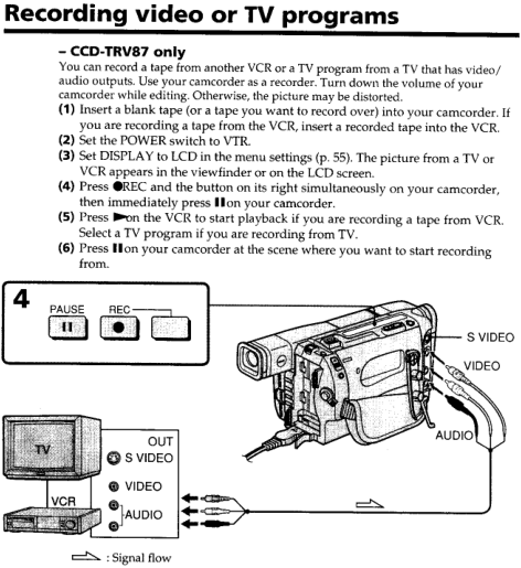

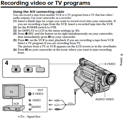

    Originally Posted by siratfus View Post
    Hello Guys, so this list of camcorders with analog passthrough... does that mean Audio/Video IN? Does this mean the camcorder can act like a recording deck? You can input source from computer, TV, dvd player, etc., and record onto the 8mm tape? I know my question may be a little strange. Most people want to digitize their 8mm tapes, but I'm trying to figure out a way to record onto them. Hope someone can chime in.
    You can, but note that Digital8 models can only record in digital mode even if they can play back analog tapes.
    So using these models, you can make a Digital8 recording from AV input to 8mm tape.
    If you want a camcorder that can record analog from AV input, Google "Hi8" "Recording video or TV programs" -Digital8 for results where this phrase appears in Sony manuals.
    Here's an example from the manual for CCD-TRV87, CCD-TRV67/TRV17/TRV37/TRV57. Of those 5 models, only the bolded one supports input.
