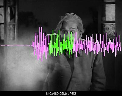

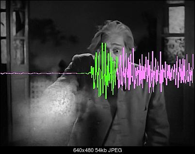

  11. I tried that before, it's time consuming and have to go through many trial and error. It's better if I can visually see the wave forms and the video and then align them together. I'm currently trying Adobe After Effects but it's a complicated software, so I'm watching some tutorials.
  12. Originally Posted by digicube View Post
    I use AviSynth's AudioGraph filter to do just that:
    https://forum.videohelp.com/threads/383349-Cropping-the-top-of-frame-in-Handbrake/page4#post2487503

  13. That looks cool. I'll try that if Adobe fails.
