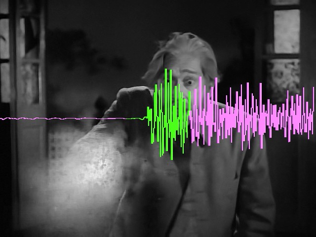

    I do something similar myself. I often play the video in MPC-HC and adjust the delay using the + and - keys in 10ms increments. However, you can also play that script as a video in MPC-HC or other players that can open AviSynth scripts. You could play this just as if it's a video:
    A=AVISource("Movie.avi").
    B=WAVSource("Movie Final.wav")
    B=B.DelayAudio(-0.500)
    AudioDub(A,B)
    But when I really want to zoom in on the delay, I add AviSynth's AudioGraph filter, which shows a waveform superimposed over the video so you can adjust the delay to get pretty close to exact (with the understanding that video frames are roughly 40ms apart).
    A=AVISource("Movie Final.avi").ConvertToYUY2()
    #B=B.DelayAudio(0.08)
    AudioDub(A,B)
    AudioGraph(2)
    Below are three successive frames of a gun being fired (always a good way to get close to the actual delay):
