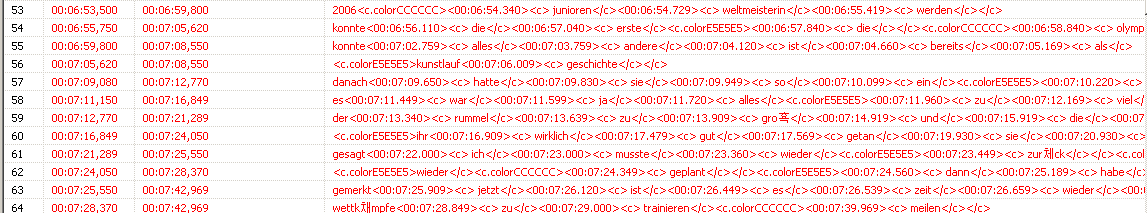

  7. WebVTT can easily and quickly be converted to SRT using this handy little app. It's been a while since I used it and one place I saw said this is how you do it:
    It’s very easy, just download the webvtt files, and then download the application, drag your webvtt files to the application, and everything could be ok.
  8. WebVTT2SRT.zip 's result was a little worse than keepvid, but the error consistency was exactly the same as keepvid
    keepvid can remove <anything> a little better than WebVTT2SRT.zip.
    Subtitle Workshop can remove this form [anything] in the text line
    now how can i ask Subtitle Workshop to remove all <anything>'s?

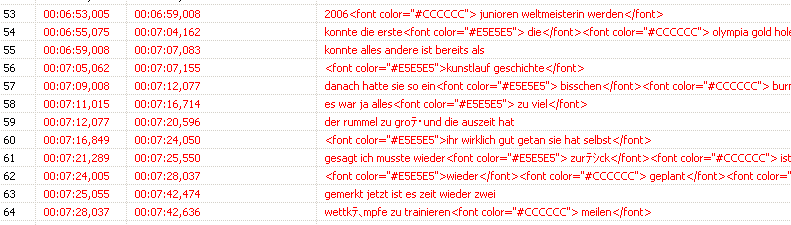

    [Attachment 41980 - Click to enlarge]
  9. the error consistency was the key to get this working
    i replaced < with [<
    i replaced > with >]
    then
    i replaced -->] with -->
    then
    i ran the sub work's F10 that could remove anything inside []
