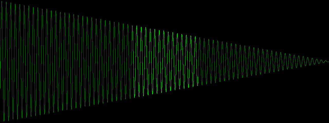

  2. If you want a linear fade call FadeOut0() only once.

  4. Here's an image of audio faded over 5 frames with FadeOut0(5):

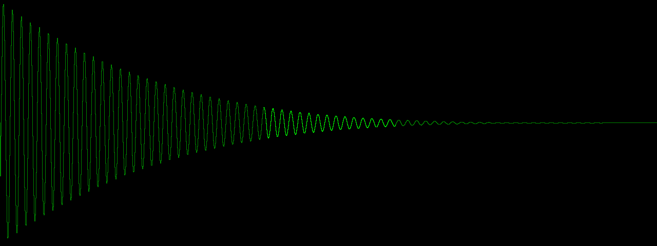

    As you can see it fades linearly from full amplitude at the left, to zero amplitude at the right (before the fade it was full amplitude across the entire image). But after four consecutive FadeOut0(5) you get a much steeper drop at the start:

    Yes, I remember, overlaying several fades produces an effect like a logarithmical fade which is closer to the subjective loudness impression.
    Linear: 100% - 80% - 60% - 40% - 20% - 0%
    Logarithmic: 1 - 1/2 - 1/4 - 1/8 - 1/16 - 1/32
    Multiple linear fading is not the same as logarithmic. But try 2 or 3 instead if 4 were too steep. Until maybe someone creates other non-linear volume change functions for AviSynth (I doubt Animate("AmplifydB") will work well on the audio part, due to video frame granularity).

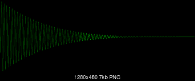

  7. If anybody's interested, I hacked up the four main types of fadeout --
    (I say "hacked" because they are piecewise approximations, not true curves, but they seem to work alright)
    They're mainly for audio, but you can fade video only, audio-only, or both. Fade to black or any other color.
    Script is here (dropbox)
    Linear (the normal Avisynth fade):
    Exponential (fast at first, then a long fadeout):
    Studio (slow, medium, slow):
    Logrithmic (slow, fast):
