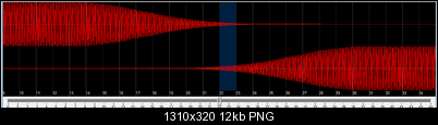

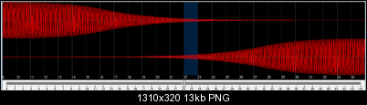

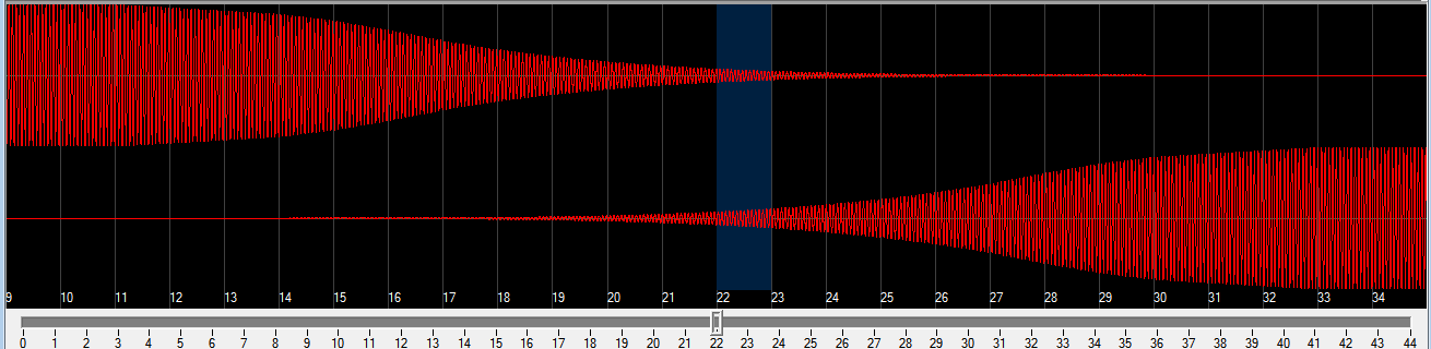

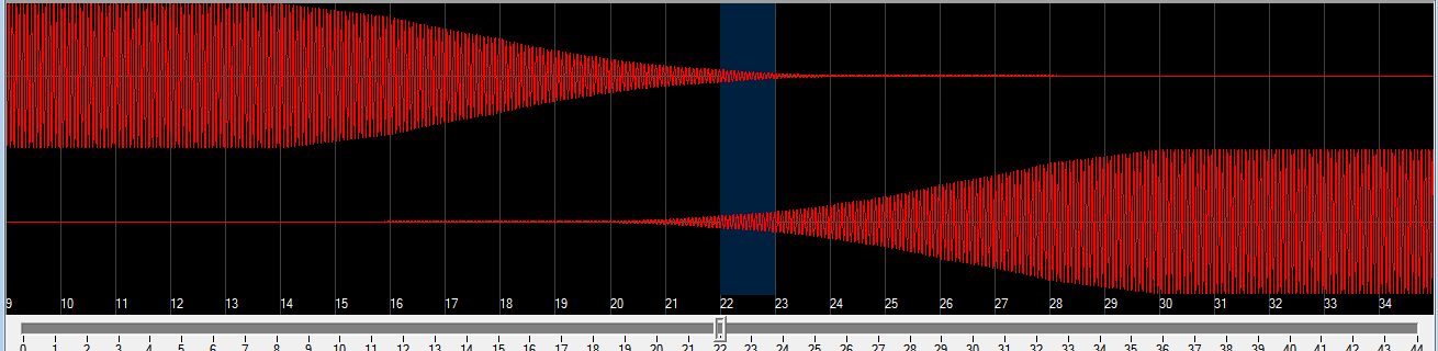

  30. I made the second video an upside down version of the first so I could see the effect on the video as well as the audio.
    What I don't like is the first clip's audio fades to nearly inaudible before the second clip's audio starts to be heard. So the audio is closer to a fade out of the first clip followed by a fade in of the second clip rather than a concurrent fade out and fade in. And to make longer crossfades you have to extend the script. I'm pretty sure you can't have the function call itself recursively.
    You can come pretty close to the same audio output with a simple:
    Dissolve(FadeOut(v1,16).FadeOut(16).FadeOut(16), FadeIn(v2,16).FadeIn(16).FadeIn(16), 22)
    NonLinearDissolve156:
    Dissolve(FadeOut(v1,16).FadeOut(16).FadeOut(16), FadeIn(v2,16).FadeIn(16).FadeIn(16), 22):
    The video looks very different though. With the latter the video fades to nearly black then fades back in with the second clip.
