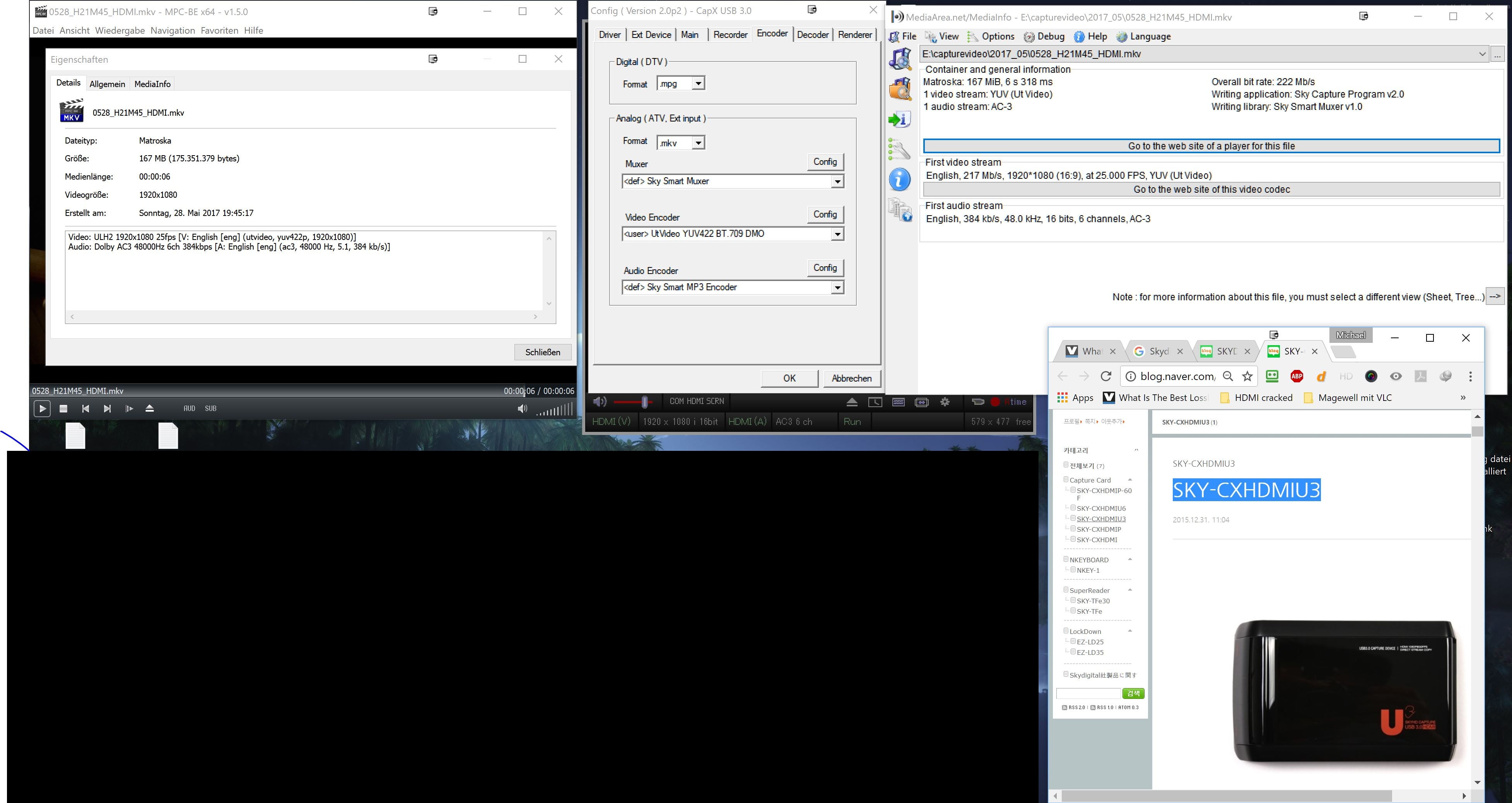

    @end-user
    I made a quick uncompressed video recording with ut video with ac3. see picture, the usb device is also shown.

  11. So it looks like I may have 3 options: a buggy internal Skydigital CaptureX6, an external Skydigital U3.0 and a Blackmagic card that would require an HDMI injector.
    xxxxx, thanks for the awesome screenshot showing uncompressed video + DD AC3 CAN indeed be recorded with the external Skydigital U3.0!

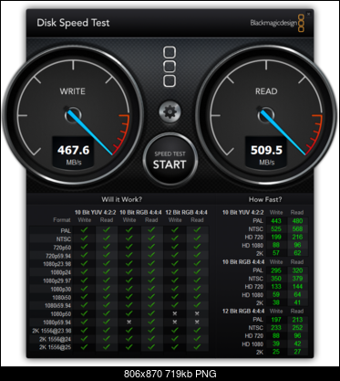

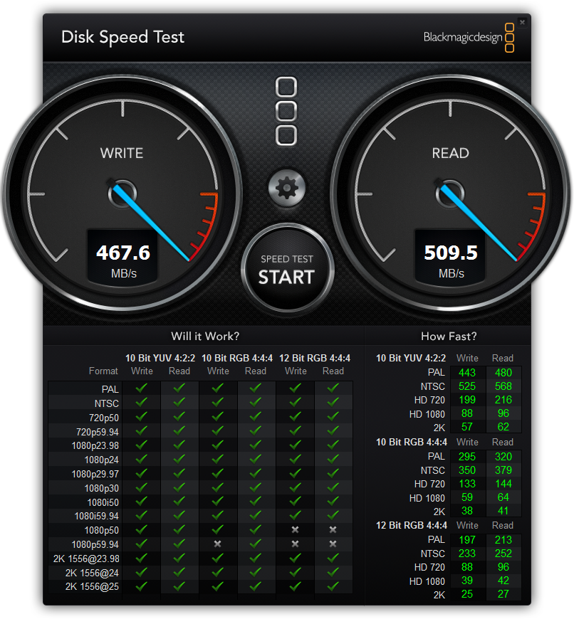

    Originally Posted by end-user View Post
    Would the write speed of 6GB/s on my Seagate 8TB BarraCuda Pro 7200RPM SATA 6Gb/s 256MB Cache 3.5-Inch Internal HDDs in RAID 1 (mirroring) configuration be fast enough to keep up with the stream or would you get a high capacity SSD?
    Blackmagic has a utility built for testing this, though for some reason it only provides values for 10-bit captures. Given the data rates, I guess multiplying the 10-bit YUV 4:2:2 frame counts by 1.33 would tell you the approx FPS you can capture in 8-bit. But this doesn't factor in audio capture.
    4GB test on Samsung 500GB 850 EVO SSD with only 5GB free.
Name:	Samsung 500GB SSD, 4GB test, 5.50GB free.png
    And did you use the Blackmagic IP4K to do it?
    Yes, capturing to SSD.
    Originally Posted by KarMa View Post
    Only really need to write ~25MBytes per second for losslessly compressed 1080p/i video, and maybe 3 times that for completely uncompressed YV12 (4:2:0).
    Capturing LPCM 5.1 with Blackmagic's cards means using their own software, which doesn't support lossless compression or YV12. Sometimes they even force you to capture 10-bit uncompressed when the source is 8-bit.

    this morning I ordered a 1 TB Samsung 850 EVO SSD to use exclusively for capturing/writing these video files.
    Nice.

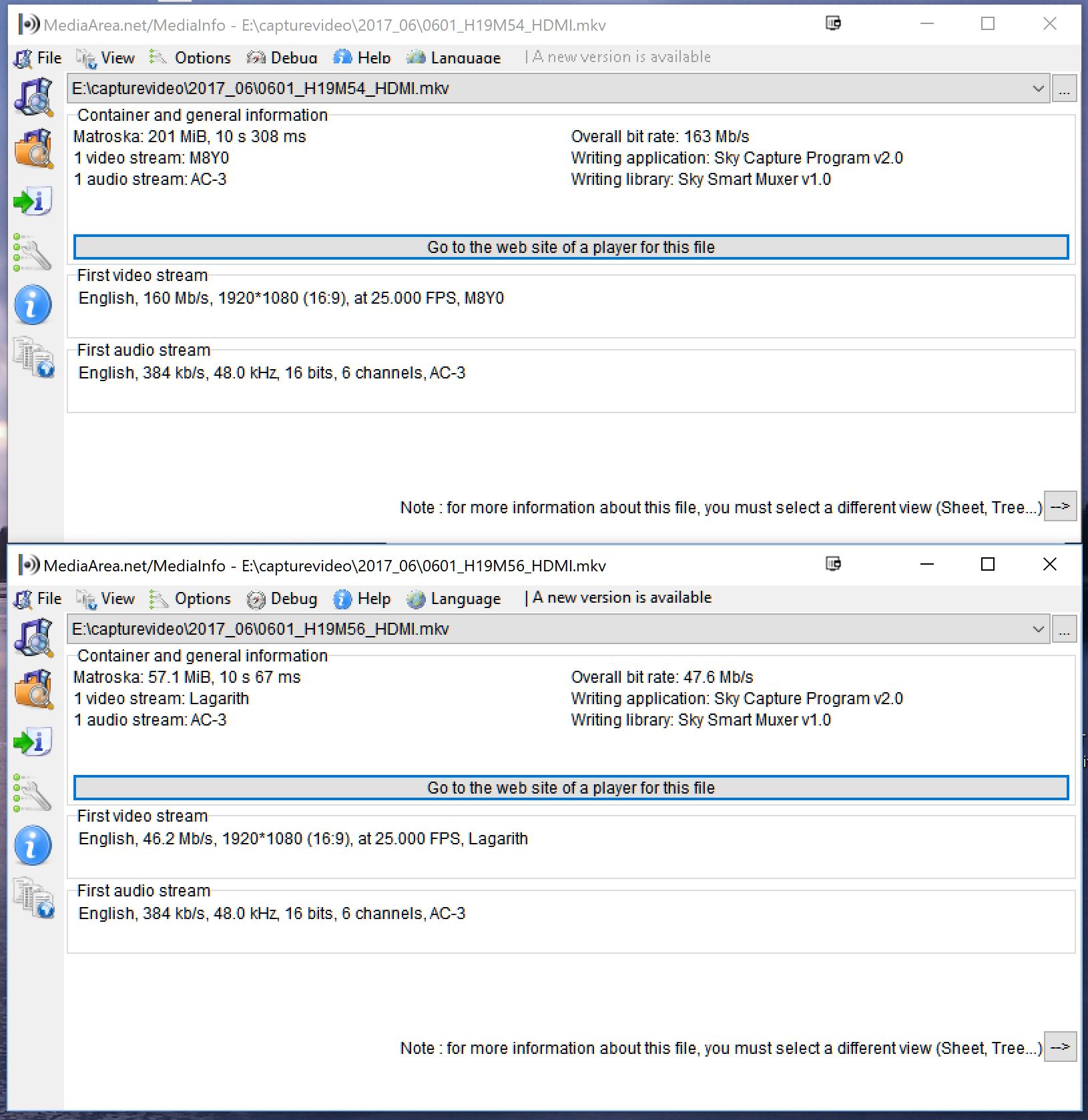

  26. Hi with HD Capture HD CaptureU3.0 Skydigital (USB) you can also use Magic YUV or Lagarith or .... to record uncompressed video with the capture software.
    I only made a few recordings about a year ago for testing purposes and all were fine with lossless video (ut video) and ac3 audio. Everything in sync AFAIK. No problems with capturing A/V.
    I made two recordings for you.
    See pic
    [Attachment 41785 - Click to enlarge]
    The customer service of Skydigital is also great
