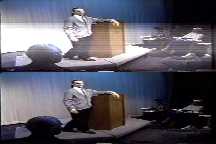

    See these screens http://imgur.com/a/Jj6XC
    Any idea if this is just VHS degradation or some other problem? I've heard of macro-vision causing flashes, but have no idea what those look like. These tapes are from 1994. I have about 100 tapes from similar time frame and I've had this issue on a few. Note this specific set came as 2 tapes and I am only having this issue on one of the tapes and it is throughout the entire 4.5 hr tape - it does vary in frequency. Also I'm capturing via virtualdub - can anyone think of any filters or another method to remove/soften the flashes post capture? Thanks in advance.

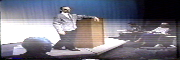

    It's actually a single field, in this case. Oddly, the horizontal bands look regularly-spaced in an alternating pattern.

    Top ~1/3 of field good, middle >1/3 alternating bright with more-bright, bottom ~1/3 brightened.
    If you capture the same segment again, does it appear on the exact same fields? What about playback to a TV?
    You're not going to be able to remove them post-capture unless you can lower the Contrast proc amp control a lot because so much of the frame is clipped to pure white.

  3. Yes, the other field doesn't show the problem. The two fields stacked instead of interleaved:
    [Attachment 41431 - Click to enlarge]
    If the problem happens on different fields each time you capture the tape, and it's not too frequent, you can use a median-of-3 (or 5. etc.) filter to eliminate the bright fields.
    If the problem doesn't happen on multiple consecutive fields, and it's always the same general area that's very bright, you can probably eliminate them with a smart replacement with motion interpolated fields.
    You should upload a video sample to this site.
