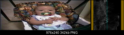

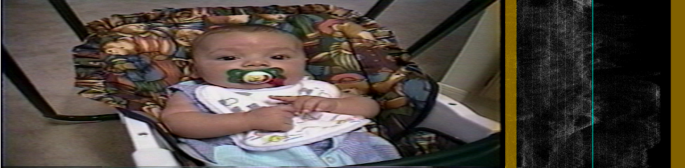

    • The black level on the DCR-TRV38 is too high. (Probably no setting for this; seems to be just what Sony camcorders do when fed a signal containing 7.5 IRE pedestal.)
    • You should lower the Contrast control of the USB-Live2 via Video -> Levels.
    The images below use some really half-assed levels adjustments, so don't take them as an indicator of quality. Mainly posting to show the line distortions. Detail-wise, the Canopus seems to show the pattern most clearly, at the expense of some added blocking compared to the Sony. But in the case of the USB-Live2's detail loss, composite is to blame, so perhaps the same goes for the Sony.
Name:	VideoDoc Hi8 baby interleave-f42 - ADVC100.png
ID:	35669Click image for larger version
Name:	VideoDoc Hi8 baby interleave-f43 - DCR-TRV38.png
ID:	35670Click image for larger version
Name:	VideoDoc Hi8 baby interleave-f44 - USB-Live2.png

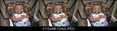

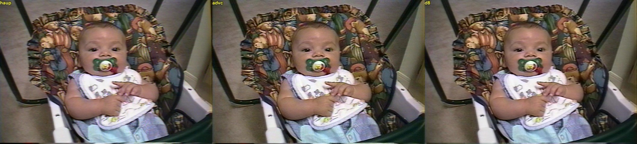

  15. The Happuage cap has dot crawl artifacts. The tape needs to be played on a camcorder with s-video output instead of composite. It also has flagging at the top of the frame and the most horizontal time base jitter. You'll need a line TBC to fix that. It's brights are blown out (>255) but you might be able to fix that with it's proc amp controls.
    The ADVC cap has some herringbone noise.
    The D8 cap might have lost a little detail and noise during capture.
    If you plan on filtering the videos I wouldn't worry about differences in brightness, contrast, and saturation. They can all be adjusted to pretty much the same appearance. Aside from blown out brights in the Hauppauge cap which you might be able to fix with the proc amp controls during capture.
    After some processing:
  16. Originally Posted by jagabo View Post
    [Attachment 35683 - Click to enlarge]
    Thank you very much for your analysis! A couple of questions. What are the "proc amp controls" you make reference to and how do I adjust them? What did you use for the post-processing?

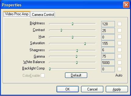

  19. [QUOTE=vaporeon800;2432804]Proc amp = processing amplifier, which is the name of a piece of a equipment used to do basic adjustments of levels and color. Capture devices & software borrowed the term for their own controls that do the same adjustments.
    Is the "proc amp" located in the Hauppauge USB-Live 2 or in my Hi8 camcorder?
  20. Originally Posted by VideoDoc View Post
    It's part of the driver for the USB Live 2. Exactly how you get at it varies depending on the particular device. But you'll find it somewhere in VIrtualDub's menus. They typically look something like:
    It may not have all those settings and some of them may be disabled (unavailable).

  23. Originally Posted by jagabo View Post
    [Attachment 35690 - Click to enlarge]
