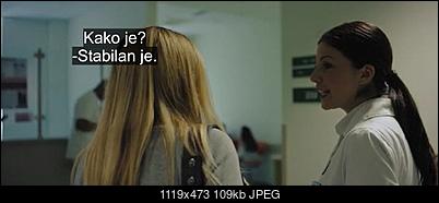

    Hi,
    Thanks for your reply. I tried Override tags you suggested, but at the moment i didn't achieve satisfactory result. With {\pos(X,Y)} I am able to position subtitle on a different location at the screen, but the opaque boxes from the breaked lines are still sticked together. The lines have breaks (\N), but the Override tags should appear at most once in a line. I tried various combinations (with and without \N breaks) but with no results. Anyway, that method require you to write line by line, and that is tedious work which I don't know how to automate.
