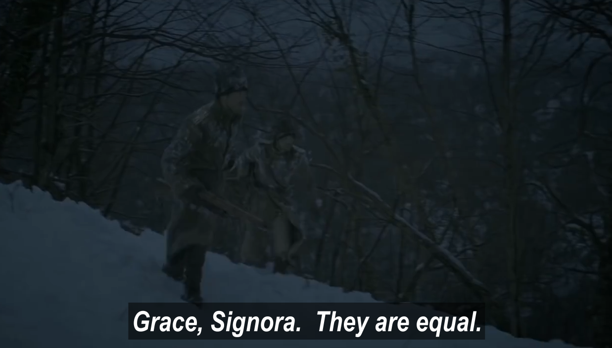

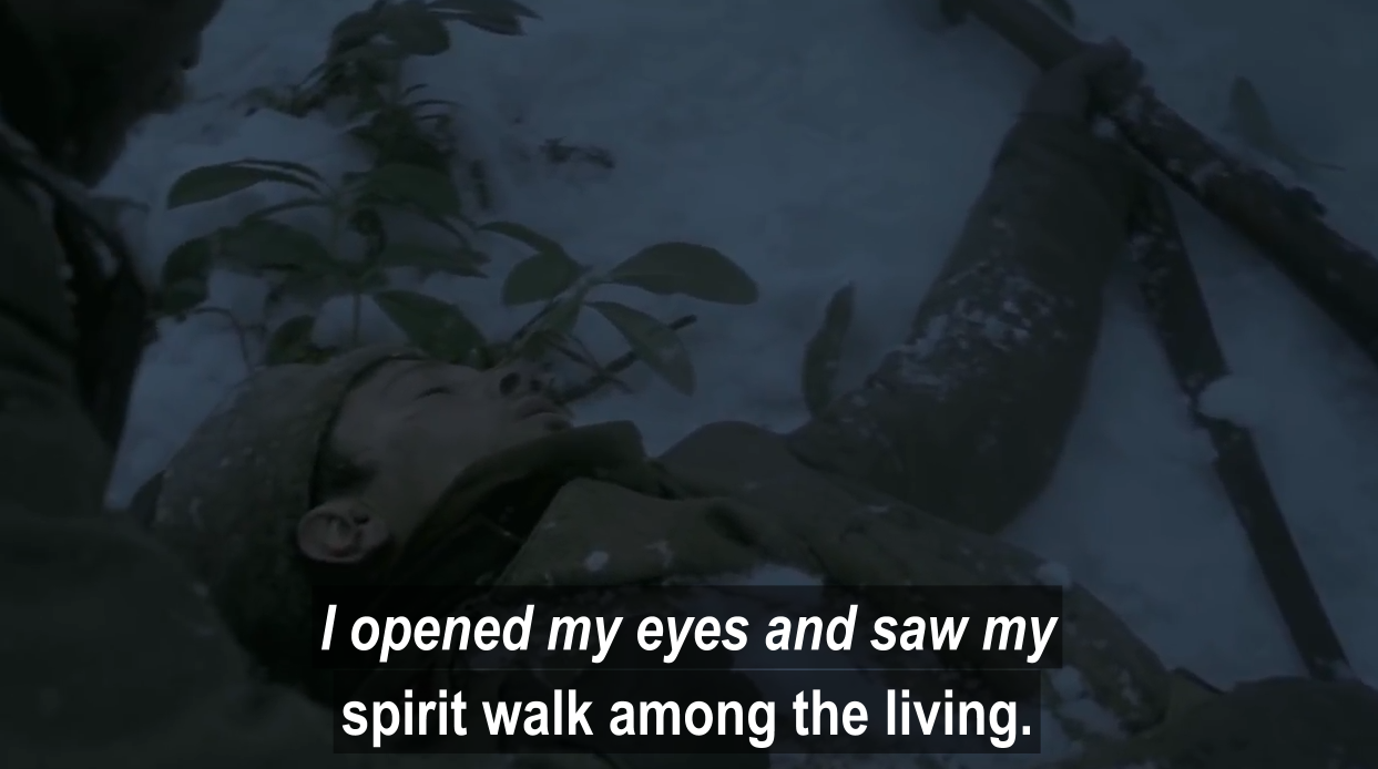

When the subtitle is "italic" and have two or more lines, only the fist line remain "italic".
[Attachment 44887 - Click to enlarge]
[Attachment 44888 - Click to enlarge] -
That's how the /r tag works — it overrides the style of the text that follows it. If you need the style to be preserved for the second line, you need to add the same tags inside the curly brackets after /r. For example: {\i1}This is the first line,\n{\r\i1}and this is the second one.
