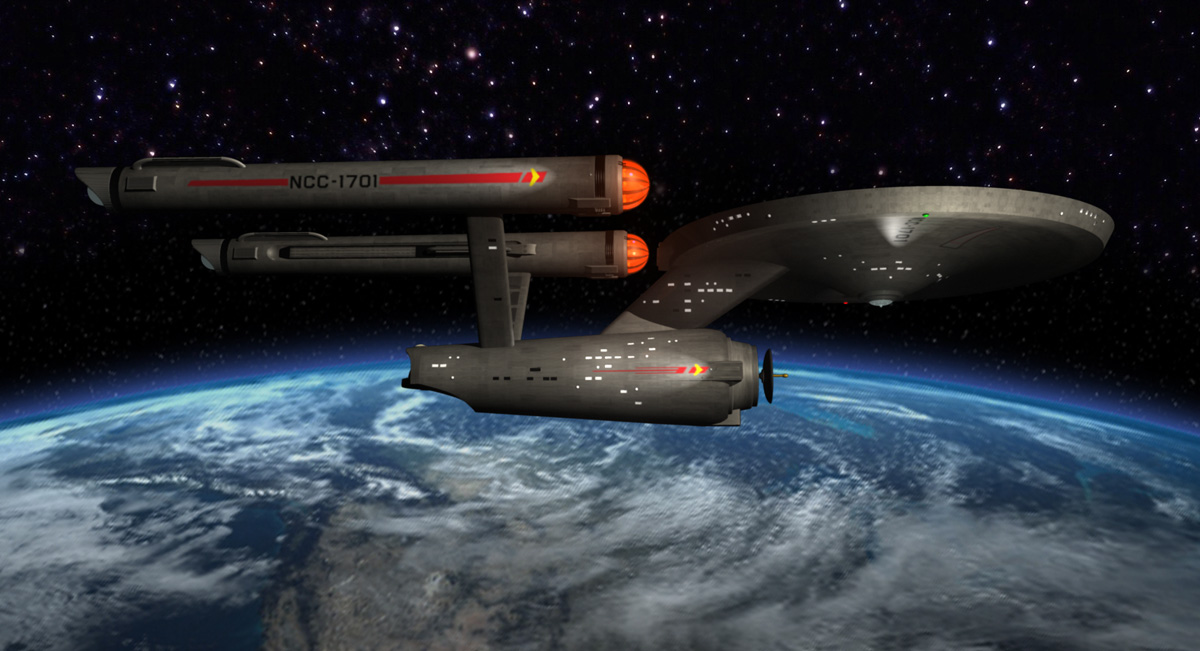

  19. I find exterior space renders difficult. Part of the reason is very few people have actual references. For indoor shots you can just look around in your home and get a reference of how light interacts. But for space, especially around earth, there is supposedly only 1 big light source . It's difficult to light entire hull or various space objects with direct lighting only (You're supposed to only have 1 direct source, and you've got around part of the problem with big hull lights) . Historically, you can see in sci-fi shows, they usually use dark shadows. Half the ship is brightly lit, half very dark. Sure you can have tiny hull lights, tiny distant stars, but they don't really light the scene. Star Wars (ahh.. blashphemy! ) have always typically done it this way . Look at google images for "star wars star destroyer" and you can see the style . But if you examine star trek renders over the years, the early ones looked very "plasticky" , non real and fake. They looked like toys. But also notice that they didn't use shadows convincingly. Fast forward to more modern era and they look way more realistic. The biggest difference is in 1) lights and therefore shadows 2) hull details (both textures and geometry) .
    Part of the reason the render you posted doesn't look quite right, is the directional hull lights are too bright. The primary illumination is supposed to be the sun. Look at the cone of light of those hull lights - they have higher intensity than the sun. Ok, this is more on the "shadow" side, but it still doesn't look right. This render the sun is supposed to be positioned top right , slightly posterior judging by the sharp shadow line in the neck (ie. the saucer disc is casting the shadow). If that were the case , you wouldn't see the lighting on the saucer section towards the viewer on the edge. If you look at left engine , there are light patches that have no light source. There are specular highlights that suggest a foreground light, when there is no indication of such light (ok there might be some ships or other objects in the foreground not depicted, but you can't see that in this image). Even if viewer doesn't know anything about 3d, subconsciously it throws the viewer off. I'm not trying to be mean just trying to give constructive feedback - The lighting and shadows don't look quite right
    For #2 , every surface has extra detailing and isn't perfectly "smooth" . I like the part about your textures not being uniform, but there are repeated elements in the saucer section edge. So it gives the impression the texture is just repeated, not real . Again, even if you don't know anything about 3d, UV's, texture repeats - to average layman, the subconscious will register that as "fake" .
    But other types of exterior space scenes can take on a different "look" . Because we don't have very many authentic references, you can go the route of fantasy or different types of render styles.

  21. Originally Posted by lomitus View Post
    Okies....with all due respect, this comment is the singular reason I didn't say much about my project when I first posted. I don't mind an honest crique on my work AT ALL, however that side-swipes the specific issues/problems.
    You might think so, but you haven't really described what YOU perceive as the problem. Post the Doctor Who sample and what you think is the issue.
    But ask any 3d artist or colorist working in a studio - that critique hits it right on the nose 100% accurately. If you have a photography background you will know the lighting is off. That is what jumps out right away
    I've had others make similar comments about the lights and such and that is NOT the problem I'm trying to address.
    And when everyone says the same thing, it should be a clue...
    This particular scene of mine has been lit a thousand different ways from Sunday...everything from a single light source to 3 point to just about anything else you can imagine...I spent several weeks bouncing different lights around, trying different lights, intensity, combinations, etc...the look I have now (in regards to the lighting) is what I'm actually happy with.
    And that is critical too - you're going for different type of look, a different style. That's perfectly valid too! But you never mentioned that. Anybody who has 3d experience and just looked at the still image would say the same thing I did (and probably what others have said) right off the bat, because it goes against any normal conventions

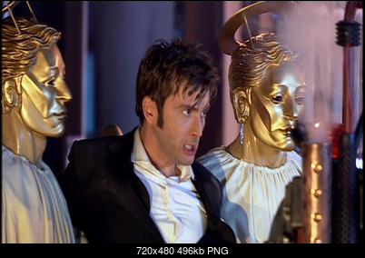

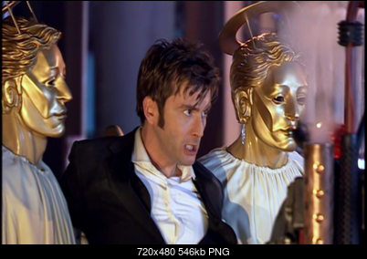

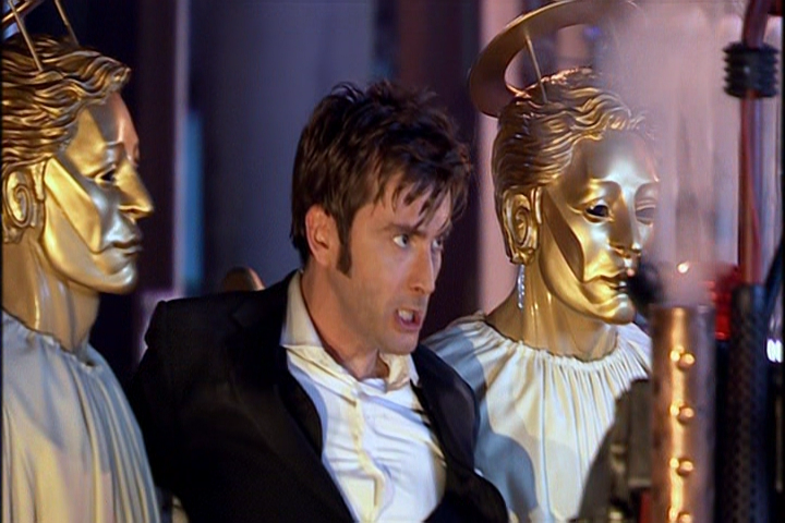

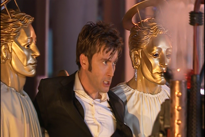

  24. So I went to my neighbor's house , a Doctor Who fan, to see what's up with the DVD "deleted scenes" .
    The attached clips are directly from the NTSC Series 4, disc 1 and meant to be an educational / fair use analysis :
    The "deleted scenes" have undergone a standards conversion from 25i to 59.94i true interlaced content - i.e. it was shot on "video" 50 fields/sec interlaced (series 1-4 were digibeta). Since this is the NTSC DVD, the actual episodes used standard field blending for 25p => 29.97i NTSC (which can be partially "reversed" by avisynth, back to the native 25p), but this is pretty common and standard practice when converted native 25p content such as BBC productions for NTSC releases .
    (I told him a TRUE FAN would have the PAL discs , but anyways)
    Anyways , 2 main differences:
    1) Simple grade. 99% of the spatial "look" (like many dvd's) can be obtained from a simple grade alone
    A few frames were overlapping between the episode and the deleted scenes segment so you can get an almost perfect comparison
    These screenshots are 1:1 non-PAR corrected, the episode used qtgmc+srestore, and the deleted scene used qtgmc for the screenshot
    Episode
    Deleted Scene
    Deleted Scene - graded to look like episode
    2) Cadence. Video vs. "emulated" film cadence. On the "PAL" disc it would be 50 samples /sec for the deleted scenes vs. 25 samples / sec for the episode. The NTSC shows 59.94 vs. 25 (if you srestore and reverse the field blends) . This is the "live video", "soap opera look" vs. the filmic, theatrical look mentioned earlier .
    The reason why you see the cadence difference more on a TV setup is your DVD player deinterlaces double rate - so you get the 59.94p unique pictures /sec on a flat panel . Youtube will only display half of them at 29.97 . You can get 59.94p playback on YT, but only with HD resolutions
