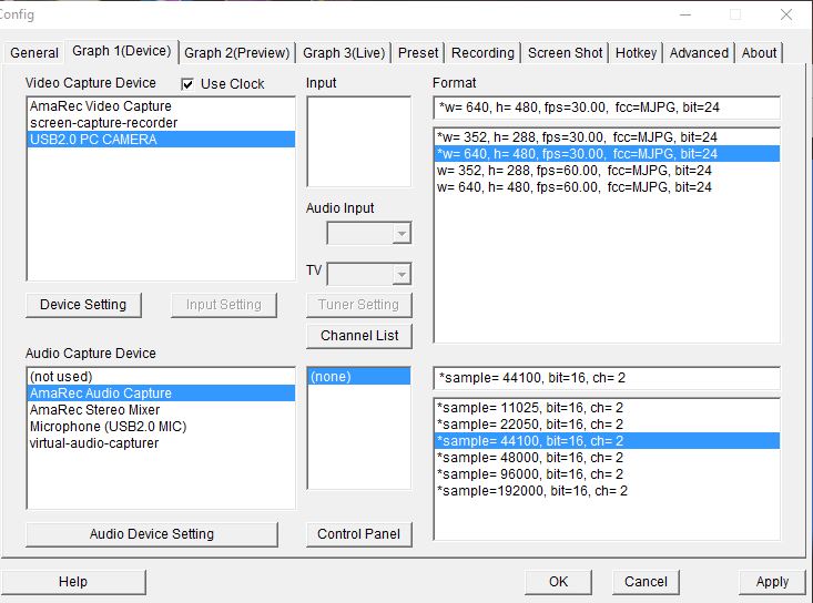

    I have attached a copy of my settings. Yes virtualdub works with dropped frames, I actually found some settings from another forum that worked without dropped frames but that was using a Roxio USB capture & I could not apply the same settings to my generic easiercap because they were using a line in & I have on board video & sound.
    My video capture device is USB 2.0 PC Camera & my sound works the Amerec Audio Capture.

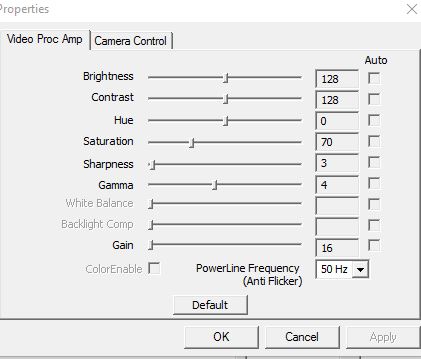

  27. What do you get when you press the Device Settings button?
  28. The fact that you only have four options in the format list and they are all MJPG tells me that AmarecTV either does not recognize your card or the device is faulty. At this point, I would purchase a known card and punt on the cheap Chinese knockoff. Caveat Emptor!

    I have attached the AmarecTV device settings. I tried iuVCR which actually did better than virtual dub. I then tried iuVCS which I believe if the upgrade from iuVCR & that did a worse job.
