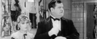

    Source image. Widescreen with black bars top and bottom for 16:9.
    Spline36Resize(1280) # naturally it results in an error if no height is specified.

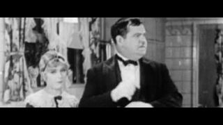

    CropResize(1280) # black is automatically cropped and the output height determined accordingly.

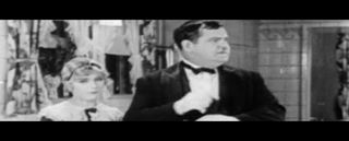

    CropResize(1280,518) # the black is cropped along with any additional picture as required for minimum aspect error (no additional picture cropping was required in this case).
    and the closest I have to come to thinking about it now is this:
    CropResize(OutWidth=1280, OutDAR=16.0/9.0)
    or this:
    CropResize(1280, 16.0/9.0)
