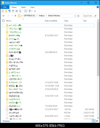

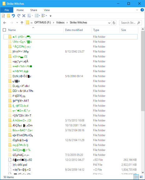

    I powered down my phone, removed the MicroSD card, and plugged it into my laptop to add some videos to be able to watch while I was away. I first deleted some other video files that I no longer needed on it. Then I created a new folder and copied some new videos into it. So far, everything was going as planned... Or so I thought.

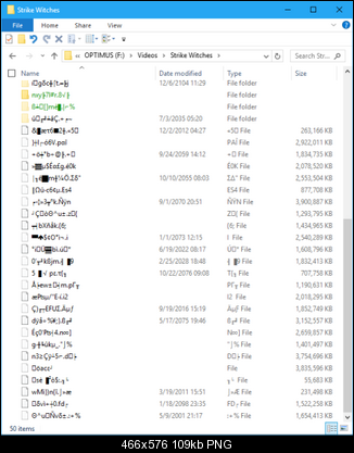

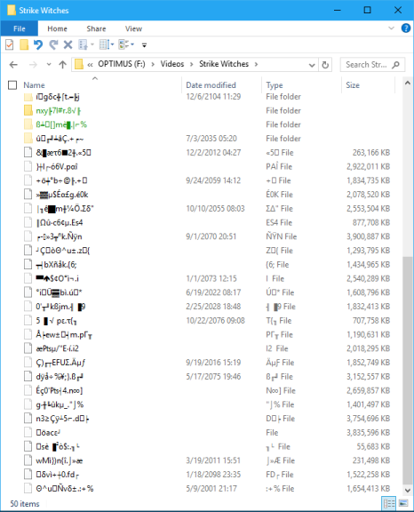

    Now here is where the problem happened... I created another folder to add some more videos, but when I opened it up, I got a terrible surprise. Not only was the folder already populated, but most of the filenames contained illegal characters and some files didn't even have a date (and yet others had dates were several decades in the future), and the total size of the files shown was nearly 45GB - quite impossible on a 32GB card that still showed free space on it.

    So I deleted said folder, ejected the card from the laptop, and inserted it back into the phone. The phone went about analyzing the card, then flashed the word "corrupt" on the screen, and then it showed that there was no card.
    So I again powered down the phone and removed the card, and put it back into the laptop and ran chkdsk /F on it. Curiously enough, it still showed the videos that I had deleted back at the beginning. It also showed the folder full of videos that I had successfully copied. But it did not show the problem folder that I had deleted. Eject... back to phone... still corrupt.

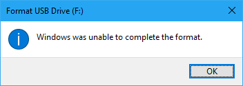

    OK, more aggressive now. Copied all of the data off the card onto my hard drive (and verified), and attempted to format the card. Windows' Format utility says "Windows could not complete the format." So I tried a different FAT32 format utility, which appeared to complete successfully, but when I open up the card in Windows Explorer, all the old files and folders are still there.
    So my question is this: Is there another method I can use to attempt to reformat the card, or do I just have to accept that the card is toast and eat it (no pun intended)?

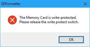

    I reccomend SDFormatter: https://www.sdcard.org/downloads/formatter_4/
    I've used it to format "write-protected" SD cards in the past.

    So how do you get past the write-protection? A MicroSD card doesn't have a write protect switch.

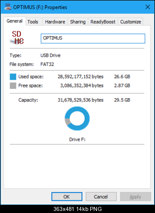

    I have now...

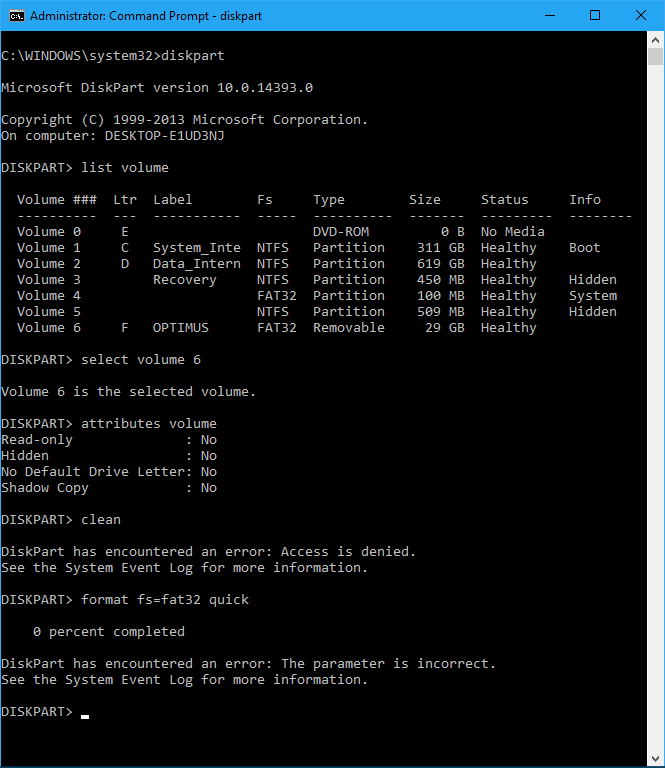

    Had tried those steps already, except for using the EaseUS software, which I quit using long ago because it's nag-ware (it kept popping up notifications telling me I really, really needed to upgrade to the professional version).

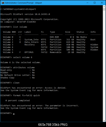

    I have also tried using DiskPart from the command prompt, which tells me that the volume is already not read-only. But then it still gives me errors when I try to do anything. I checked the Event Log as it says, but it doesn't tell me anything.

    I have even gone so far as to enable the built-in Administrator account and trying to do it from there, but even there I get the same errors.
    I am now beyond the point where I firmly believe the likelihood that the card is thoroughly fried is well past 100%, and I've just been killing time here.
    But thanks for all the suggestions anyway. At least you all tried to help.

    The damage seems to have occurred at the moment when I created that last folder - the one with all the weird files. When I examine the drive using TestDisk, it finds discrepancies in the FAT tables, but when I attempt to repair them, it just tells me it can't write to the disk.
