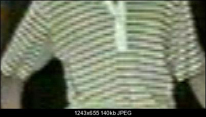

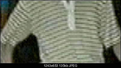

    Here is a still of the quilting through DV (left) and the same image captured years ago when I had access to ProRes/Blackmagic kit:
ID:	40312Click image for larger version
    Source is VHS. You can see the "block boundaries" on the stripes of the shirt are present on DV.
    The frustrating thing is that now I've noticed them I see them on everything I've captured! Noisy footage tends to exaggerate them more it seems.

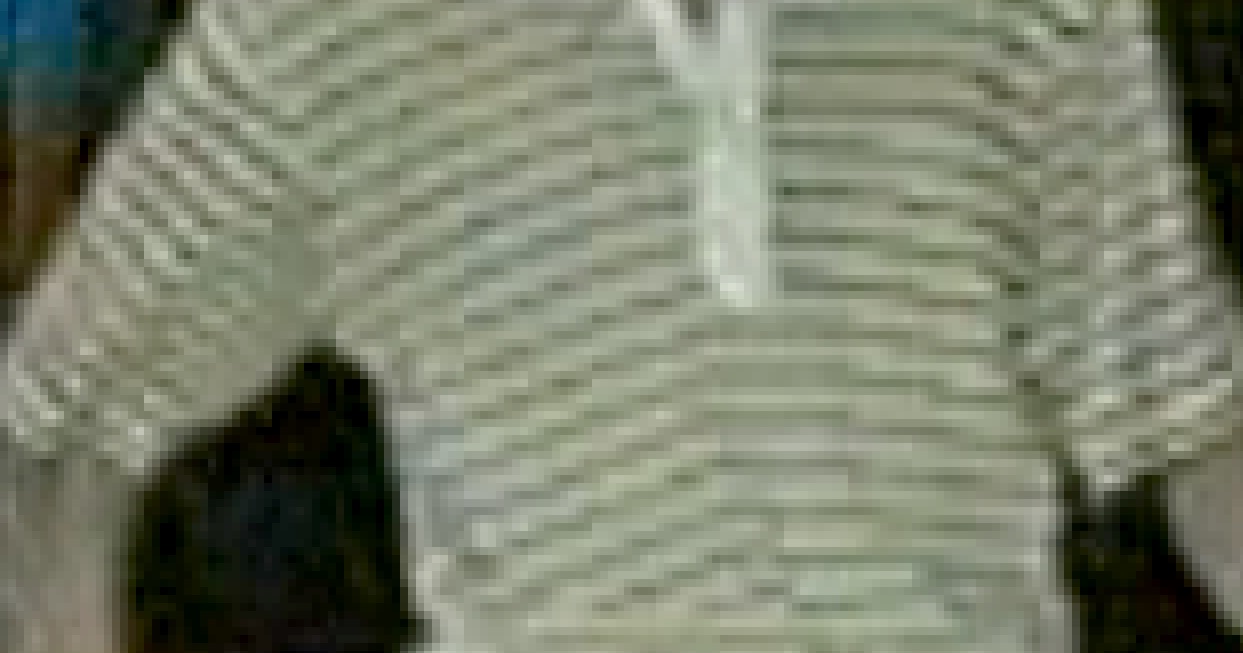

  7. Member vhelp's Avatar
    Mar 2001
    New York
    Image Attached Thumbnails
    This was always a problem with interlace video, and the more you move or faster you panned the camera the worse the temporal-dis-joining of lines become, such as the example in your jpeg photo. The faster you moved/panned the camera on certain objects/scenes, the greater the distance of those objects or portions of a given scene will be between fields, the fields make up a frame. And de-interlacing them will show poorly in scenes like these. But I have noticed in some home cameras that they were slightly better at this. I have an old camera (still do) that does very similar to yours. If the camera were completely still, (not steady in your hand) those lines would be much clearer and uniform. Plus you exaggerated the proof slightly by saving it as a jpeg, and not to mention it is from vhs. I would recommend that you encode this with the highest bitrate you can afford w/out going past the standard, assuming dvd, if you want to reduce the visual noticeable-ness of these artifacts during playback.
