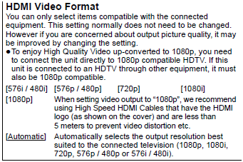

    Yes, indeed. A file captured at 1080p would be huge. If I remember my own tests correctly, I recorded a 5 minute sample at 1080p, and came up with an estimate of close to 8GB/hour. (EDIT: My capture device is standalone, so it doesn't have any settings. It simply records whatever signal is passed through it. And since my BD player outputs 1080p/60fps, that's what it recorded.)
    According to the manual for your player, you can go as low as 480/576 (NTSC/PAL) - either interlaced or progressive. You can experiment whether interlaced or progressive gives you better results. I assume the player defaults to "automatic", and since the capture device can accept 1080, that's what the player would output, so you have to change it in the settings menu.
    You can download the complete user manual for your player here.

    I did a test record at the standard settings at 1080 and the file size was massive! I have plenty of storage space but there is a limit it would be ridiculous if I carried on with these settings.
    [Attachment 41108 - Click to enlarge]
    I would be happy with 8gb an hour I did a test of a few minutes and it was 1.5gb lol
    I will look into the settings on the vcr, now I just need to work out how to set the bitrates and fps optimally

    Still, 8GB/hour is kind of overkill for a VHS capture. That's over 18 Mbps -- almost BluRay bit rate. Unless you're planning on doing a lot of post-process editing, there's not much point in wasting the real estate on that.
    If you're PAL video territory, I would set the VCR to output as 576p as a start, and set the capture at 25fps.
    If you're NTSC, make it 480p & 29.97fps.
    Any bit rate over 2 Mbps should give you good picture quality at that resolution.
