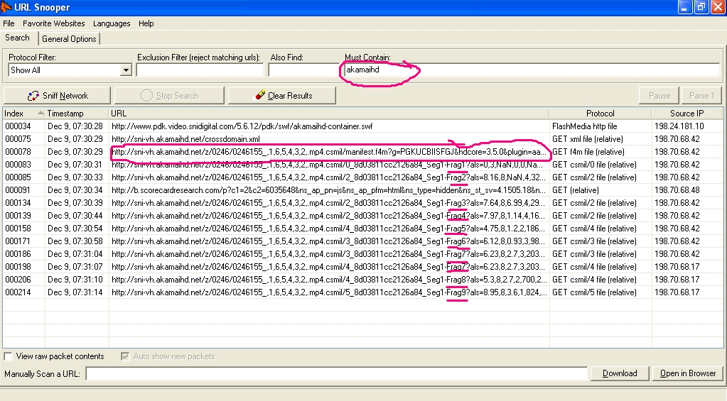

  7. I went to the HGTV Canada website and found a show called "Fixer Upper" Season3 Episode 14.
    http://www.hgtv.com/shows/fixer-upper/episodes/a-home-away-from-home-for-the-holidays
    I played the show for a minute or so with URL Snooper. (see first screenshot)
    I typed in
    akamaihd
    in the Must Contain box.
    You can see in the screenshot you want the entry that does NOT contain the word
    Frag (red circle) which is:
    http://sni-vh.akamaihd.net/z/0246/0246155_,1,6,5,4,3,2,.mp4.csmil/manifest.f4m?g=PGKUCBIISFGJ&hdcore=3.5.0&plugin=aasp-3.5.0.151.81

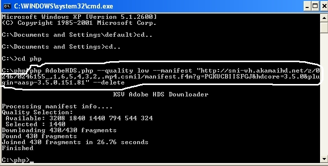

    Right click the http and save to Notepad file and put url in the following template:
    php AdobeHDS.php --quality low --manifest "put url from url snooper here" --delete
    So that becomes:
    php AdobeHDS.php --quality low --manifest "http://sni-vh.akamaihd.net/z/0246/0246155_,1,6,5,4,3,2,.mp4.csmil/manifest.f4m?g=PGKUCBIISFGJ&hdcore=3.5.0&plugin=aasp-3.5.0.151.81" --delete
    Put this into command line. See second screenshot white circle.

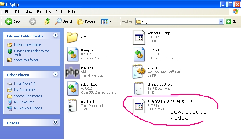

    Video (447MB, 854x480) will be in php (AdobeHDS) folder. See screenshot 3.
