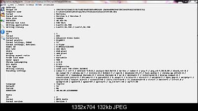

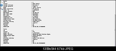

    Unfortunately I can't use GraphEdit but I took 2 pictures of the results (I divided Encoding Settings so it is readable).Click image for larger version
ID:	39423Click image for larger version

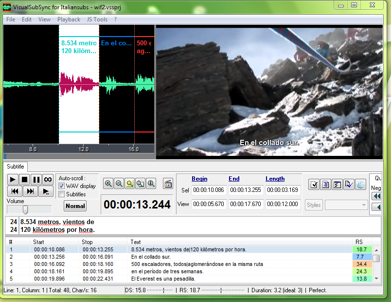

    Argentina

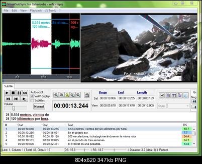

Name:	2016-11-11 21_44_27-Program Manager.png
    In my Windows 7 work video + audio + subtitles of a .mkv. Only with LAVFilters.

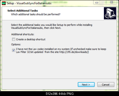

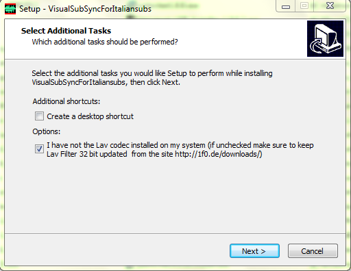

    @LauraPalmer
    1) You on what Windows platform is 7/8/10, 64bit or 32bit?
    2) When you installed VSS, in this window, Options: was marked as in the image?
Name:	2016-11-12 08_17_08-Setup - VisualSubSyncForItaliansubs.png
    If it fails to make it work, since the program uses codecs in 32bit environment, please go to the developer's web to get help:
    https://sourceforge.net/p/vss-itasa/discussion/?source=navbar
  16. Originally Posted by remanyao View Post
    @LauraPalmer
    [Attachment 39436 - Click to enlarge]
    Windows 7 Home Premium SP1 64bit
    PC: Asus Notebook K52F/K62F Series
    Intel Pentium CPU P6200 @2.13 GHz
    Ram: 4 GB
    And yes, that option is marked.

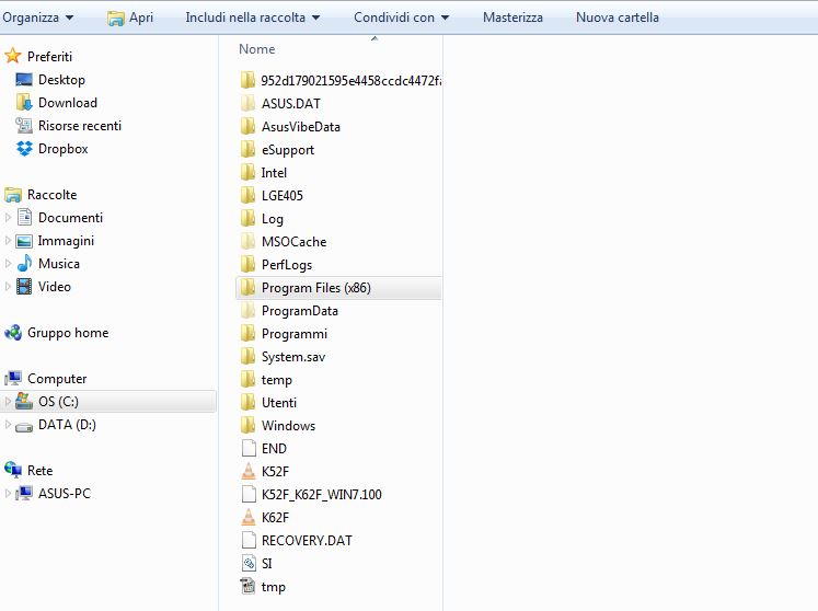

    @LauraPalmer
    1) In C: \, in which folder was VSS installed, in Program Files?
    2) In C: \, you have another folder called Program Files (x86)?
  18. Click image for larger version
    I've only Program Files and Programs (Programmi), but VSS is inside the first one.
    Aug 2013
    Argentina
    Originally Posted by LauraPalmer View Post
    [Attachment 39437 - Click to enlarge]
    I see Program Files (x86), in that folder are installed VSS and the pack of LavFilters?
    Please uninstall VLC also
