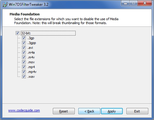

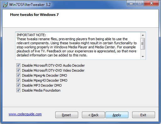

    I had this problem with a very simple .avi (DiVX->DX50 and .mp3 inside) on Windows 7.
    My solution:
    Used Win7DSFilterTweaker 3.2 to disable MS Filter on the last two pages, cf.:
    Hope this helps someone encountering the same problem. As I found on the net, numerous solutions to the same problem exist...
    Good luck!
  8. @ nbarzgar
    Thank you for you post. I was having same problem on my windows 7, and the solution was to follow what you said exactly. Now everything is ok, and Subtitle Workshop can show the mkv files.
    great post.
