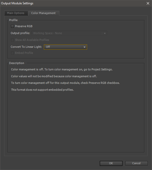

  5. No, in the Color Management tab on Output Module Settings in the Render Queue. This at least solves the blue bar turning green and what I was seeing in my real world encodes where dark parts of the image (a night sky to be exact) had very strange neon green artifacts. So from what I can tell it was the exact same problem.

  6. Originally Posted by SameSelf View Post
    Do you see how output profile is greyed out in your screenshot ? Working space "none" . That implies linear workspace is not active. So the problem (from my perspective) isn't the output module conversion to something; it's everything before that.
    That is because my input files were linear, and there is no need to specify a working space because AE defaults to sRGB when none is chosen. So it doesn't make any difference unfortunately as the green artifact still shows up even when sRGB is explicitly specified and linear is left on. From my testing, the problem is specifically related to how ffmpeg handles linear images from AE. Linear images from Resolve do not have a problem.
